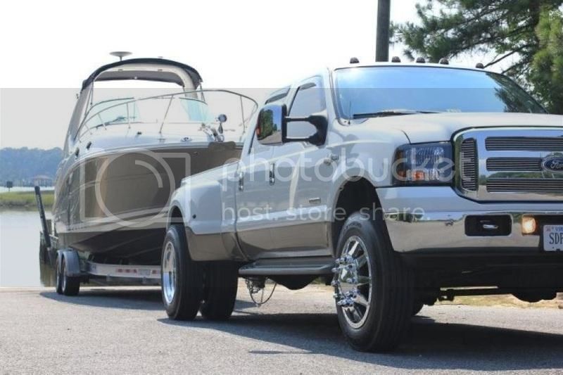

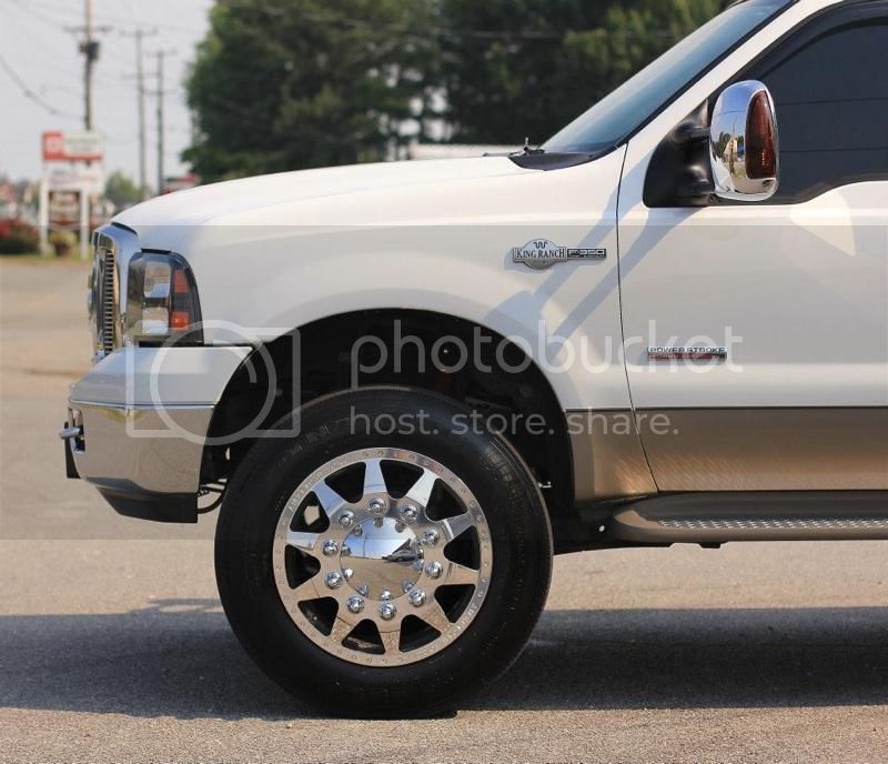

Trav-O
978
TN/KY Line
Customers Ride on just a Leveling Kit

Damn trav-o that's almost identical to mine! I want them so bad. What tread does everyone run? I haul mud trucks so I gotta have something that's got some meat to it so I don't get stuck
