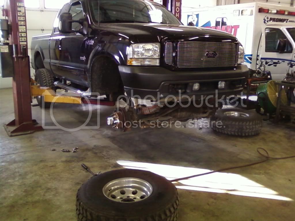

Depending on how high your truck is, (Lifted/leveled/stock) the stock bar will pull the axle off-center. (Left or right, depending on the height.) When I leveled my truck, I added 4" to the front, and the axle was ~1.5" off center. The adjustable bar allowed me to center the axle, so it was in the right spot again.
You can see it here if you look close:http://i752.photobucket.com/albums/...dyear Duratracs and 16x10 Wheels/Tires035.jpg

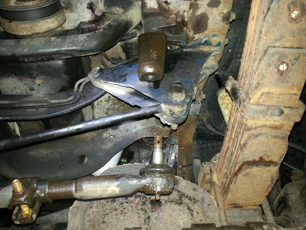

If I were to guess, I'd say that's a drop bracket with a stock bar. In that case, the Zone one may well work for you.
co04cobra
3,003
10
WV
That is for sure a drop track bar bracket. It works but allows for no fine tuning.
