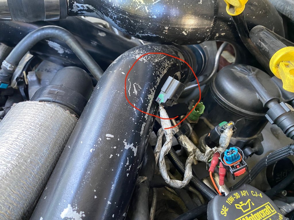

Short back story, just wrapped up doing a 2019 HPFP install and I did a new serpentine belt while in there, then I also installed the S&B silicone body mounts.
The issue I’m having is now on my ez lynk only the coolant temp and transmission temp PID‘s are working correctly. The oil temp will only come up to 123.8°, the boost reads 0, battery volts reads 13.4, and the EGT’s only reads 318°, and the injection pressure reads 4.
truck runs awesome, temp gauges and boost gauges on the dash all work fine and I also tried re-installing the tune and even tried installing a different tune with no change. I know with the work I did I had to move and unplug a lot of stuff but I feel like I got It all plugged back in but something must be unplugged, there has to be a plug that I missed, any idea on what plug(s) might be undone that wouldn’t pick up these PID’s??? I will post a pick in a little while of my phone when I take the truck out to show the PID’s, Any help is greatly appreciated.
