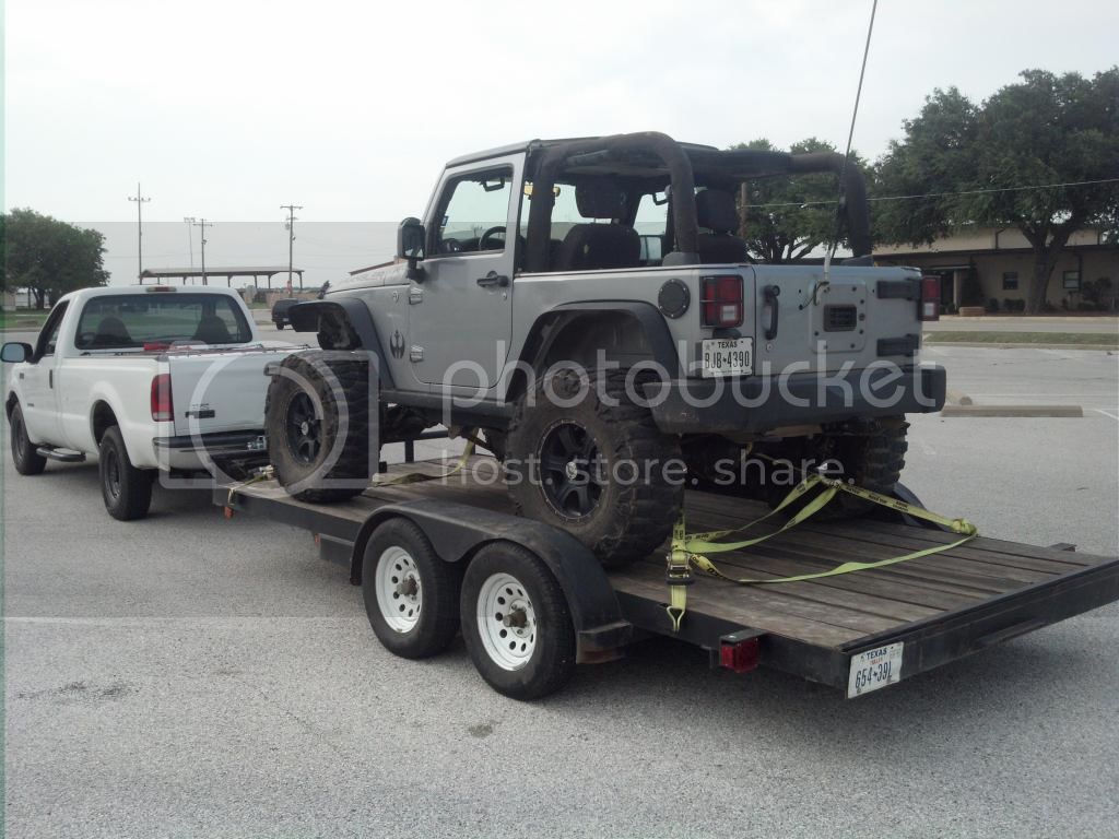

the truck in question is my recently purchased 01 F250 7.3 2wd. 313,000 miles. runs like a champ. 15 mpg towing a 4500lb jeep behind a $3300 truck has been really nice.
