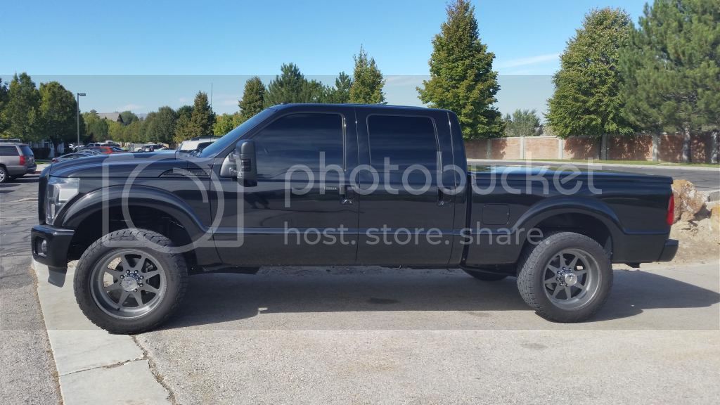

Do you have a straight on shot and a side profile shot? I could post mine like that so we can see the difference..
Love that truck also!
Thanks, it's similar to yours. I would love black like yours. I know I won't keep it clean enough where I live.
It's raining today, didn't have any good true side and front shots in my phone.
