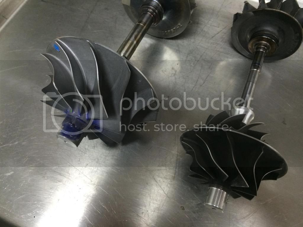

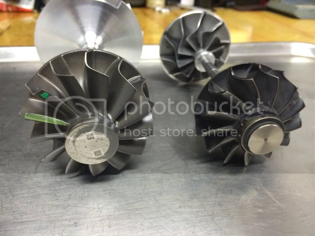

Below are some 2011 to 2015 6.7 Powerstroke internal pics.
The new 6.7 turbo stepped away from the dual boost/SST design and ball bearings. The 15 turbo is a stout journal bearing design with alot of inspiration from the gt37 and 40 series turbos from Garret.
As you will see in the photos the 15 charger is quite a brute compared to the old design.
We are already working on some modified units based off of the new design so stay tuned...
