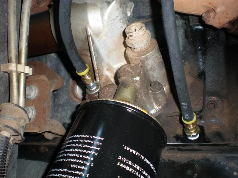

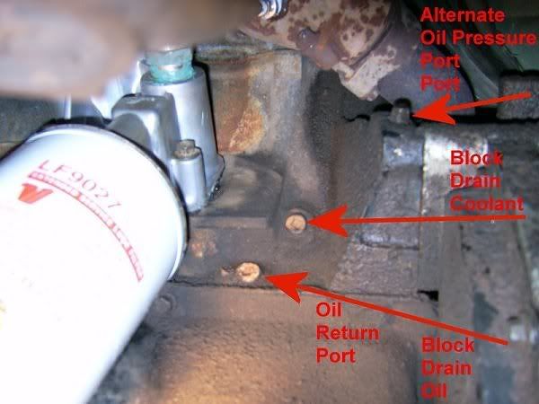

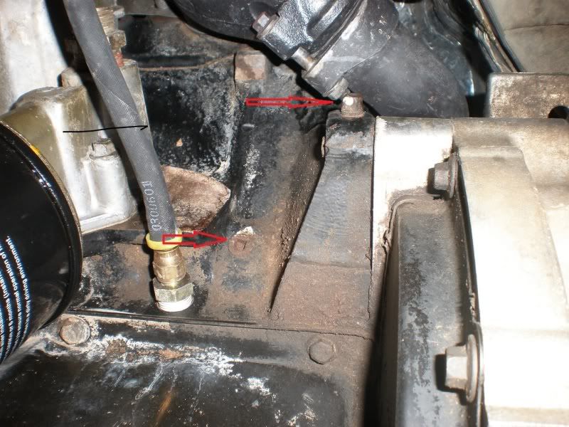

Adding a secondary oil feed hose to the HPOP Reservoir:
Purchase some suitable -4an Parker push loc (I think even 801 we use for fuel is rated to 300 degrees IIRC.)
You need enough to basically go from the oil filter area to the HPOP Res.
You will unscrew one of the plugs by the oil filter on the cooler or block flange. You have one to the left of the filter and then one way up on the engine flange where it meets the bell housing. IIRC both are 1/8" NPT.
1/8 npt > -4an male fitting -4an female hose ends.
Heres some pics for ref:
Only the top right port. Bottom left is coolant as is labeled on above photo.
The left of filter port/hose connection
