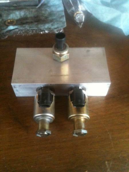

I like it. Is that a LPO sensor on the top or?
Never mind... Pulls head out of ass...

That looks familiar..... LOL

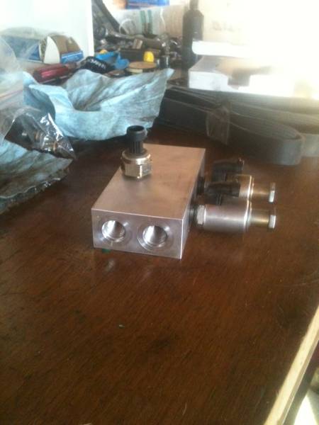

The next evolution of this part has built in filtration for the IPRs as well as some other handy little features that I am designing into it - but I need to finish with some other stuff before I firm up the design and start cutting chips on the mill.

How do the dual IPR's get wired in? What tuning changes get made for dual IPR's?
They are wired in series. As far as tuning I can only speculate. However, from the conversations I've had/read concerning how the IPR's operate in series, I am fairly confident no tuning adjustments will be required because of how the duty cycle will work in tandem. IOW in series the duty cycle of two IPR's should automatically fall in line. There was a thread in smack at PSN in which charles and a couple others participated on this very subject and that's what I recall. I tried doing a search last night but it was quite awhile back and I got tired of going through all the pages turned up by dual IPR search. May try again later because it had good info. I need to start pasting good stuff into a document to prevent things like this.

I always wanted to run two IPR's like that. It also makes it ridiculously easy to implement acumulators if a person felt so inclined.
Nice to see that it actually exists in reality. Nice work Jason.
