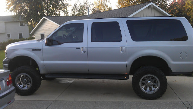

I'm getting ready to start this project so I thought I'd start a nice build thread.
Overview:
Early 99 F350 7.3L ZF6, 2wd. This guy will be donating the powerplant, wiring, fuel system, etc
2000 Excursion 6.8L 4r100 4wd. Picked it up for less than half what a decent diesel Ex would have cost me
I sold off the ZF and bought a 4r100 to rebuild. I figured swapping gas to diesel would be enough fun without switching to manual as well. I got a racer x X6TC converter and clutch kit as well to do a rebuild on the trans myself.
So that brings eveyone up to speed. The plan is to start rebuilding the trans over the next few months and freshen up the 7.3L. This spring I'm school and work full time so updates might be infrequent.

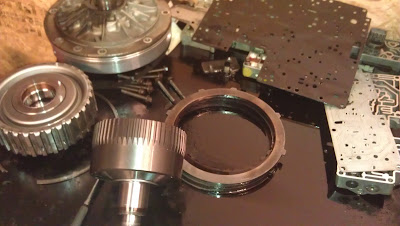

Started the teardown of the trans. I'm following the ATSG for it and it's going smoothly.
see that big clutchpack there... those clutches are burned down to metal and warped to boot. The guy I traded it from reported that he lost upper gears followed by all forward movement in any gear. I expect to find more burt up stuff as I get into it further
This is were I stopped. I have to make a tool to compress this clutch pack so I can pull out the clip

I got it all pulled apart without any special tools, but I'll definitely need those to compress things going back together.
Here's the gutted case, it looks great in the with barely any wear:
and the rest of the parts:
Now the intimidating part- look at all these damn seals:
Lots of these seals are really close in size. I started to put it back together and ran into a snag putting the low bearing in. I have to get some threaded rod to compress those springs correctly.
any great advice? now's the time, lol
