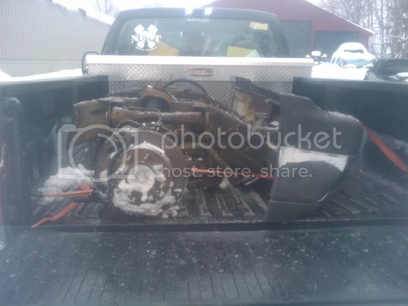

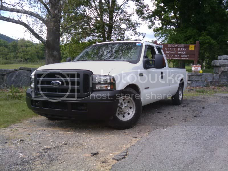

bought the truck in Feb 09 looking like this
by the next day it looked like this

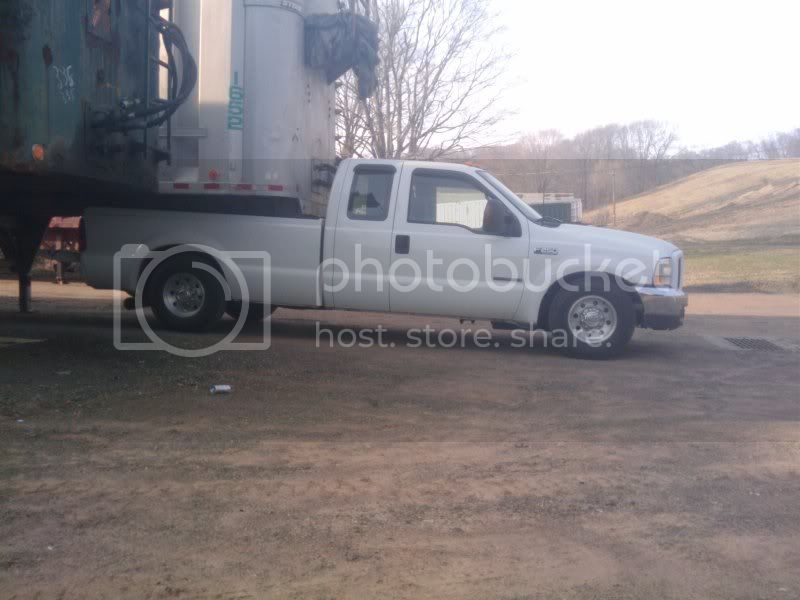

by July of 09 she had clear corners and a 08 bed
January 2010 i added a non wastegated van turbo
rat49f6
1,259
Vernon,NJ

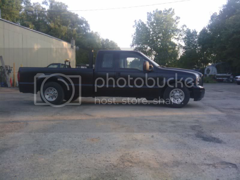

Spring of 2010: 3/5 djm drop and a modded 05 grill
parked under my 1st trailer
05 front end minus headlights and 5" stacked exhaust (april 2010)

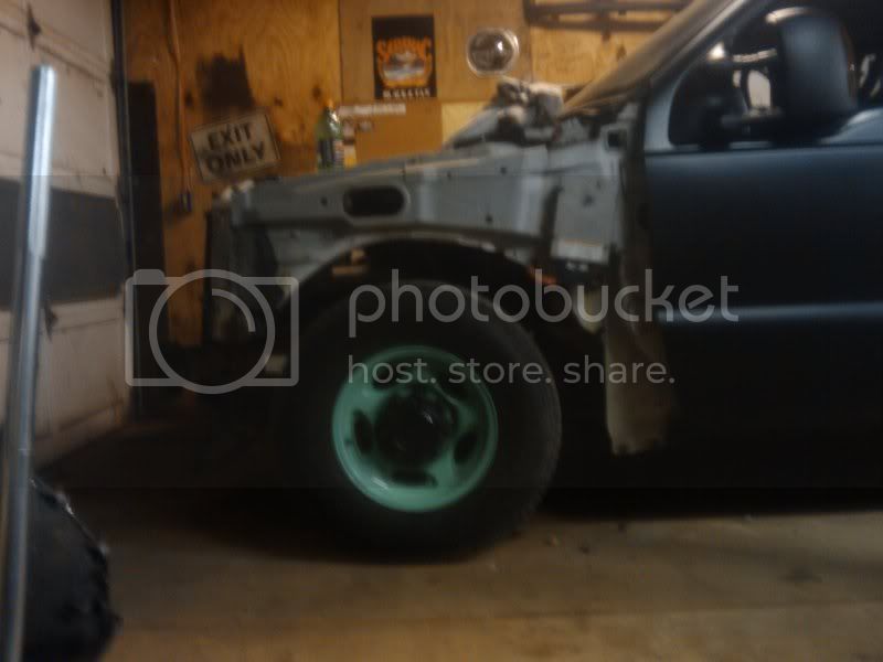

prepped for paint (march 2010)

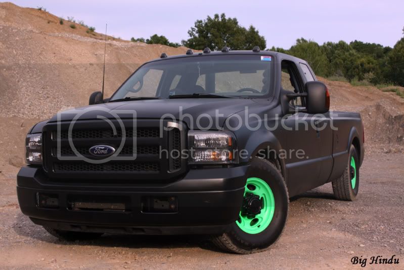

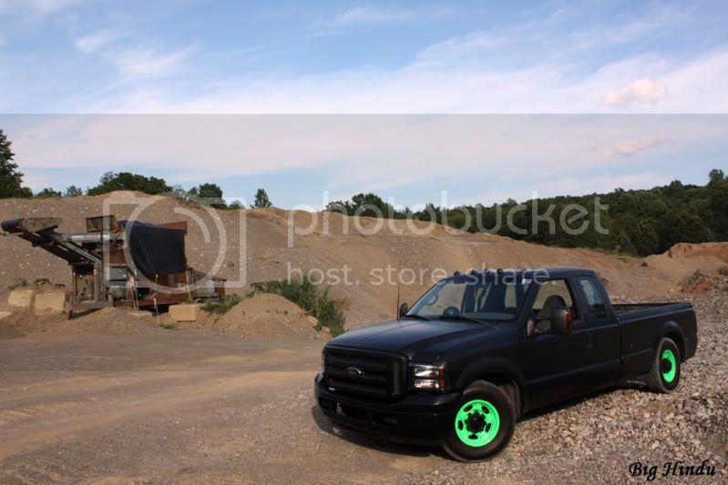

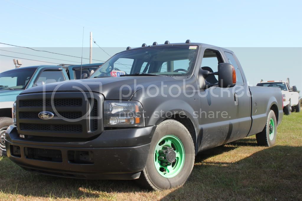

John Deere Blitz Black

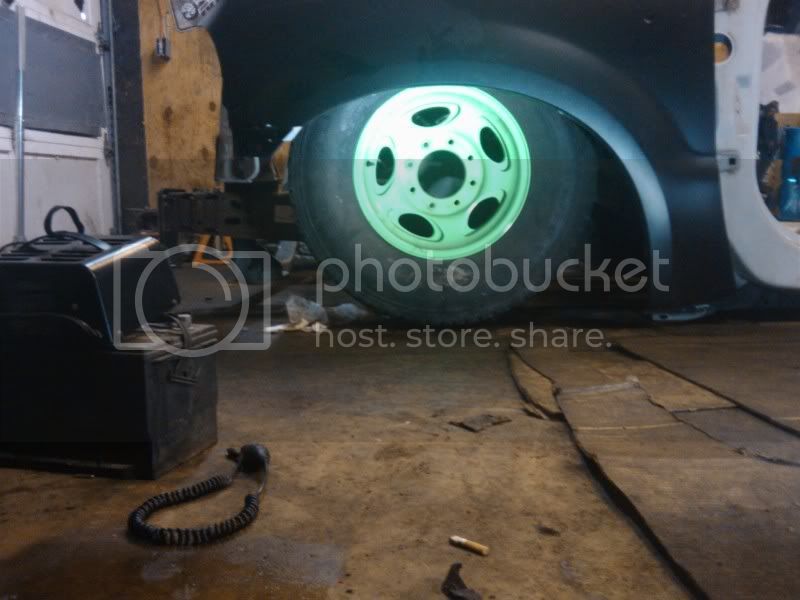

Lariat wheels powdercoated in Kawasaki green
photoshoot

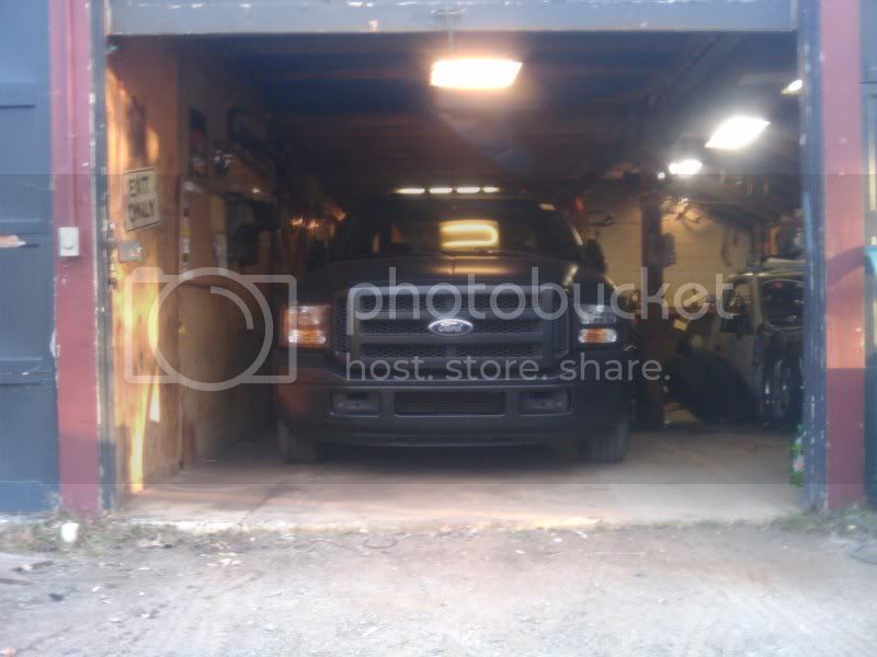

@ Mason Dixon TDC Fall Brawl Dyno Event the weekend before taking it off the road
its tight but it will do

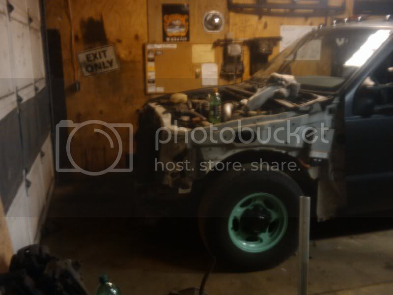

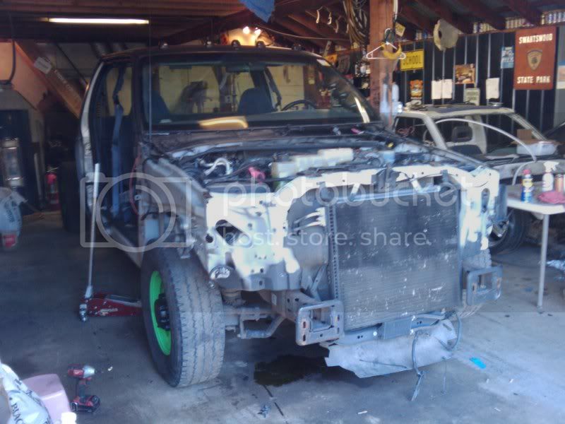

dismantle
first night i cleaned the shop up a lil
took off:
hood
drivers fender
drivers inner fender well
wiper cowl
front bumper
grille
headlights
99 to 05 headlight harness
header panel

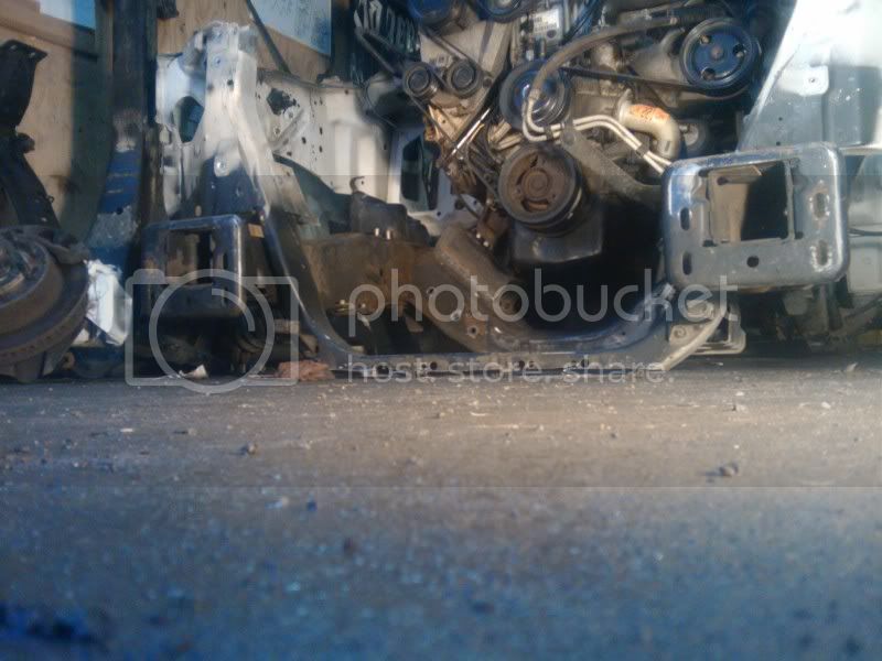

rat49f6
1,259
Vernon,NJ

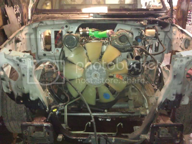

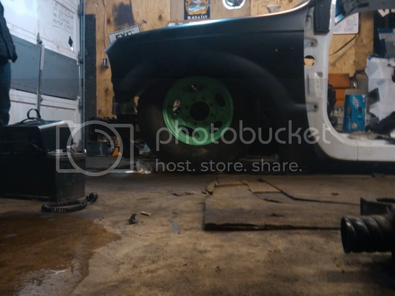

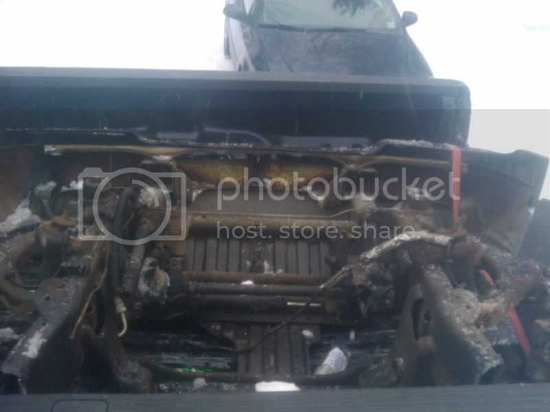

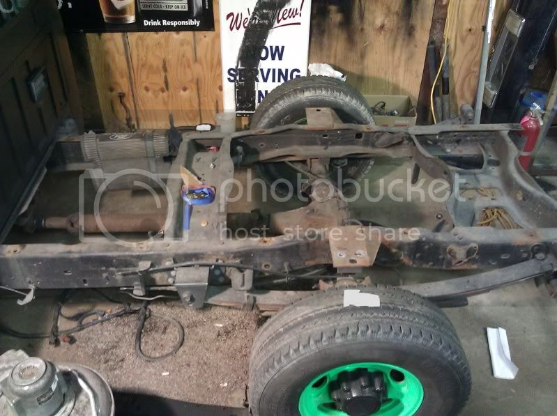

front of the truck with all the unboltable sheet metal removed
and the rear in the same condition

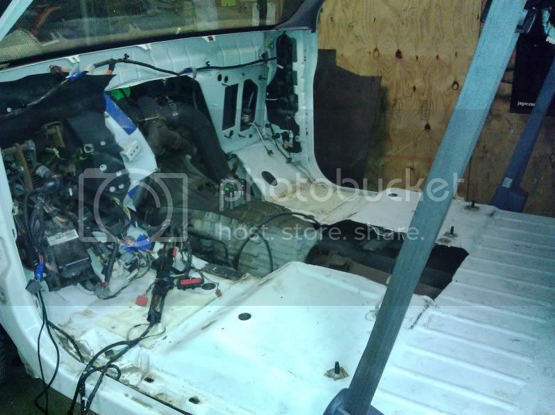

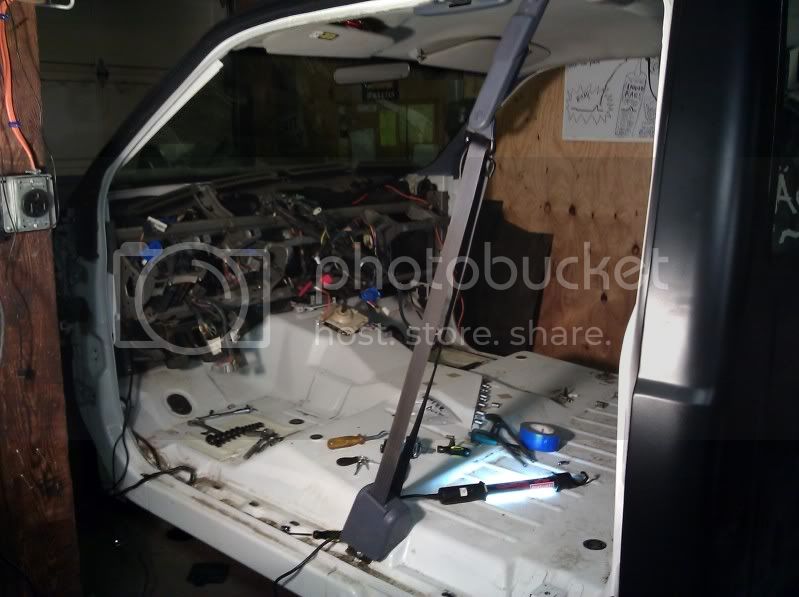

updates:
removed the dash
floor mat
seats
hvac ducts
wiring harness
steering column
trans cross member
pics:
front
back

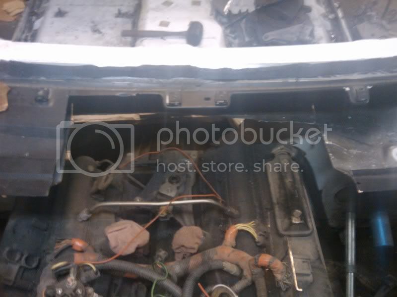

rat49f6
1,259
Vernon,NJ

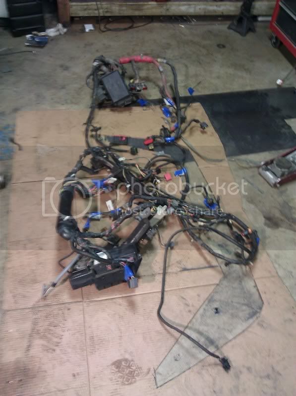

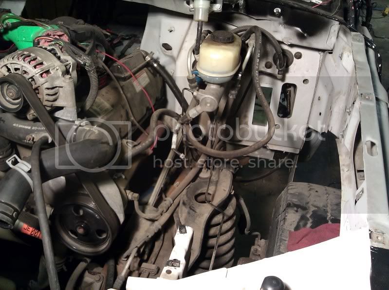

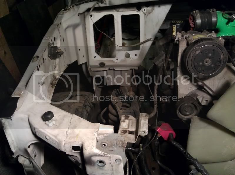

wire harness and heater box removed
passengers side
drivers side
inside
the wires i removed
i think the harness will be retrofitted under the dash

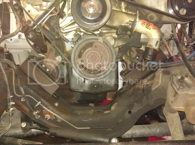

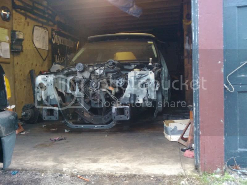

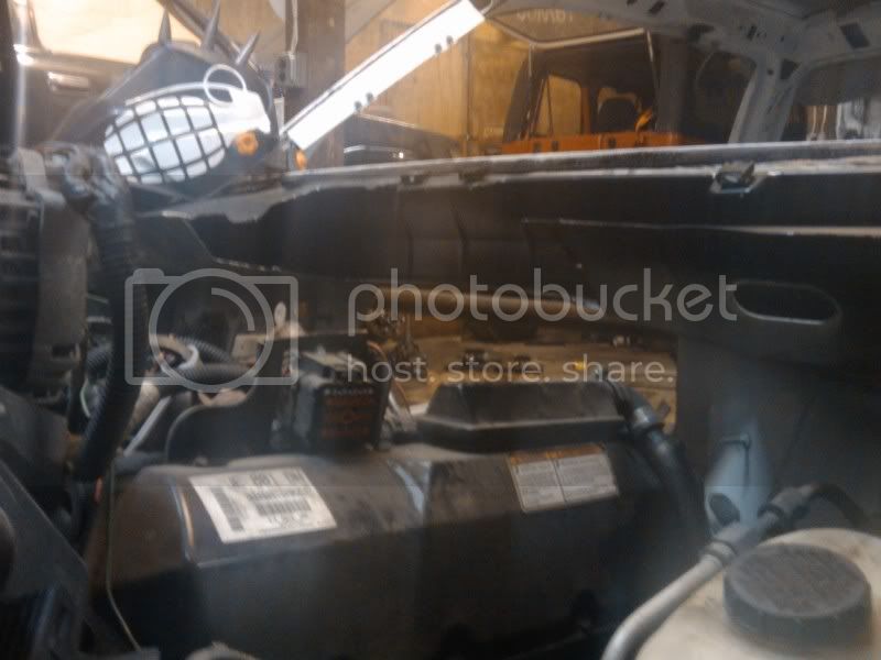

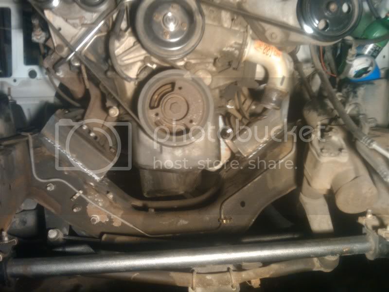

alt will is higher than the cowl... cowl hood or relocate??
i can change turbo's while driving

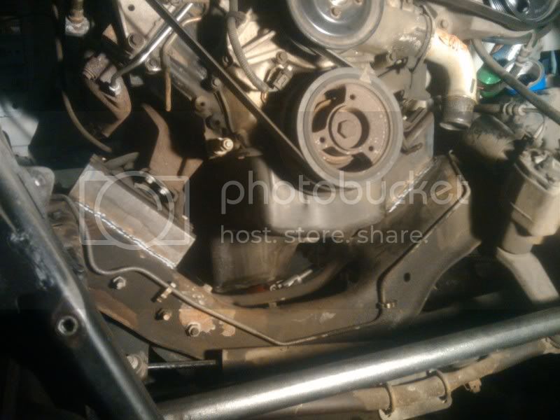

modded engine mounts...
the motor mounts are not done they still need to be slugged with 1.5" dom tube and the ends capped

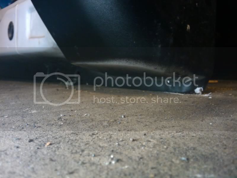

pulled an all nighter and after 26 straight hours we introduced the truck to "Mother Earth"
laying pinch

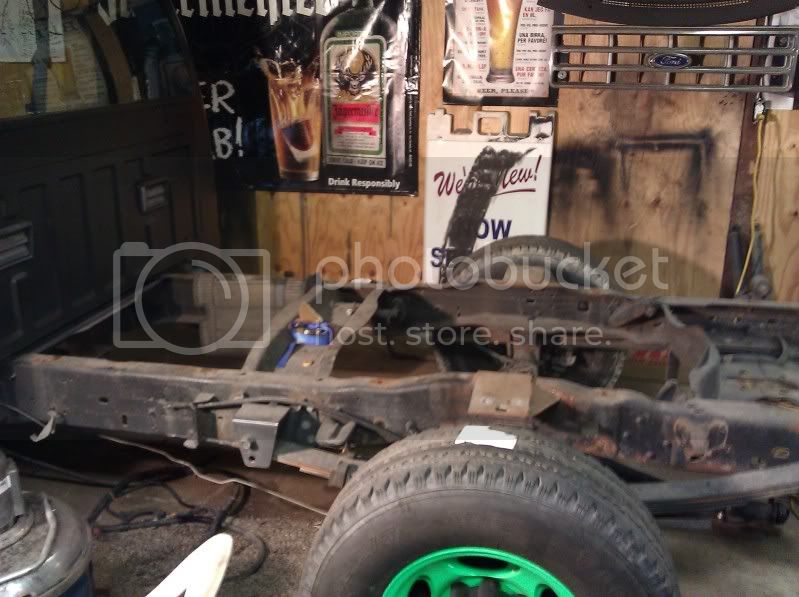

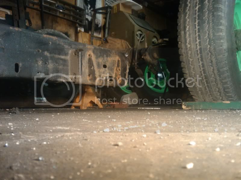

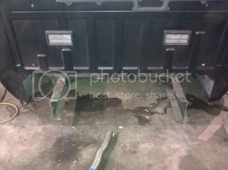

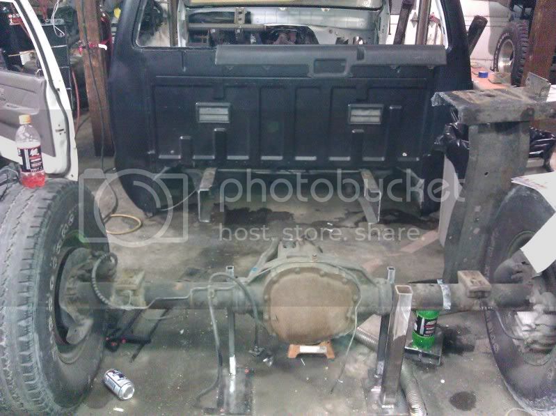

few pics of the back with the leafs are off
the rear of the truck ... yes the center line of the pinion is over that crossmember and about even with the cross member that hold the carrier deop bracket
frame shot from the floor
front laid out the whole way

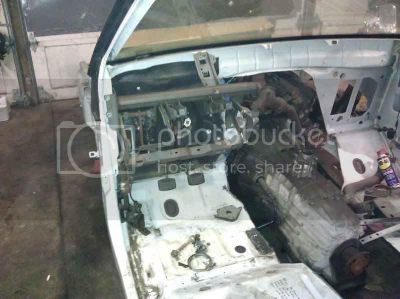

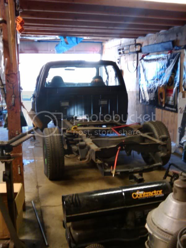

rear axle jigged to the floor and the frame is finished cut 8" behind the front bed bolts
reinstalled the dashboard support... then cut it in half. ill only need the part that holds the steering wheel

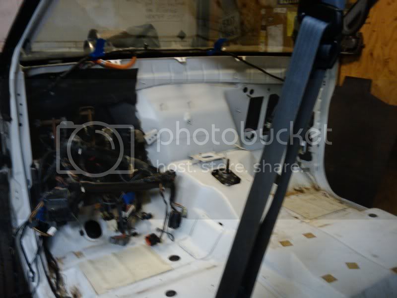

rat49f6
1,259
Vernon,NJ

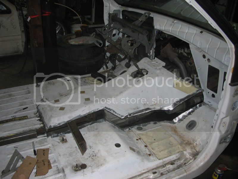

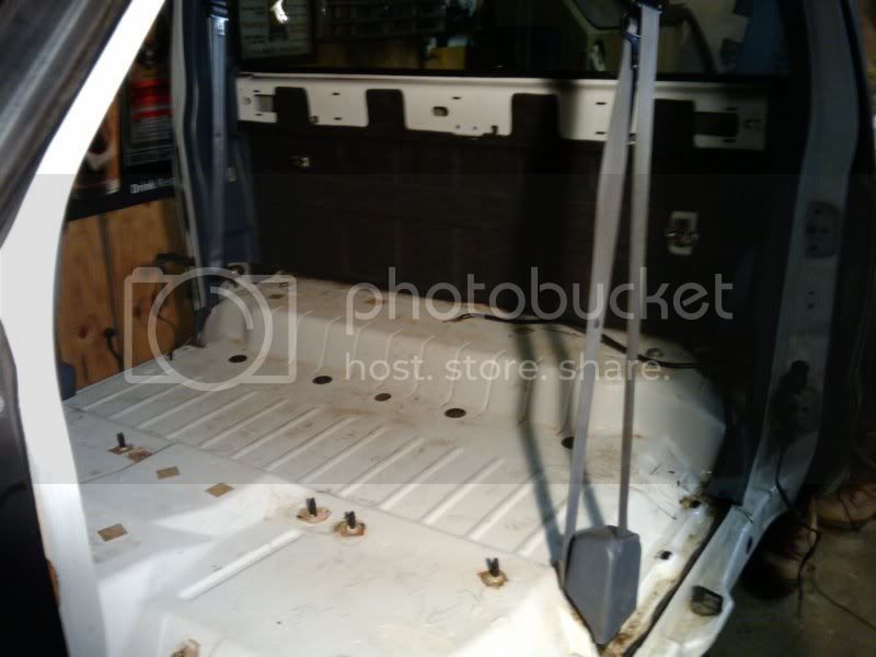

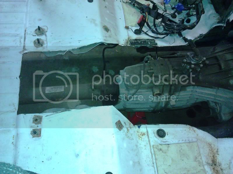

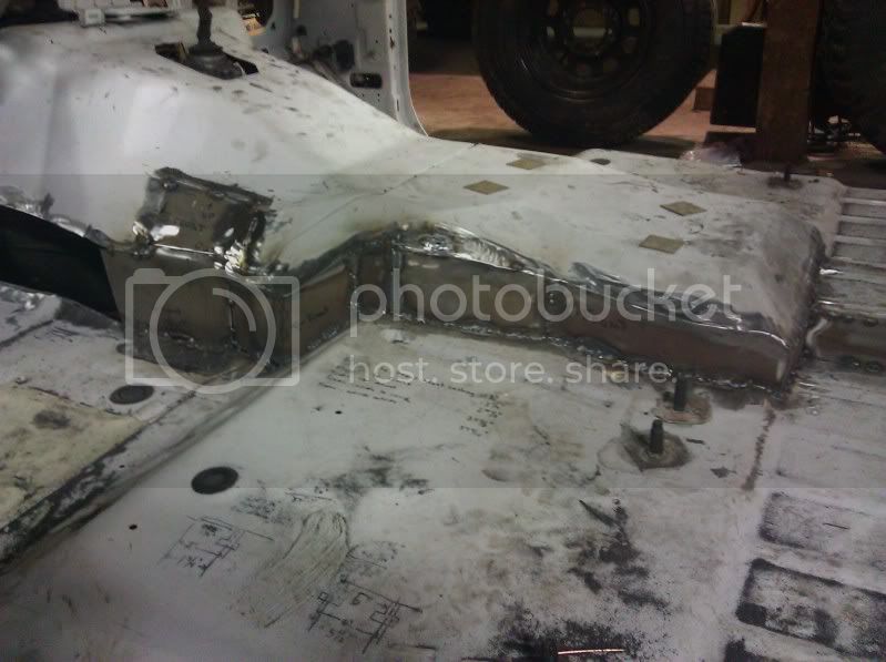

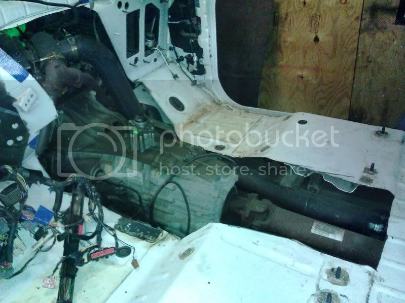

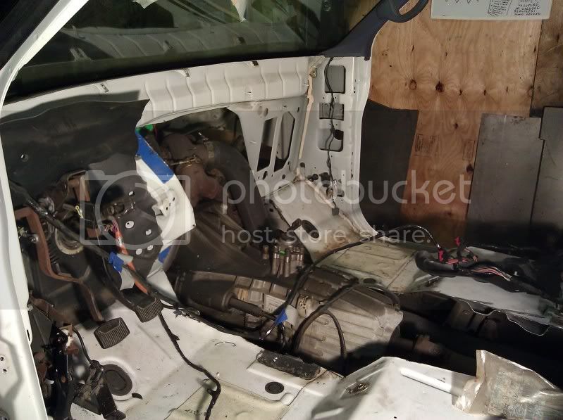

driver's side of the floor raised to clear the trans
passenger's side
from the back window
close up

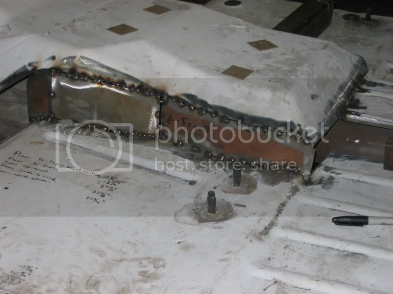

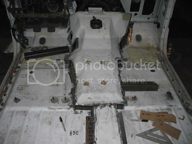

rat49f6
1,259
Vernon,NJ

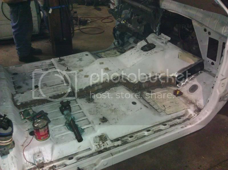

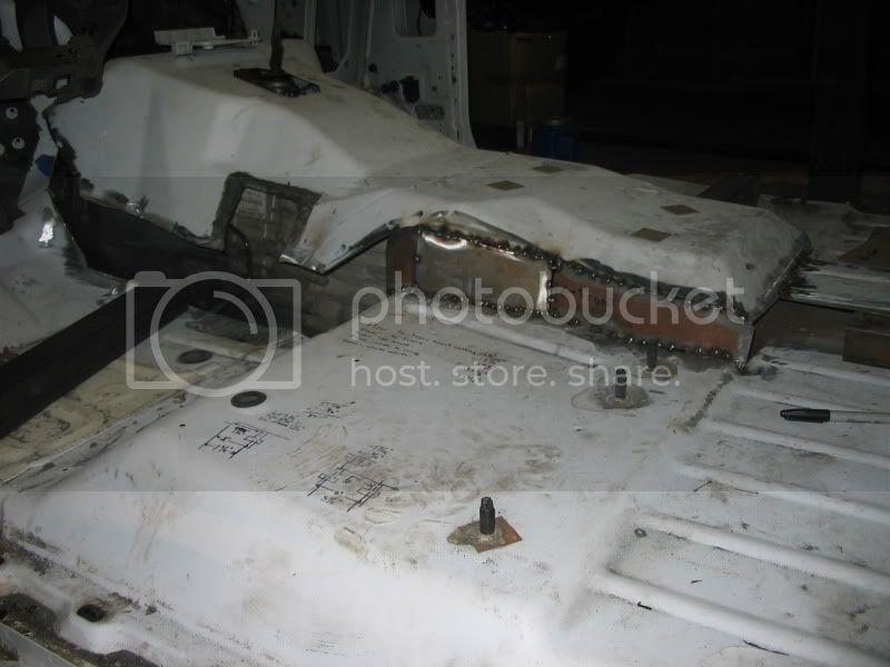

got the floor panels in that are going in for now
Driver's side:
Passenger's side:
and some "finish" work done too (above the seat bolts)

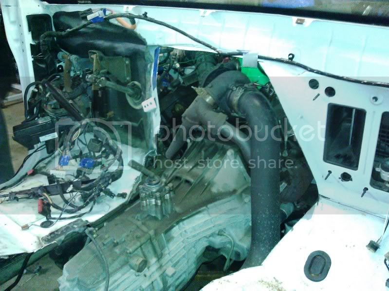

rat49f6
1,259
Vernon,NJ

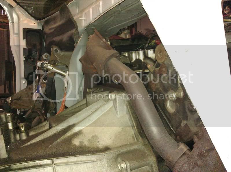

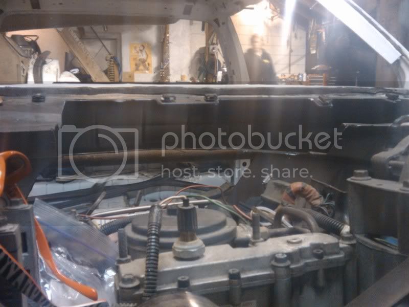

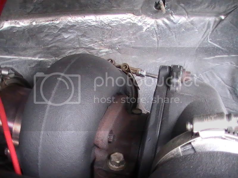

crappy cell pics but i made some cuts so i can get the turbo in and out again
from up high
from the front
from the drivers side
i still have some finish grinding to do and have make a plate for the inside of the cowl on the passenger's side. im happy with how sturdy t still is and ill be able to remove the turbo very easily, at most i will have to remove the wiper cowl

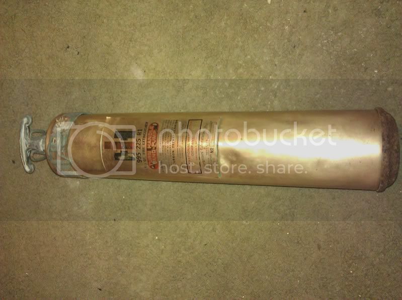

i found it in my grandfathers garage while putting up plywood
i cleaned it up but still need to shine it some more
