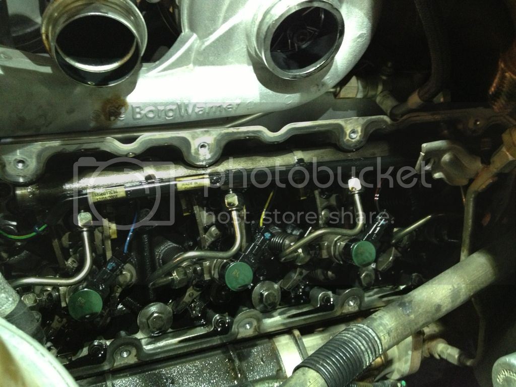

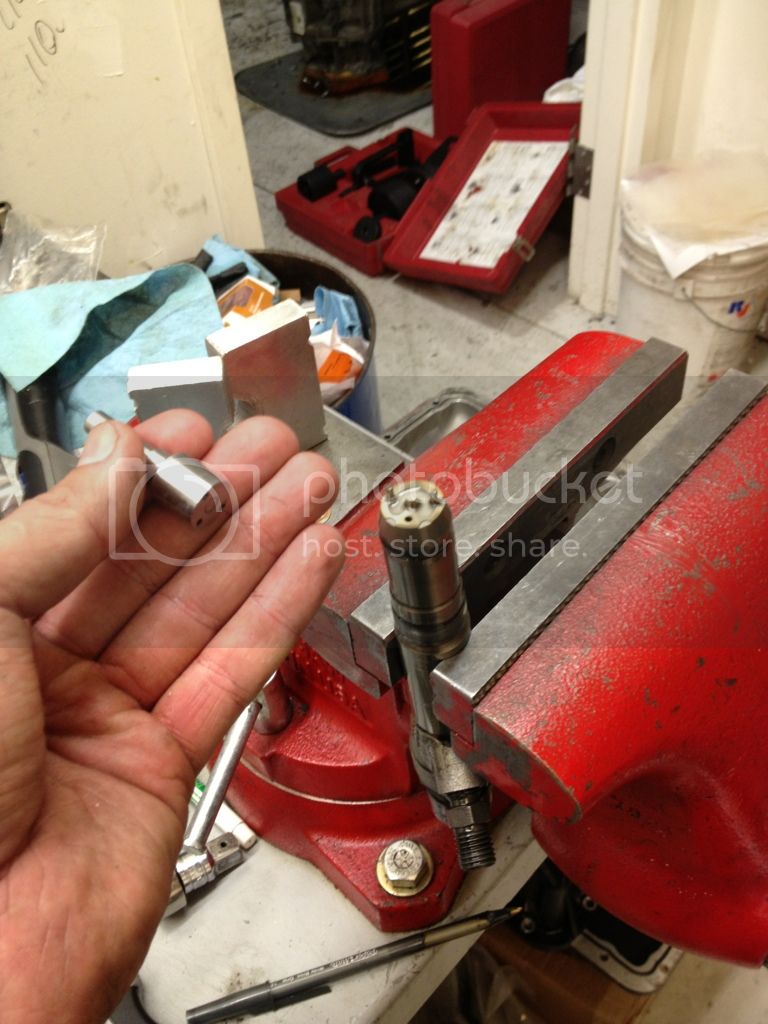

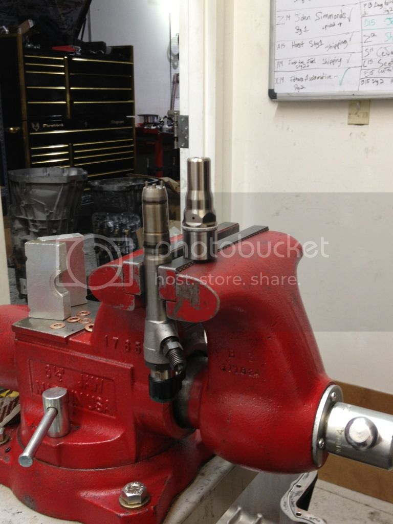

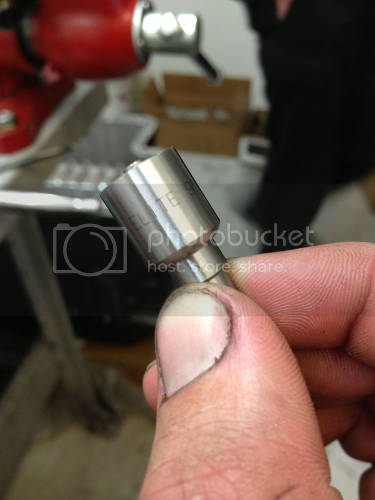

Here are some pictures from the nozzle swap itself.
