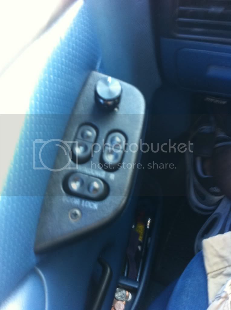

I got my TS chip installed this weekend and I must say, this isn't the same truck. I thought all the talk about the chips were a little inflated, but it is all it is cracked up to be.
I still need to find a spot to mount my switch. I wish they would add about 4' to the wire. I would like for it to be mounted in my center console.
