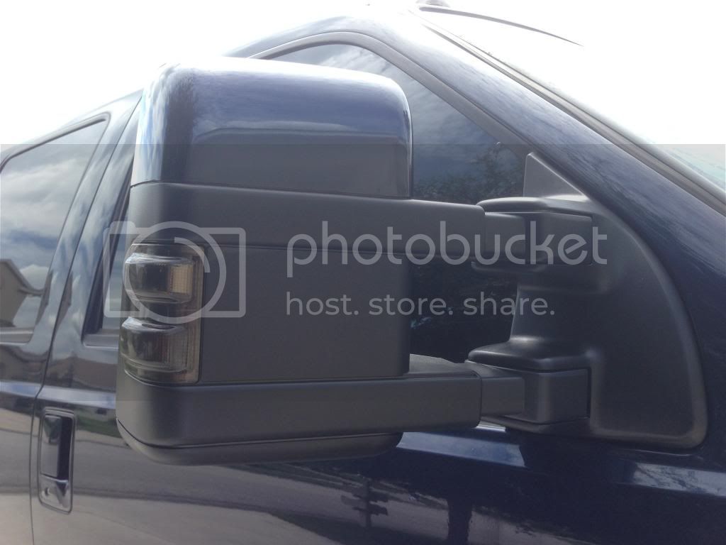

I’ll begin with few pictures taken after the installation was completed.
Passenger side installed

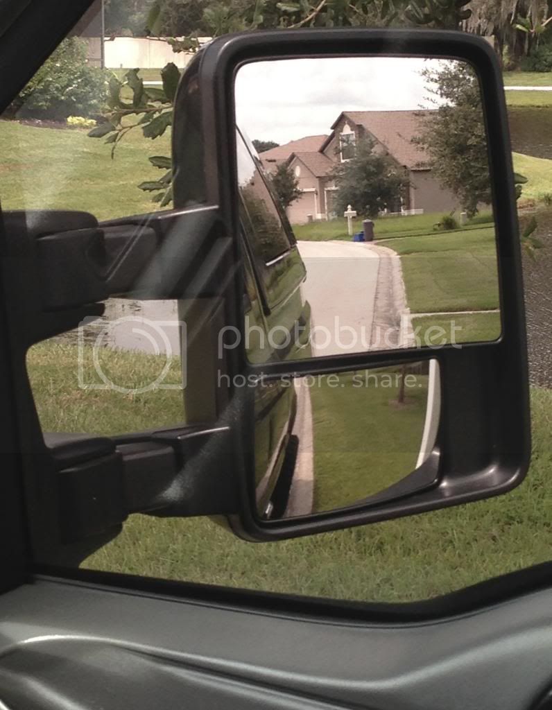

Notice the improvement in visibility in the lower mirror!!
For reference, the white sign post (outer edge of the lower mirror) is mid-cab and less than 3' away from the side of the truck. This has turned out to be incredibly helpful when travelling on multi-lane highways: no more blind spots!

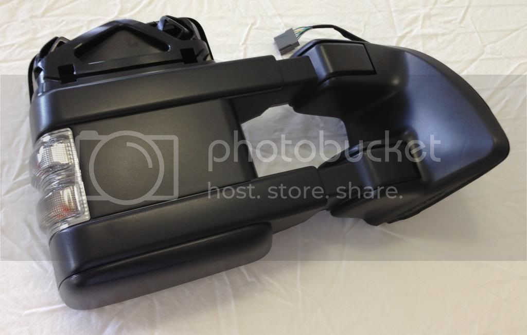

As received…

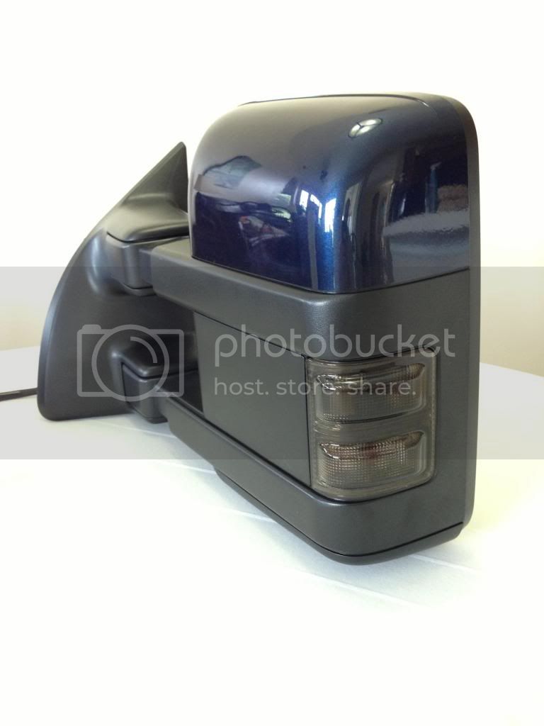

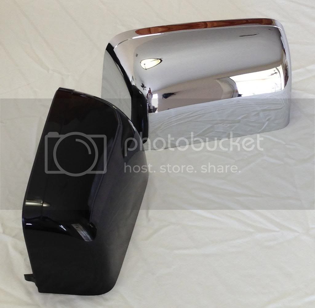

These come with both paint to match (PTM) and chrome mirror caps
1A Auto Parts also includes this connector to convert a square plug (mirror) to a round plug (truck). My 2005 F-250 did not need to use this part to complete the installation, but earlier model years will.

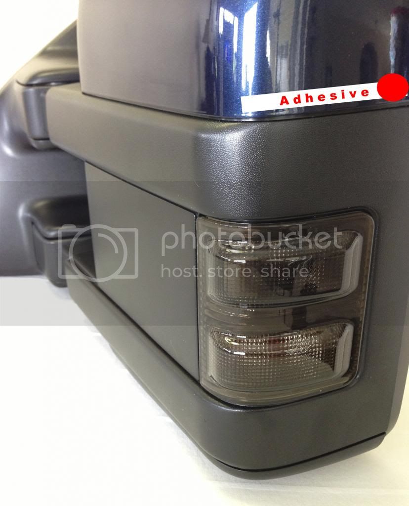

I decided to tint the marker light covers while the PTM covers were getting color matched.
I think they turned out perfect and couldn’t wait to install them, and the installation turned out to be incredibly easy.

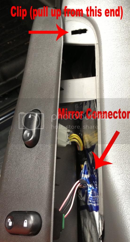

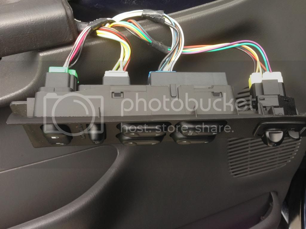

Start by removing the switch panel for the windows/mirrors/door locks from the door panel by pulling up on the front of the switch panel. The panel is held in place by only one clip at the front (closest to the door hinges). The mirror connector is behind the switch panel and is likely secured to the door. After removing the switch panels, unplug the mirror connector.
Passenger side (mirror connector is behind the aftermarket sound deadening material)
Driver side switch panel (four connectors)

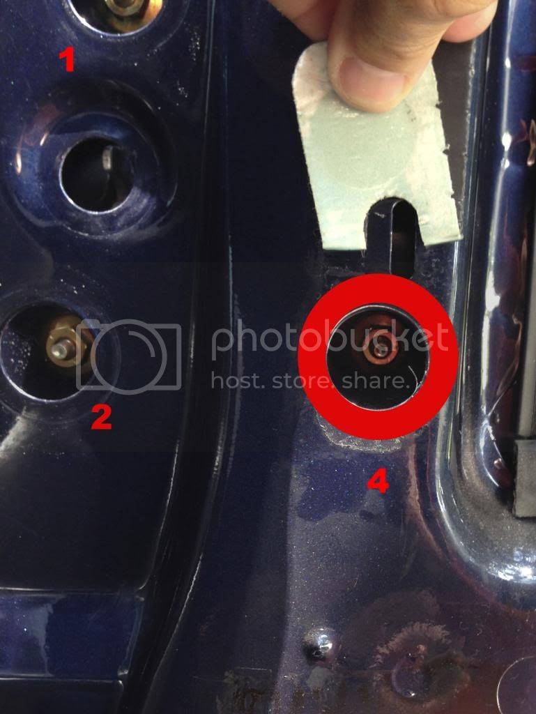

The upper and lower rubber grommets each hide a nut (labeled 1 and 2) that must be removed in order to take the mirror off. There’s also a piece of anti-vibration material underneath the sail panel that hides two nuts (labeled 3 and 4) that also hold the mirror in place.
Remove the mirror by loosening the 11mm nuts using a deep socket.
*** TIP *** Use a 11mm deep socket to initially loosen the nuts, but use nut driver with a magnetic bit to complete the removal. These nuts are very difficult to reach and can easily fall down into the door panel.
Once the four nuts are removed, the mirror can be pulled directly away from the door.
