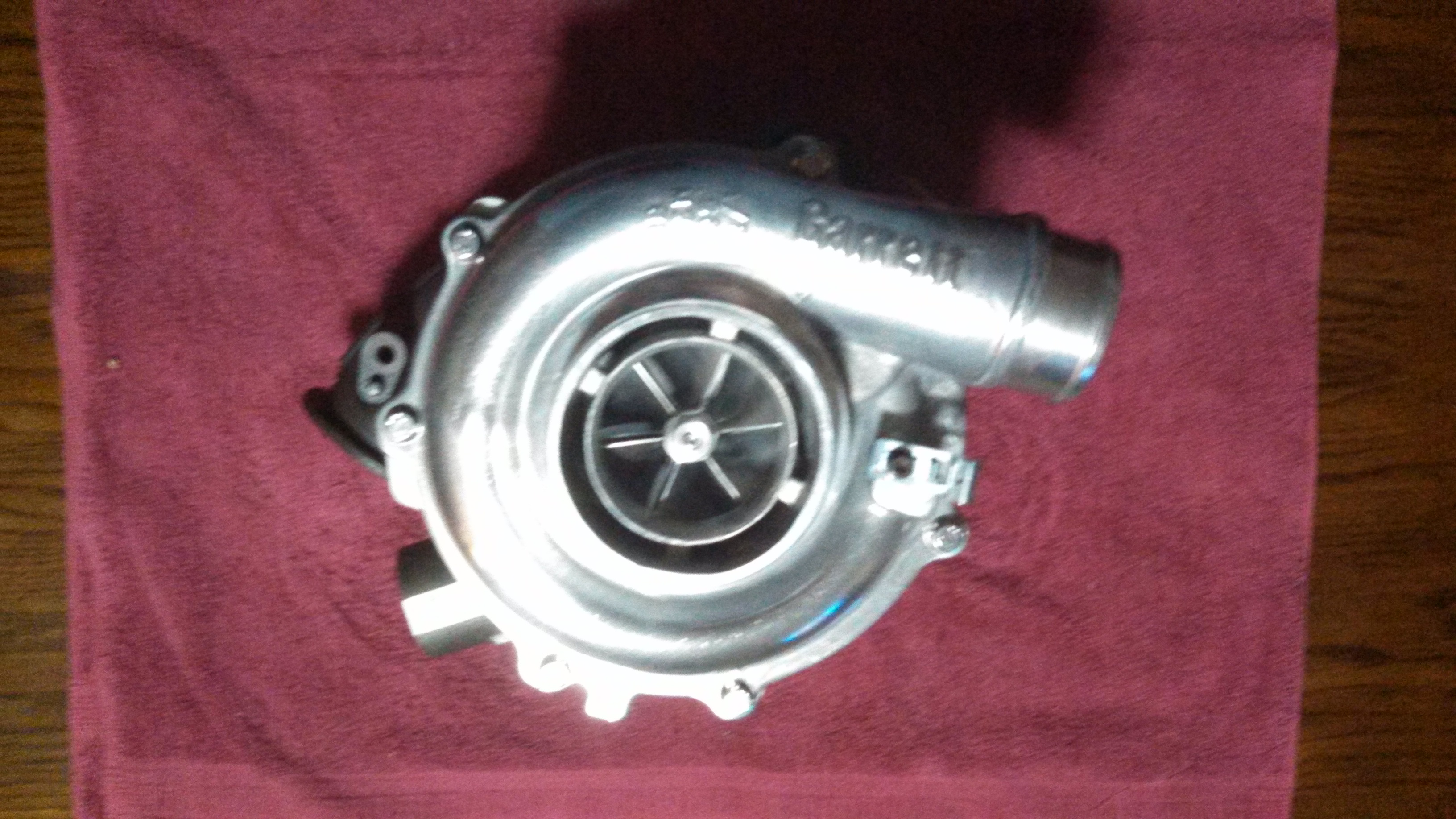

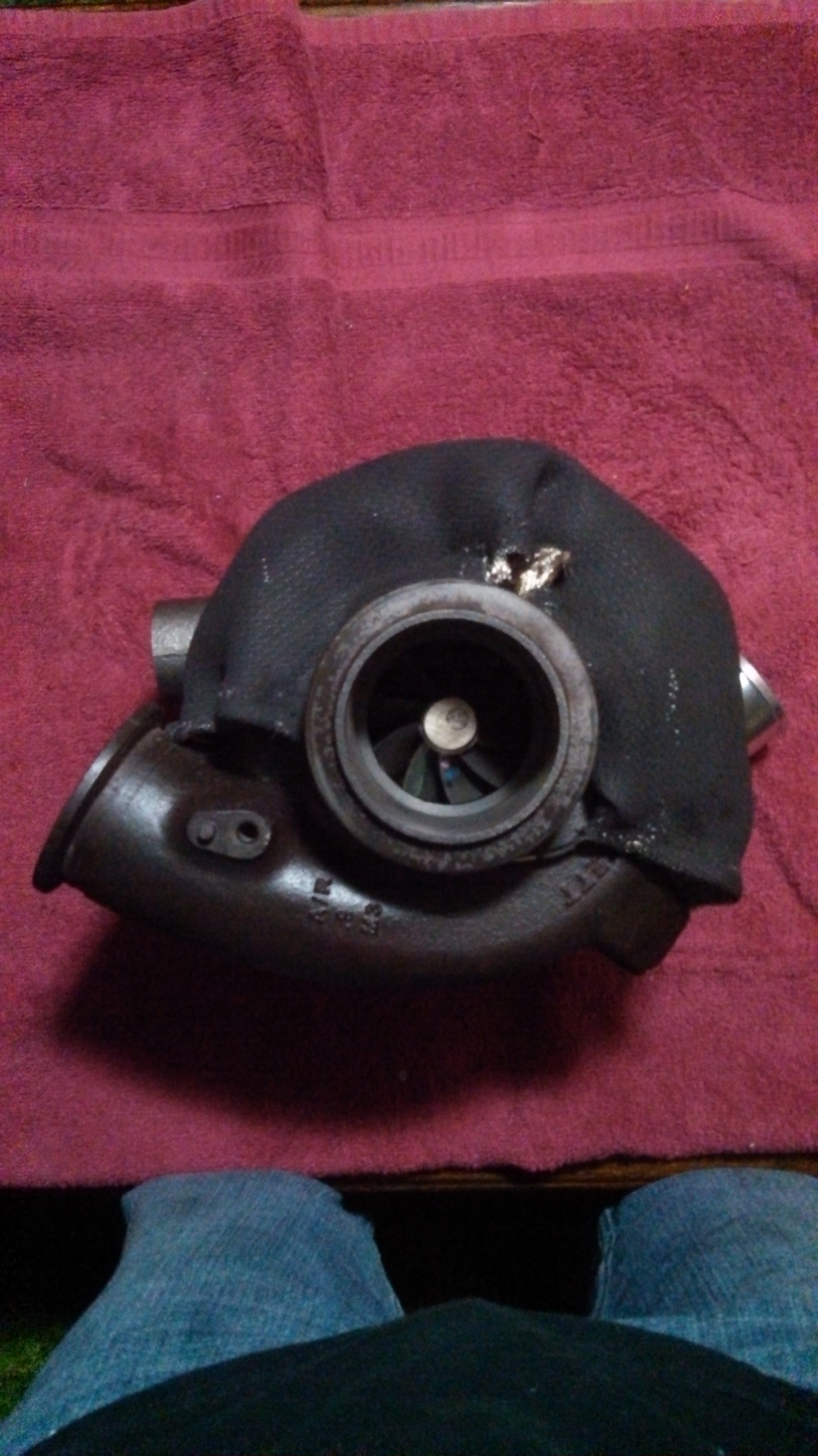

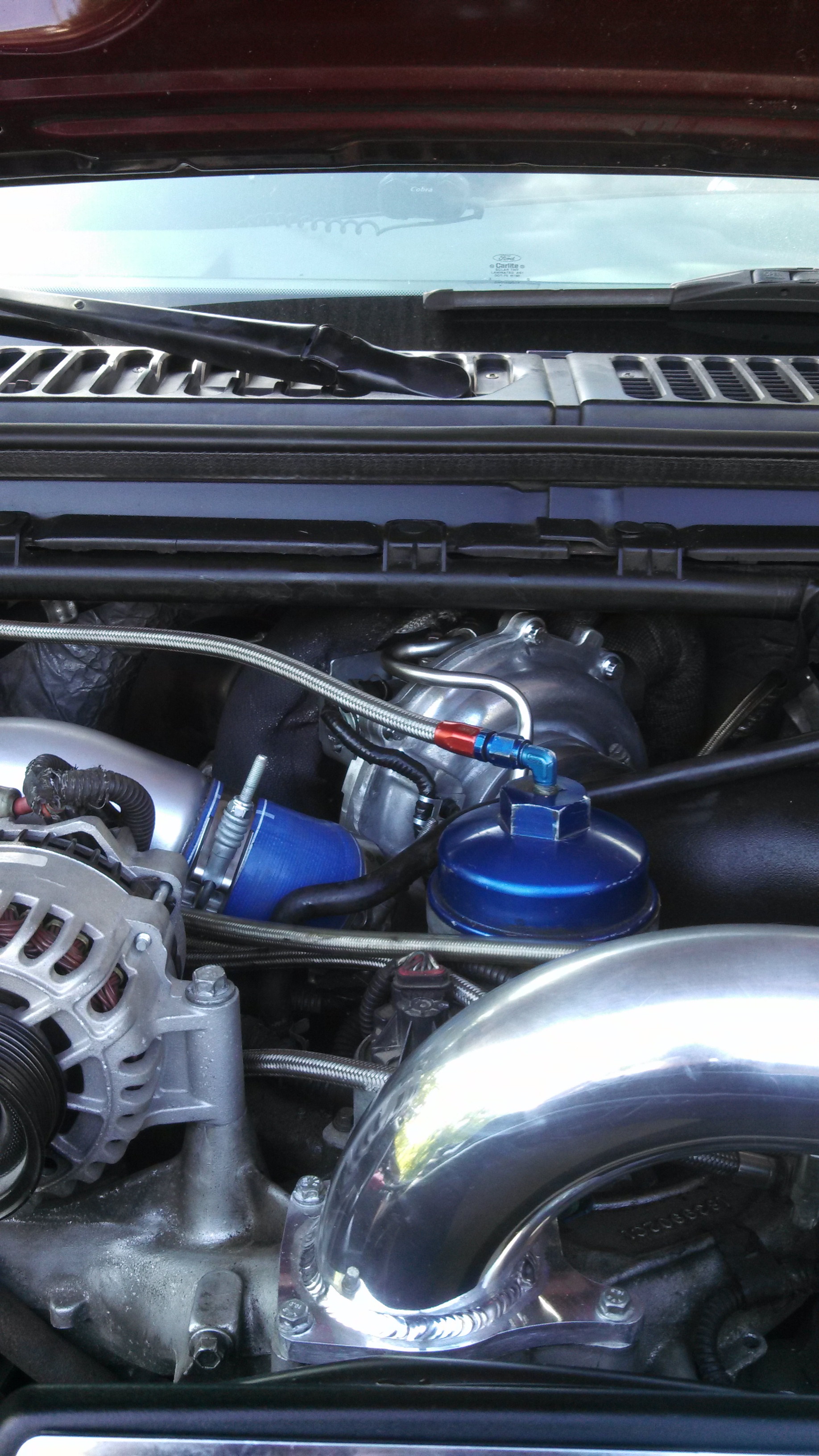

Got the stage 3 from Adrian this past Wednesday. I put stainless ARP bolts in the compressor housing...sick of the stock ones rusting. Also put a turbo blanket on it. I really missed the polished compressor housing on my 64mm non vgt I use to have...so I tried polishing it up the best I could. Eric sent me a couple x-street tunes for testing. Once we dial in the x-street, we'll work on dialing in the x-x tune. I'll post readings later.
