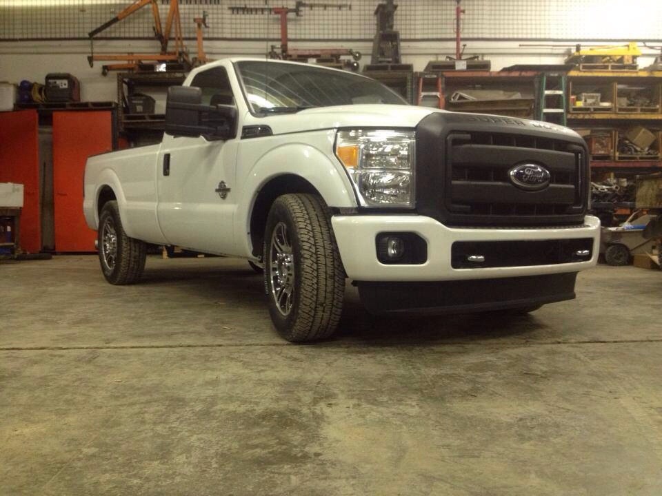

The truck is a 2011 6.7 2wd regular cab. Bought it with 74,99x miles on it. Went out of state to get it since it was a good deal. Loaded a minimax in the dealer parking lot. Drove it home. Started doing some other stuff to it and cleaning it up and beautifying it a little. It needs some body work and paint matching some stuff too.
The truck made it to 75,9xx miles when I pulled it in the shop here the last time because the transmission already lost 4th gear. Sooo, I guess I didn't do it any justice.

Lowered the rear, put some platinum wheels and tires on. Platinum front bumper.
