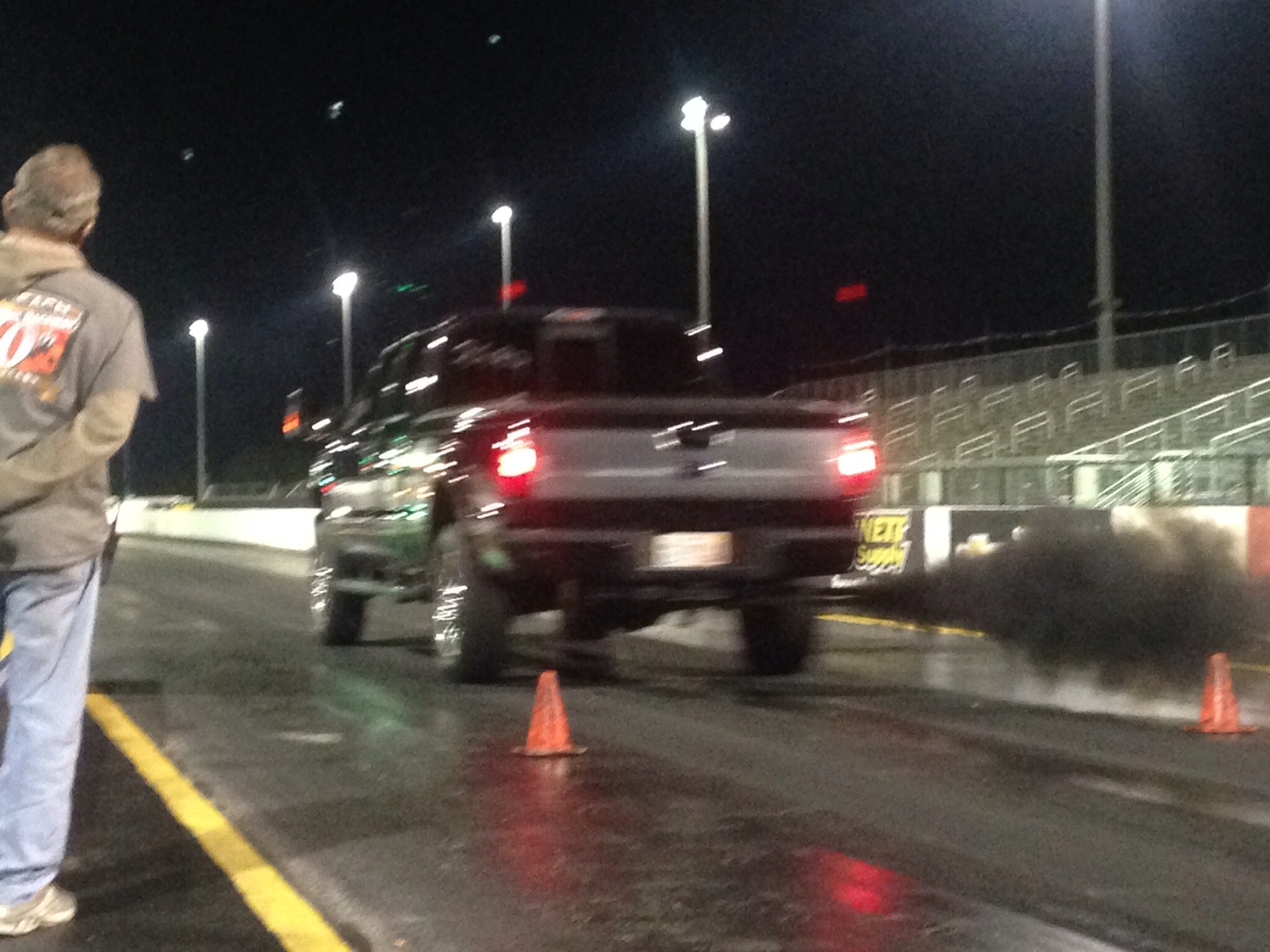

I would like to start a discussion about the best way to launch our 2011 - 2014 6.7's. With the axle lock on and the Trac Control off I still have have a problem sometimes with the truck going into dead pedal. Feels like the anti-lock brakes are kicking in on the rear and then it gets real ugly! Mostly doing a Boost lunch when this happens. I'm sure you guys have some great stories and I would like to hear them. I am running the SPE locker kit. Ran my worst times ever last night at Palm Beach International Raceway. Could not hook up to save my a$$ at the line. Any ideas?:tree:

I would like to get this figured out before the 21st.
