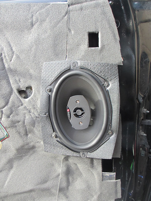

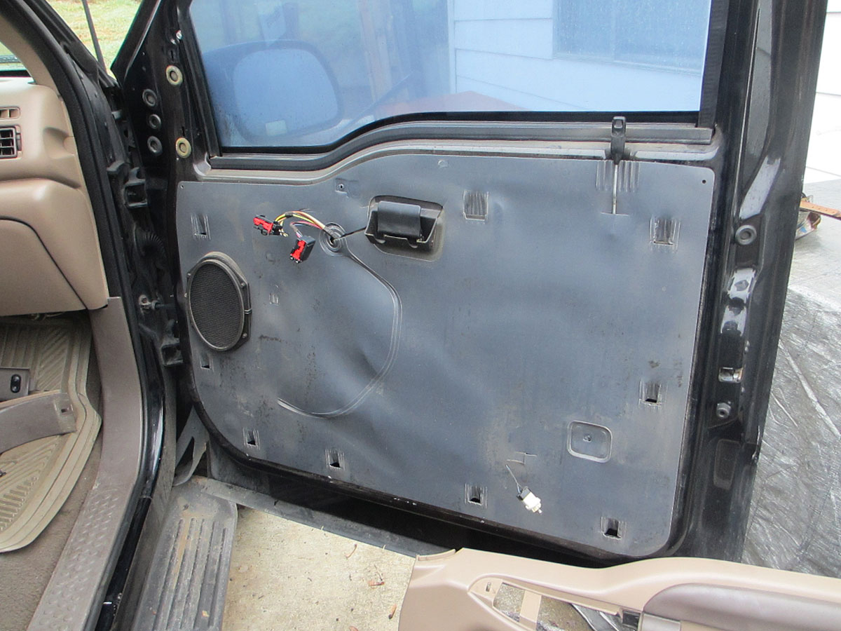

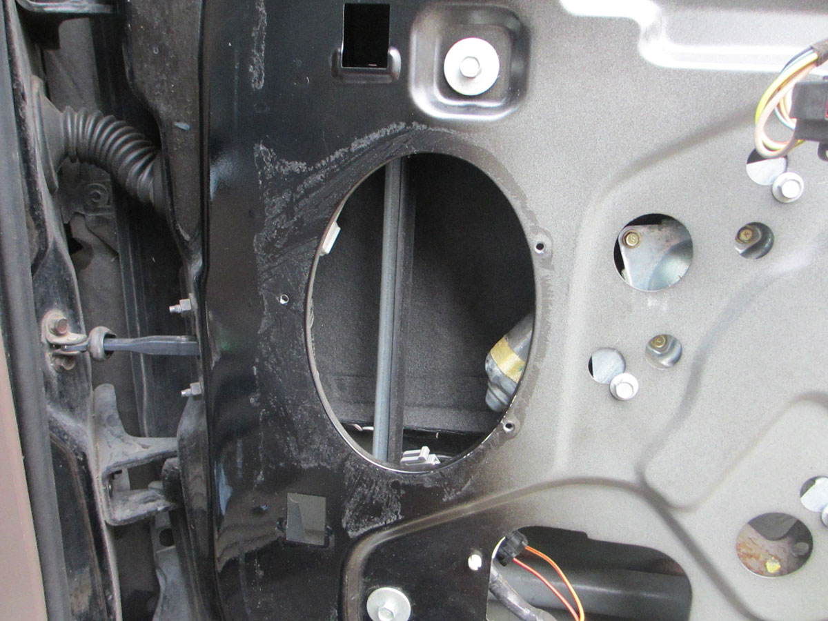

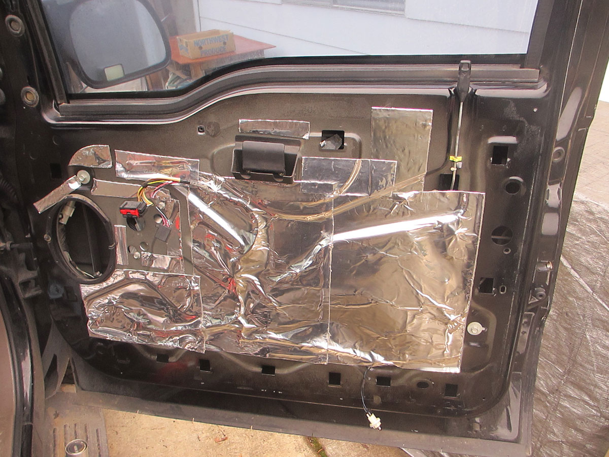

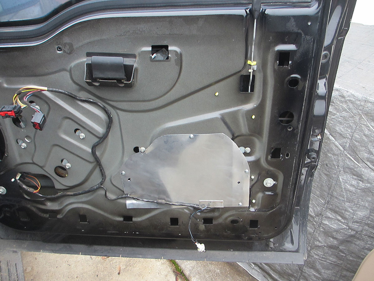

Photos are as follows:
1. Door panel removed
2. Plastic sheeting removed, you can see the large access hole
3. Speaker hole
4. Sheet metal over the access hole
5. Generic accoustic mat (I think I used RAAMat or something like that)

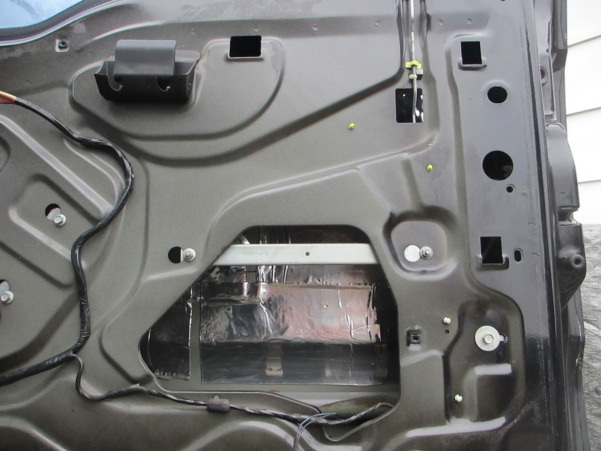

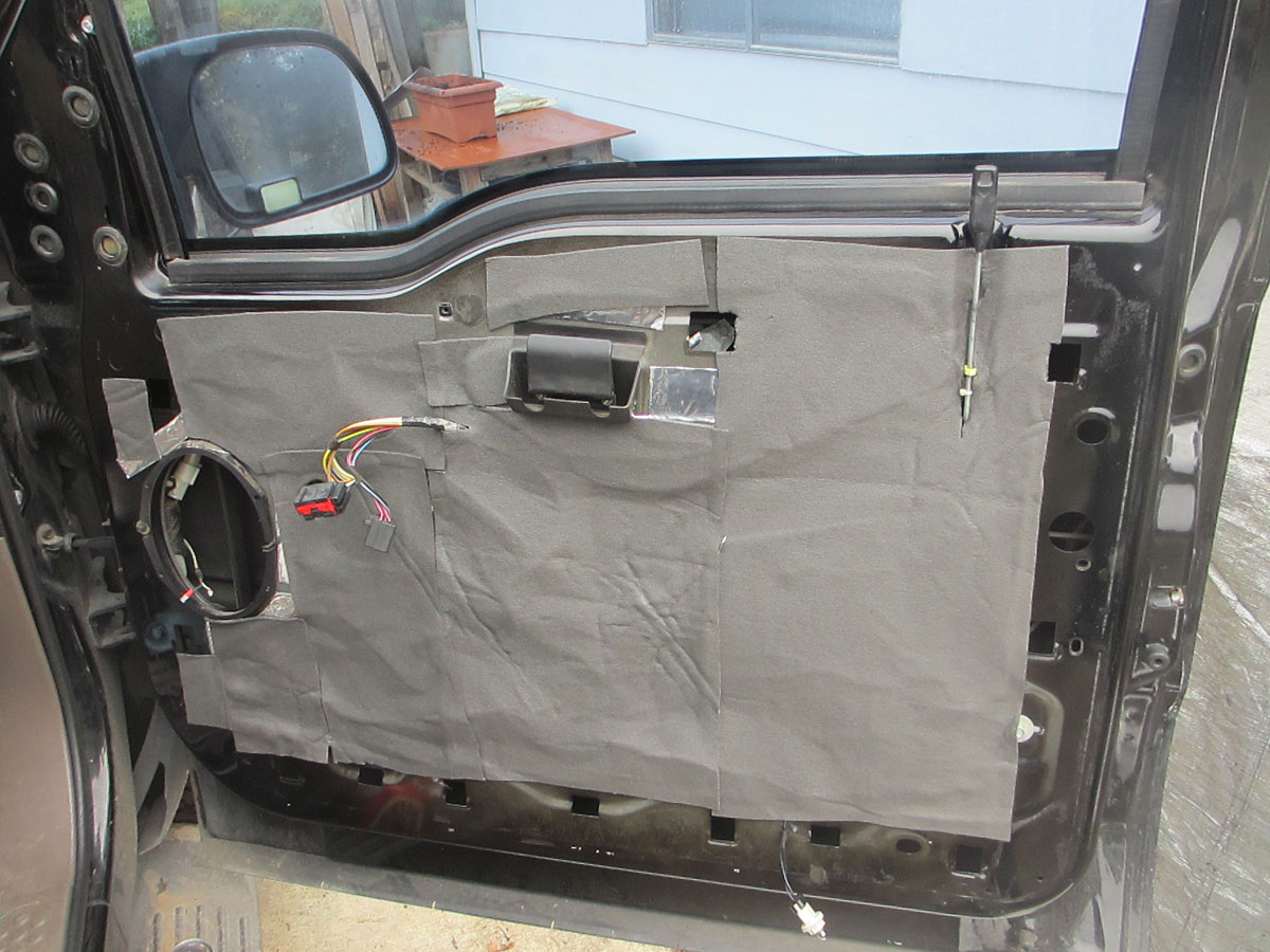

So in highschool since I worked at a stereo shop, for one of my science classes I did a before/after experiment of dynamatting and foaming the head liner on my 4Runner. Made a huge difference on road noise and my max SPL went up 3dB. So I did a little research on the latest and greatest since it'd be 15 years since I did it. Basically the difference now seemed to be slightly less use of matting, matting is now less expensive (Dynamat brand isn't the only game in town) and use of sticky backed acoustic foam is more prevalent.
With the doors I sheet metaled the access hole, applied the matting, then acoustic foam sheet over.
On the back wall, it's was pretty straightforward. Matting + foam sheeting.
For the floors, I basically did what I could get by peeling back the carpet liner without actually pulling the whole carpet out. Since I'm not building this as a competition stereo vehicle, just wanting to reduce some road noise, I figured that'd be good enough. Between the matting and inserting silicone tubing in the door seals, I was pretty happy with the noise reduction. Riding in a Lexus this is not, but now I can mostly hear my wife when we're on the freeway at 70mph.

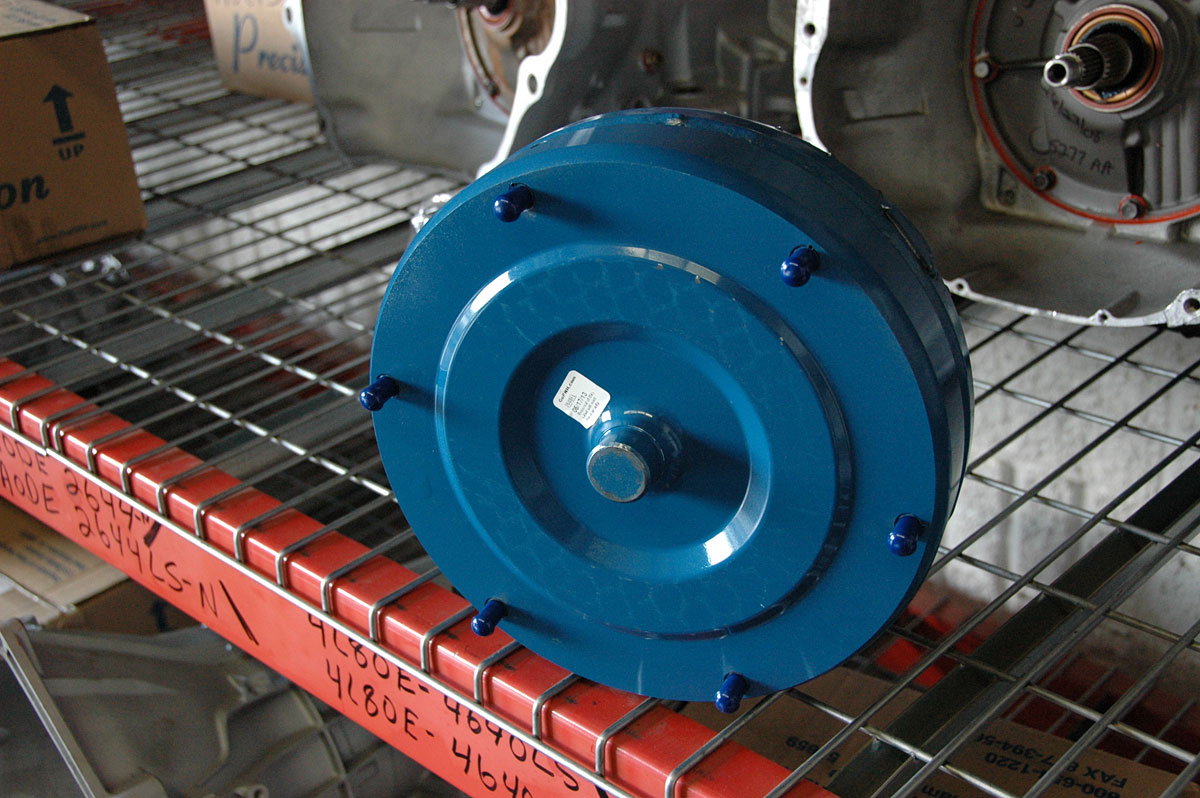

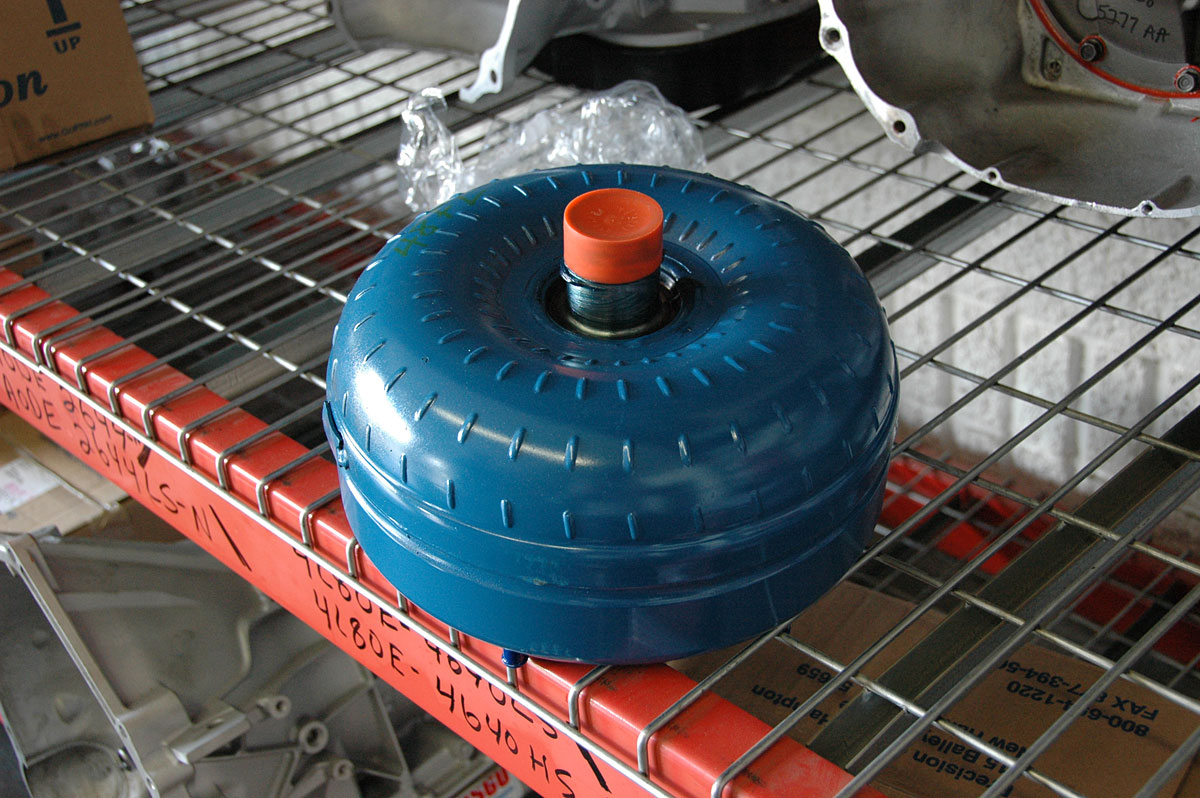

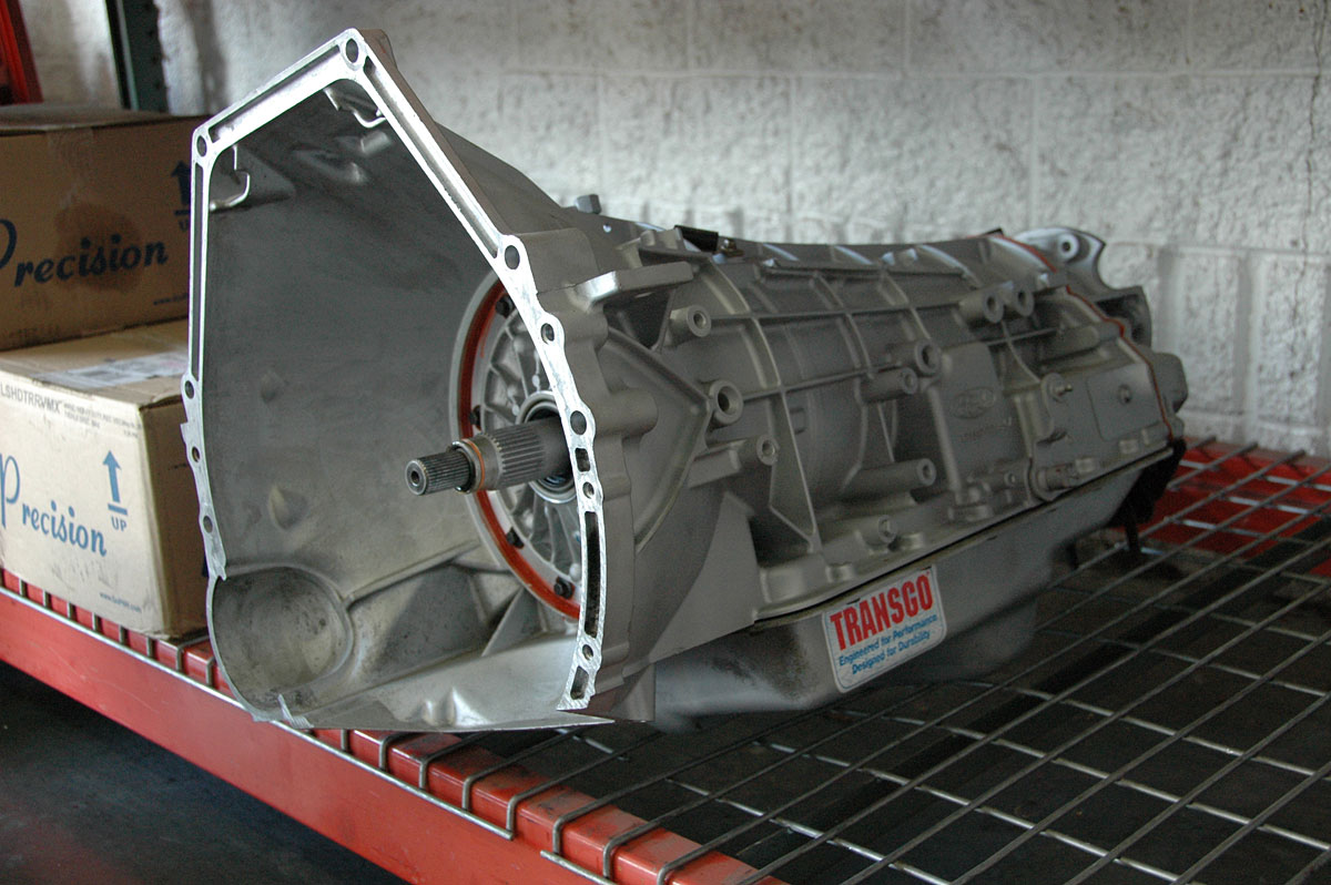

Photos:
1. Trans+Medic shop in Gresham OR
2. They build their transmissions using Precision of New Hampton torque converters
3. Another shot of the converter
4. Cory usually has a 4R100 built and on the shelf for quick turn around installs
5. Another shot of the trans
If course the simultaneous important thing was to get new tunes from Jody to accommodate the different valve body, which is a TransGo Tugger.

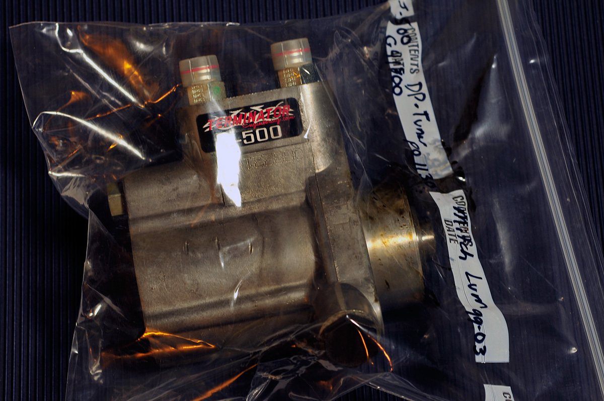

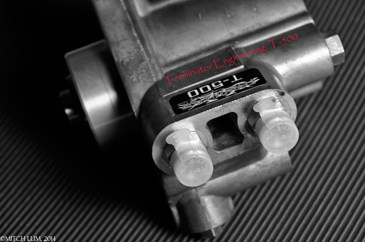

HPOP - Terminator T500 from Joey via Jody
This one was kind of easy - it's what Jody carries/recommends, it will be enough for the 160/30's with room to spare down the road and will be a huge improvement from the stock 15* pump on my truck with ~240k miles on it.
I was particularly happy with how quickly Joey got me the pump, and how quickly he inspected my core and pushed the refund though with Diane.
So now for some eye candy - 5 shots of the T500.

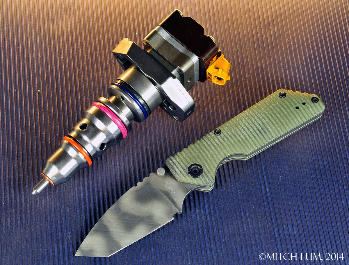

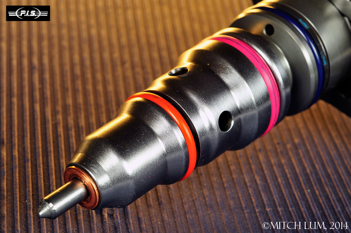

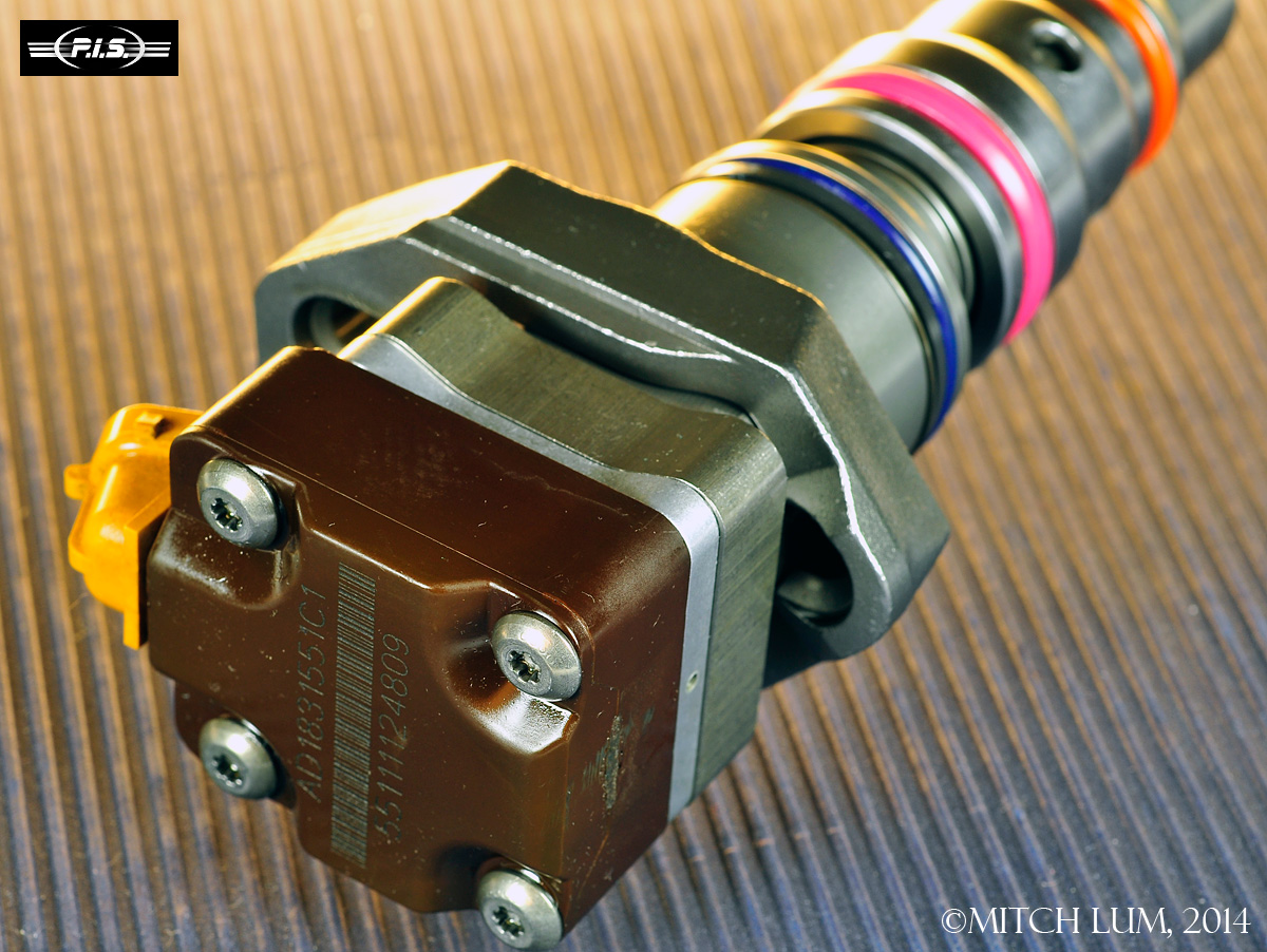

Shots of the injectors.

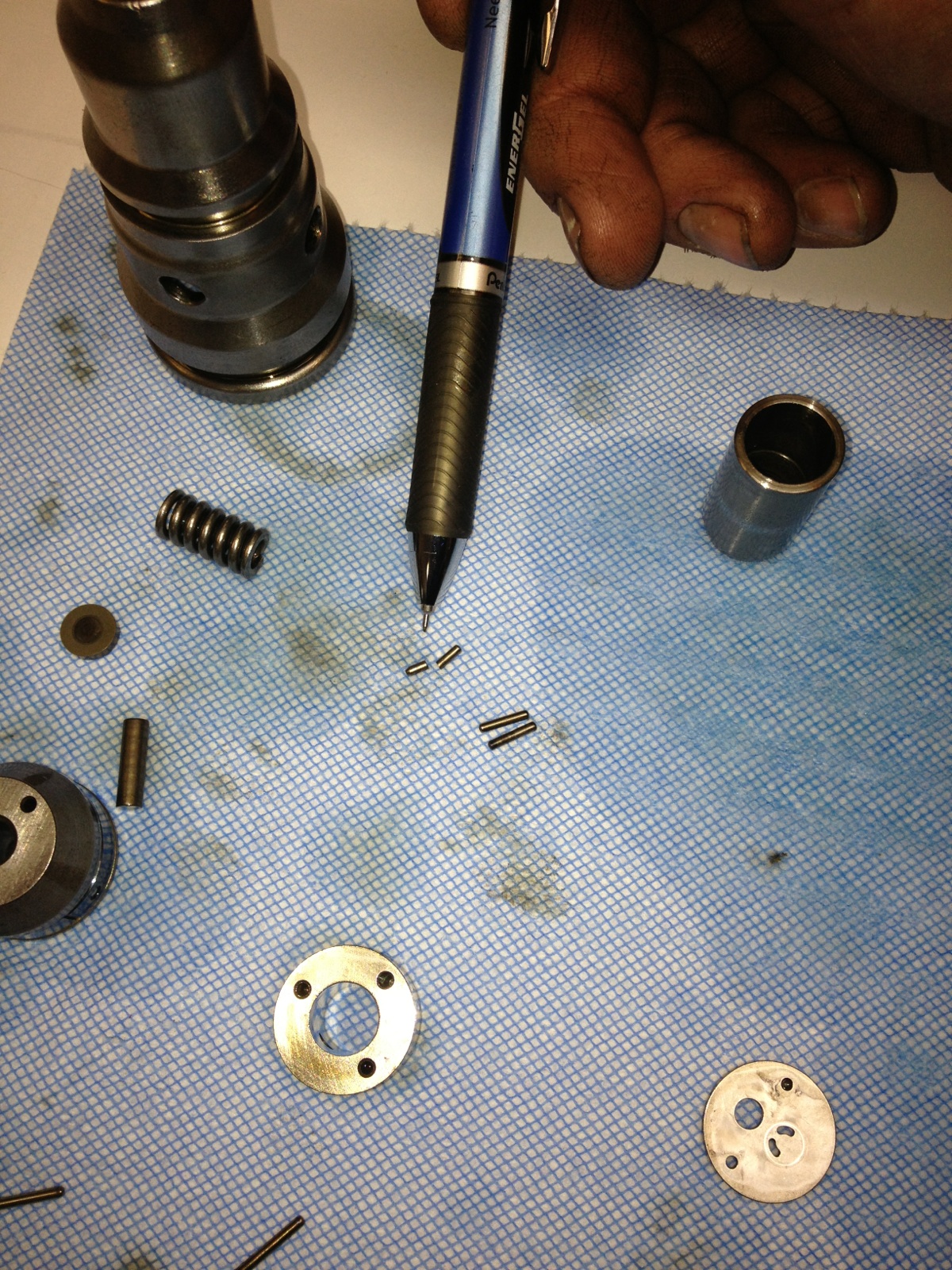

After just a couple weeks I was driving home from picking up my father in law at train station. Coming up a slight incline the truck started bucking like crazy. The only thing that would smooth it out was downshifting and running around 2500 rpm. It was a holiday weekend, but I called Wes. He said if I could limp it home, to get it home then have it towed to his shop. It was really great of him to come into the shop on a holiday to figure out what was wrong.
He was able to diagnose that Injector #8 wasn't firing. Luckily Wes builds injectors too, so he has all the tools and knowledge to know what he's looking at. Turns one dowel pin in injector #8 was totally sheered and the other 2 bent. He also noticed some damage on the injector cap, but was able to replace the pins, replace the cap and get the injector going again.
For the number of injectors Tim builds I'm chalking it up to sh!t happens, but it's how a business owner handles it that matters to me.
Tim got me a replacement injector in the mail quickly, but it's still sitting in the box until I have a chance to go back to Wes to have it installed. I'm still out a couple hundred bucks of labor for the injector that went south, so I'm hoping that in the end Tim or Jody make it right, since it wasn't my fault an internal piece of the injector failed. But we'll see.

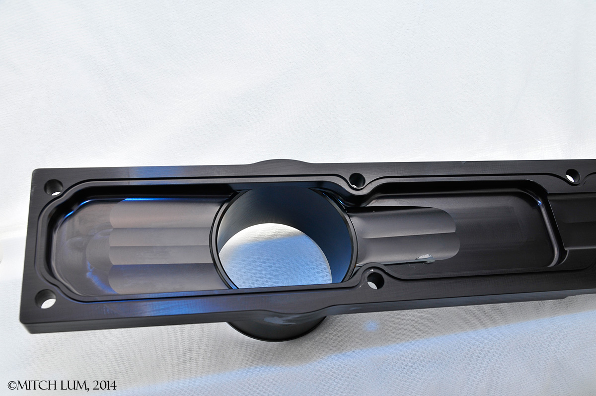

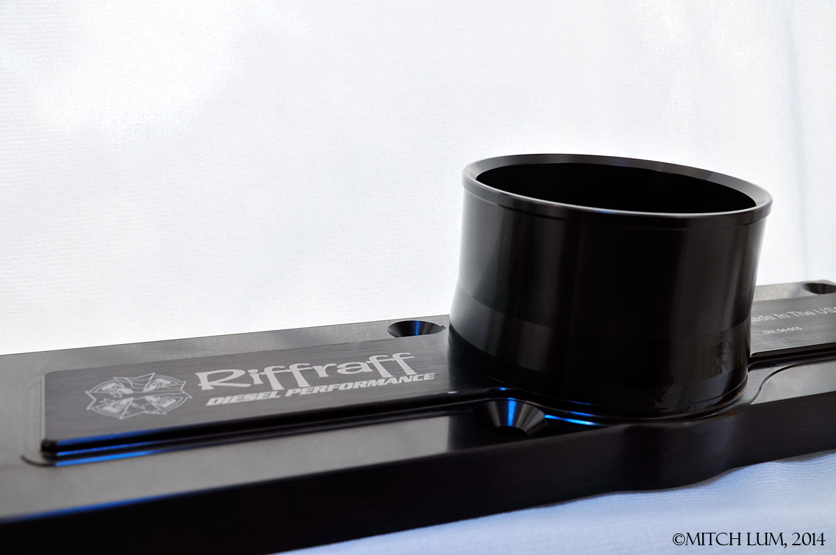

Since I'm converting the E99 set-up to T4 I needed new intake tins. One option was to just fine 99.5 or later intake tins. Another option was Jake's. But having bought a couple items from Clay at Riffraff over the last year, and seeing from the pictures how nice they were, I went with his. Of course, Clay is ridiculous, and even if I order in the afternoon, seems to be able process, pack and get things on the UPS truck on the same day.
These aren't installed yet, but I took some photos for "eye candy". These intake manifolds really are truly an amazing piece of machining. Seems like every detail has been attended to.

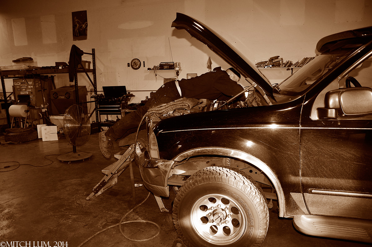

Spent most of the day at DFI Performance today :) A LOT of great work got done. I have a ton of pictures, but this one says the most for me...out with the old.
~Mitch

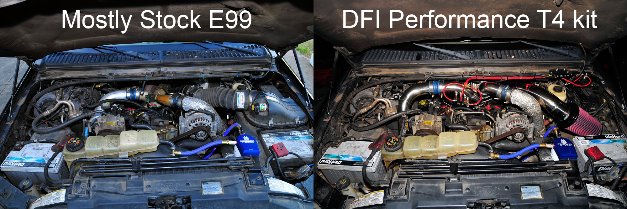

Yesterday was a second long day at DFI Performance. Wes actually got in early and started working on the truck before I got there. We got the T4 kit finished, installed a Snow MAX-MPG and changed me over from green coolant to red ELC coolant, engine oil change and front and rear diffs too since it was time.
Some engine bay porn below.
Before - basically stock E99 set-up with just a Donaldson AIS and Sinister coolant filter.
After - DFI Performance T4 kit installed. I think I'm the first customer to get one on, and the first automatic since Wes and Dan's trucks are ZF6.
Full review of what got installed later, but for now I'll just say the ass-dyno says it's pretty happy with the improvements :)
~Mitch
