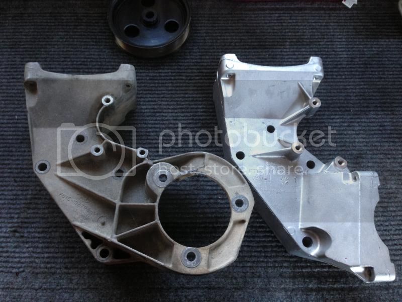

Parts needed 99-03 e250-350-450 7.3
Power steering bracket

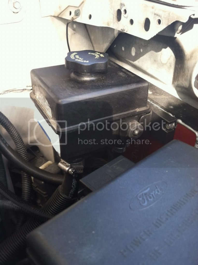

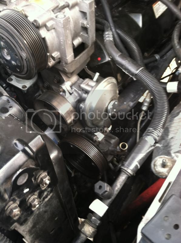

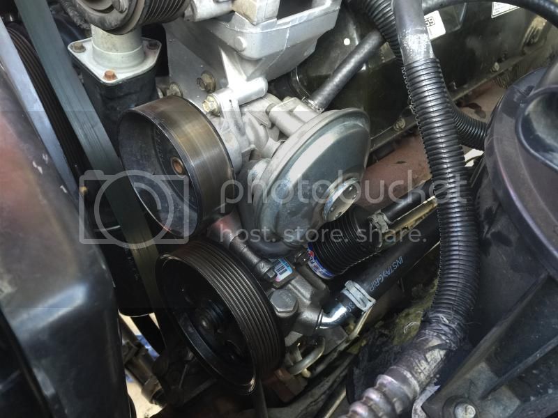

You can use the 6.0 f350 pump like I did if you want to the reservoir like I did in the pics or you can use the factory E series but will need to mount the reservoir up more by the ac compressor. I didn't have that room since i have a intercooler. You need the E series pulley also. It had a smaller shaft diameter than the F series 94.5-97
Power steering hose. This will need to be made. It's easy, however if you are running hydroboost, do not use the aeroquip stainless hose. It will transfer the noise from the pump to the cab. With a vac system there will be no noise. I am going back to rubber hose so the noise can't transfer up to the cab from the all metal lines.
I also used Lee mfg conversion fittings so I got rid of the ghetto Teflon seal and now have -6 hoses.
On to the pics. Sorry for the quick write up. Post up if you have any questions. I do have a few more brackets made if you want to do this conversion and use the E series power steering reservoir. I will sell them for what they cost me.

Van Power Steering Pulley is the only hard spot for this conversion, its obsolete and no longer available new. Its strickly a junkyard item off of a 1997-2003 7.3 E-series van. The 6.0 pulley will not work, its dimensionally wrong for the van pump/mount. No correct aftermarket pulley available either. Also watch out for pumps that are offered with pulley, they may not be the right ones.
The rest can be ordered new from dealers like Sunrise or Tasca Ford, found on Ebay or from RockAuto.
1997-2003 7.3 Van (According to RockAuto)
Van Power Steering Pump Motorcraft STP-122RM. There appears to be a bunch of other Ford/Motorcraft part numbers for this pump which makes doing a search a little strange. If you buy the pump off of ebay, generally there is no core charge.
Power Steering Pump Remote Mounting Reservior F7UZ-3A697-AB.
Reservior Mounting Bracket F7UZ-3A3490-AB. You have to figure out a mount. Got4wd made an adaptor bracket to fit to the IDM mount to hang the reservior bracket.
A/C Compressor Mounting Bracket F7TZ-19E708-BA. This has the A/C and 6.0 style power steering pump mount on the drivers side engine bracket, unlike a SD engine bracket.
Hoses have to be custom made.
All of this information is from Got4wd. Jerimiah said he does have some bracket/pump/pulleys he can sell for his cost.
