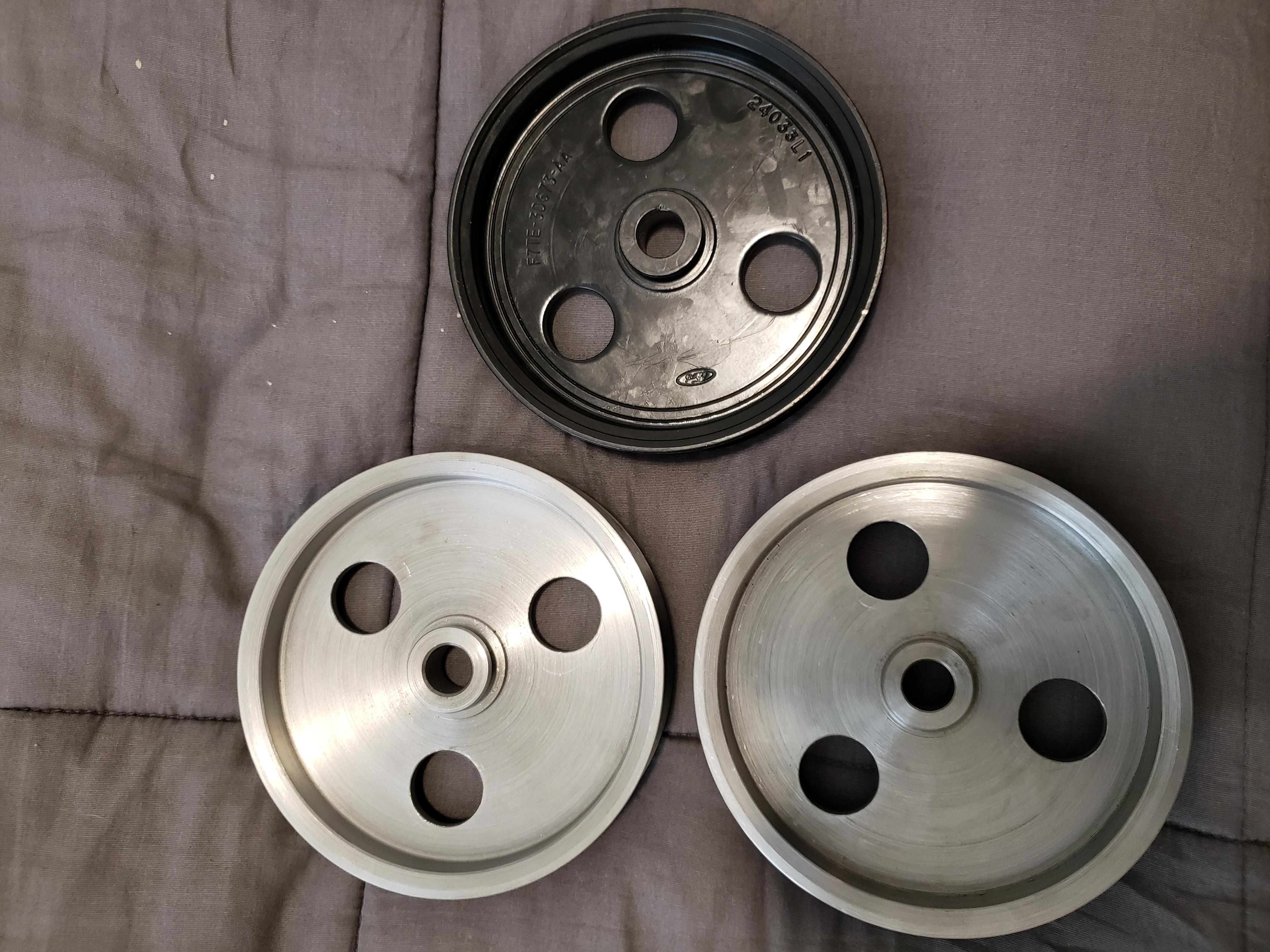

Hey guys, I have found a source where you can get the pulleys for this swap. I managed to find one of the original ford pulley's, and before I put it on the pump I went to my local cnc machine shop so they could mic it out and make copies. I had them make two additional pulleys for me (I like to have backups) and I asked them to keep the measurements on file so they can make more in the future. It wasn't cheap, but if any of you want to do this swap and can't find the pulley's at the junkyard feel free to give them a call and they can make them for you. You don't even have to send them an original to replicate because they already have the measurements on file from me. It's Pressworks Maximum in Forney, TX. (30 minutes east of Dallas) Call 972-564-4229 and ask for the power steering pulley, the phone will ring through to Amy 24hrs. They do a lot of small orders for obsolete parts so they can do other stuff too if you send them an original to measure. I'll post pics of the finished pulleys too.

Here is a pic of the original next to the two copies. One is upside down to show the rear.

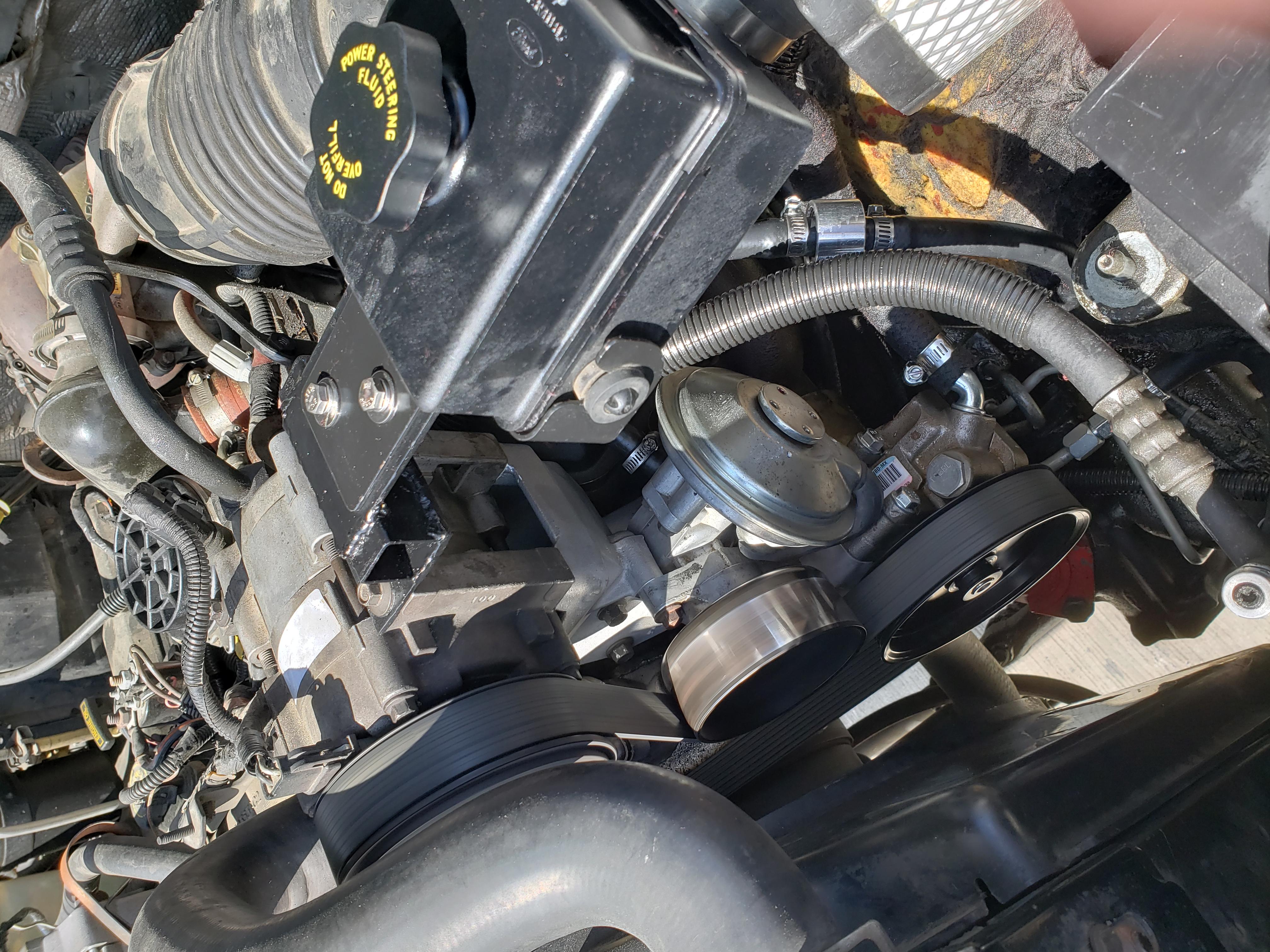

Some pics of my finished project. I can definitely feel an improvement. I don't have hydroboost so I just welded together a custom bracket and mounted the resevoir next to the ac compressor. It all went together very nicely. Big thanks to Got4wd for all his help!!
