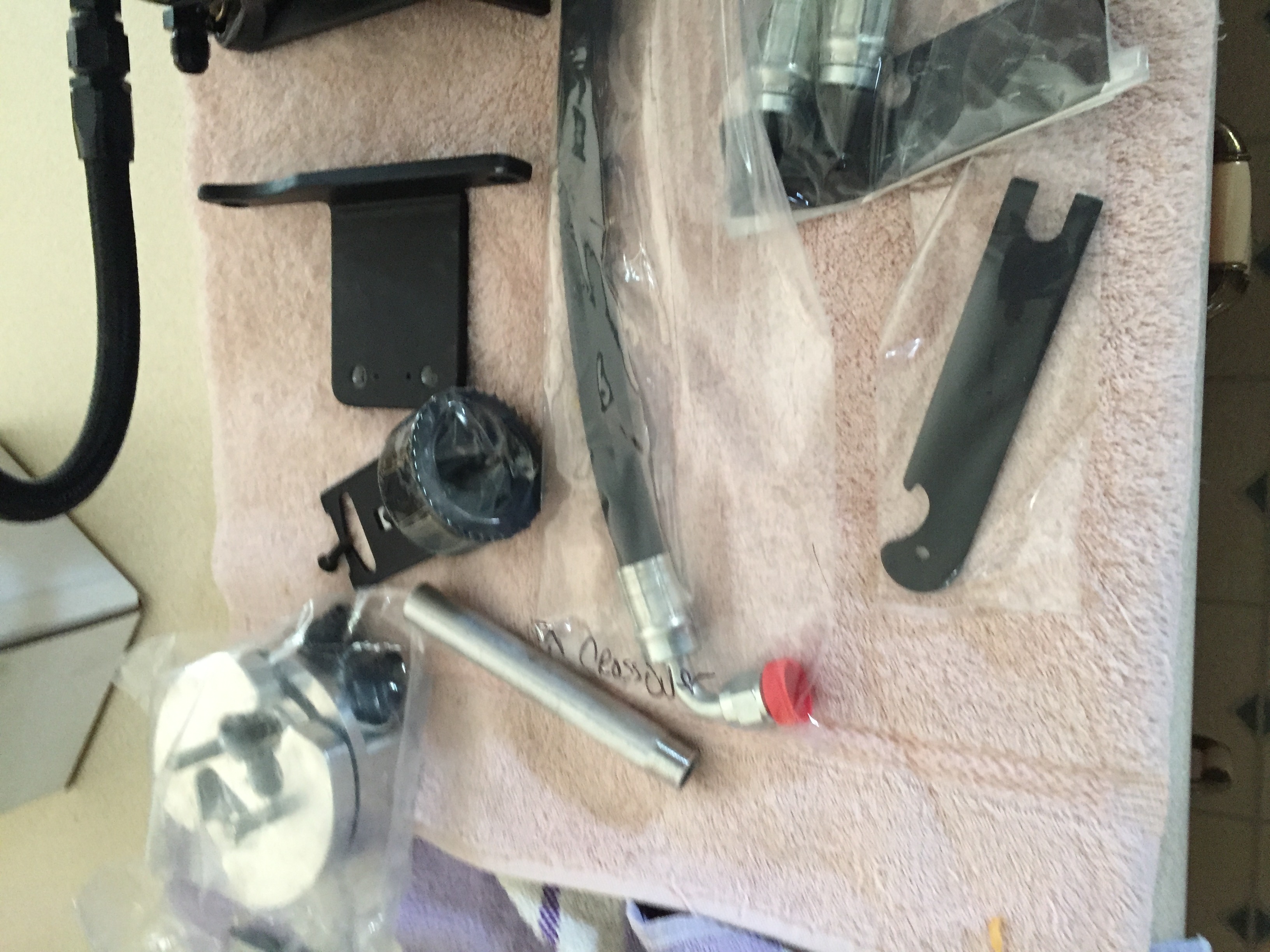

powerjoke73
Oct 5, 2015
307
Some misc. parts including my TS chip, HPOP, and fuel system components. Dont have pictures of much else.
