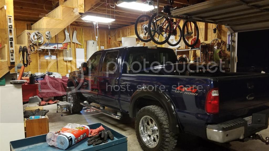

Well, after spending about a week cleaning out my shop enough to get the truck in, it has started........ It will be slow going as I only have evenings and weekends to work on it though.
kleake
Jul 6, 2016
430
Sapulpa, OK

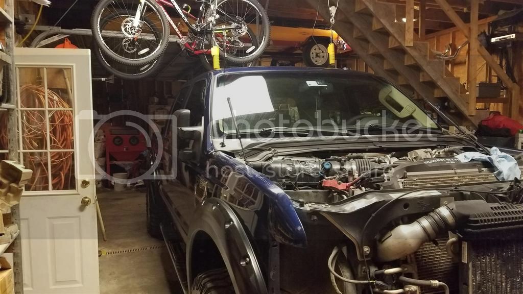

Not too much new to report, everything is step by step as the manual states. I had a couple of extras, but everything is now undone and ready to lift except for one thing. THOSE CAB BOLTS ARE A PITA!!!!!!!!!! Can't use an impact on them, so get a LONG breaker bar and get ready to wear yourself out! They turn hard all the way! I thought about putting my 1/2" cordless drill on there once I had them loosened up,,,,, ha, not even close to enough power! Then I got out my old trusty 1/2" electric drill that has gear reduction. That thing will snap off drill bits and not even phase it,,,,,, but I forgot that it's so old it's not even reversable! So, I wore myself out on the first 4, and will do the next 4 tonight and then lift. Definitely the hardest part so far, everything else was really pretty simple.
kleake
Jul 6, 2016
430
Sapulpa, OK
4 1300lb hoists is the plan. One on each corner of the cab, you can see them hanging from the rafters in the picture. They are mounted to share the weight across 2 rafters each. I'm guessing the cab weighs in at 2klbs so around 500lbs each. I plan to lift it, roll the chassis out from under it, then lower it down to the floor so it's not suspended for too long at a time.

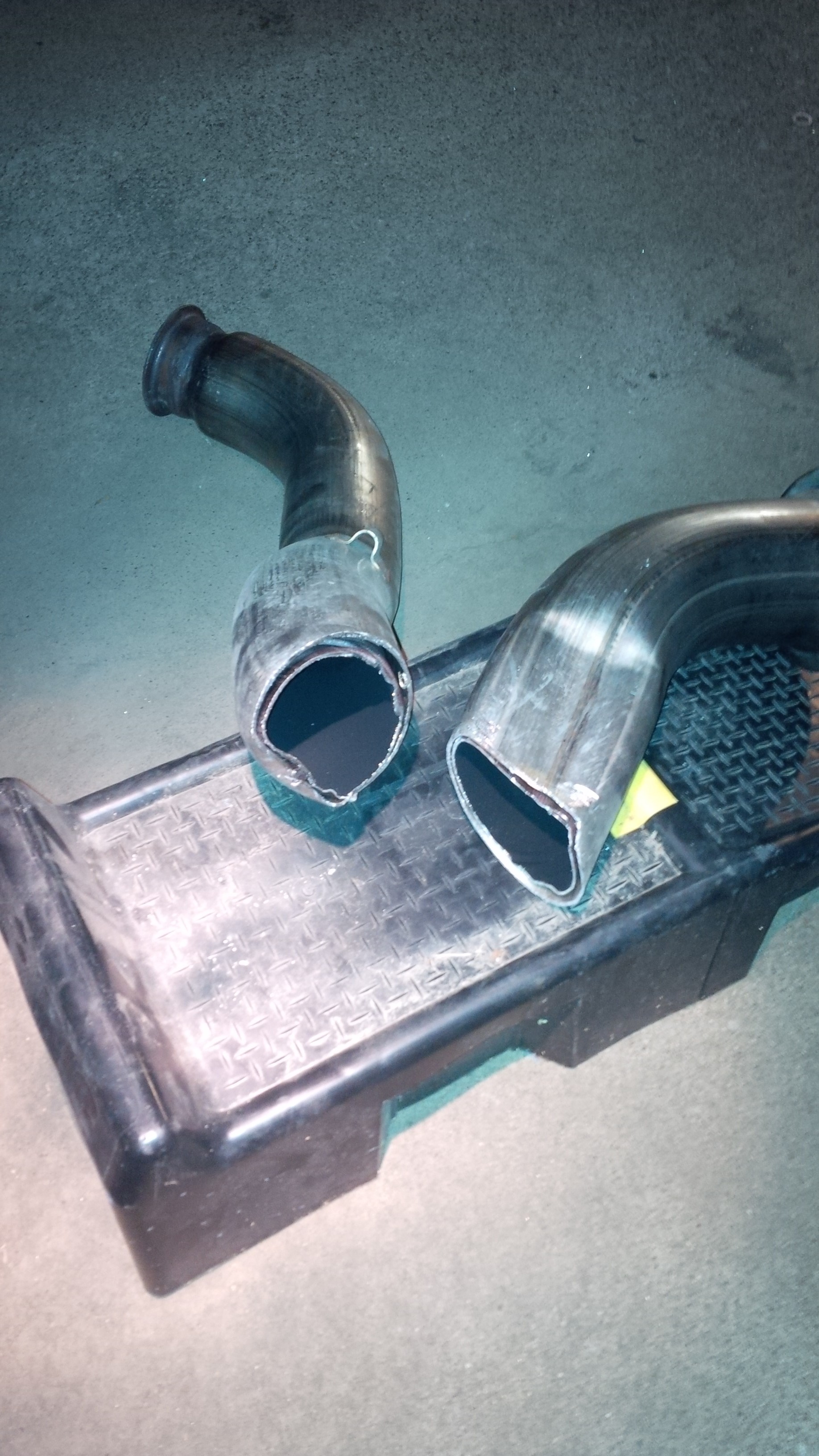

How much improvement is really gained with downpipe and full exhaust vs. hollowed stock with stock muffler?
Here is a picture of mine once I chopped it in half, it really does not flow well. Granted I do not run a race tune or anything, I noticed it took longer for EGTs to climb and it allowed the turbos to sing. It is double walled from the factory for heat retention to help with the under cab emissions components. A better flowing air intake will drastically help airflow into the turbochargers too, the Nolimit one is the cheapest and easiest solution.
That is the stock downpipe right? If so, this definitely would be a good time to address that. Any brand recommendations? I've got an Air-Aid filter in the stock box and added a few holes in the lid for better flow. Definitely did the job.
