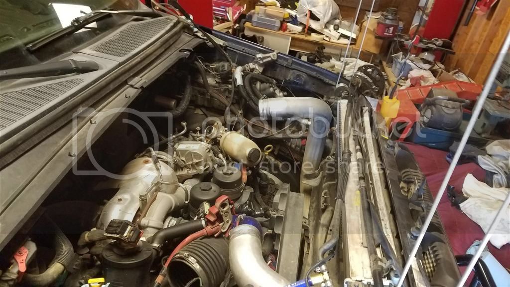

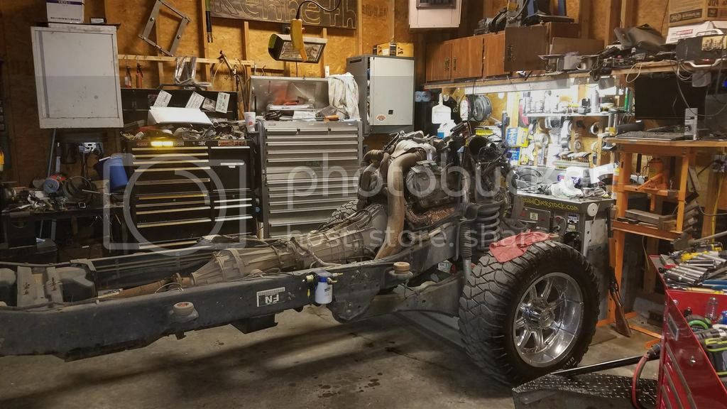

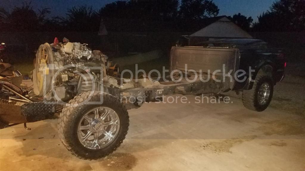

I've been a little under the weather the last few days so I haven't made much progress, but the cab is now in the air. All is good, only one wire pulled in half on the passenger side. I didn't see the connector, and didn't see any wires pulling until it was too late. I'm not sure what it goes to yet, but I think EBP sensor. I'll look once I move the chassis, I don't want to stick my head under there with it hanging like that.
So far not too bad, just takes time to make sure all is unhooked where it needs to be.
The front 2 hoists don't seem to have much load on them at all, they just lift easy. The rear two definitely have a load as they aren't instant on and kinda spool up a little. I don't think it's anywhere near their limit, but definitely more load than the front.
kleake
Jul 6, 2016
430
Sapulpa, OK

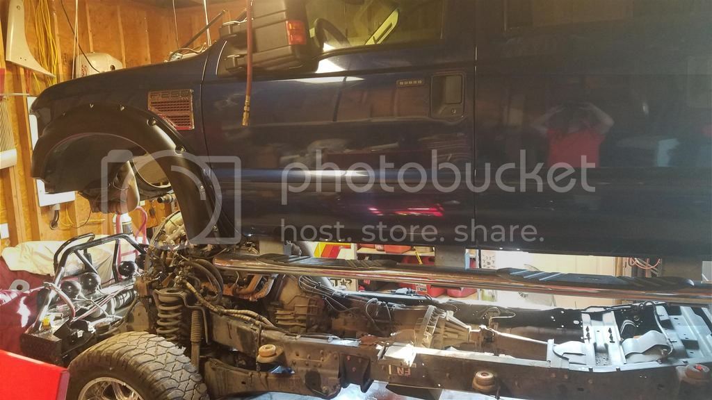

Well, the way I see it, you work with what you've got. It didn't want to give a shop $3k just for doing the gaskets, and this way I can spend that $3k on other parts. I don't have a high enough ceiling for a lift, nor the space on the floor (my shop is 24x40), so the hoists seemed to be the best option and it worked pretty well. I lowered it back to the floor after the chassis was out of the way just to be safe.
She sure looks different:
Turns out I do have a turbo seal leaking. A LOT more than I thought:

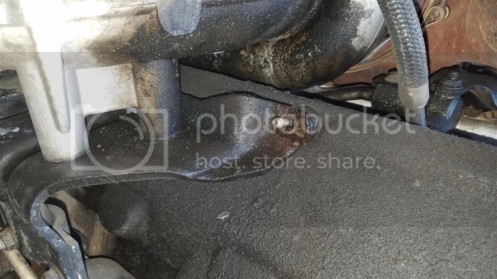

Front left turbo bracket, stud on valve cover broke, and the rear didn't have a nut on it.

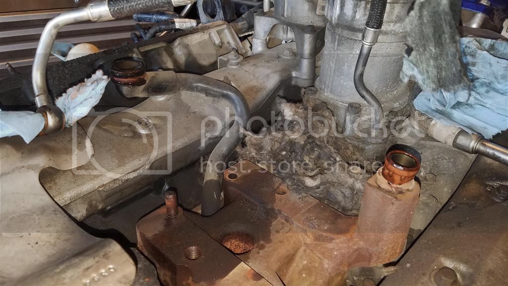

Found this fuzzy stuff under the turbos. Factory insulation or part of a rats nest?

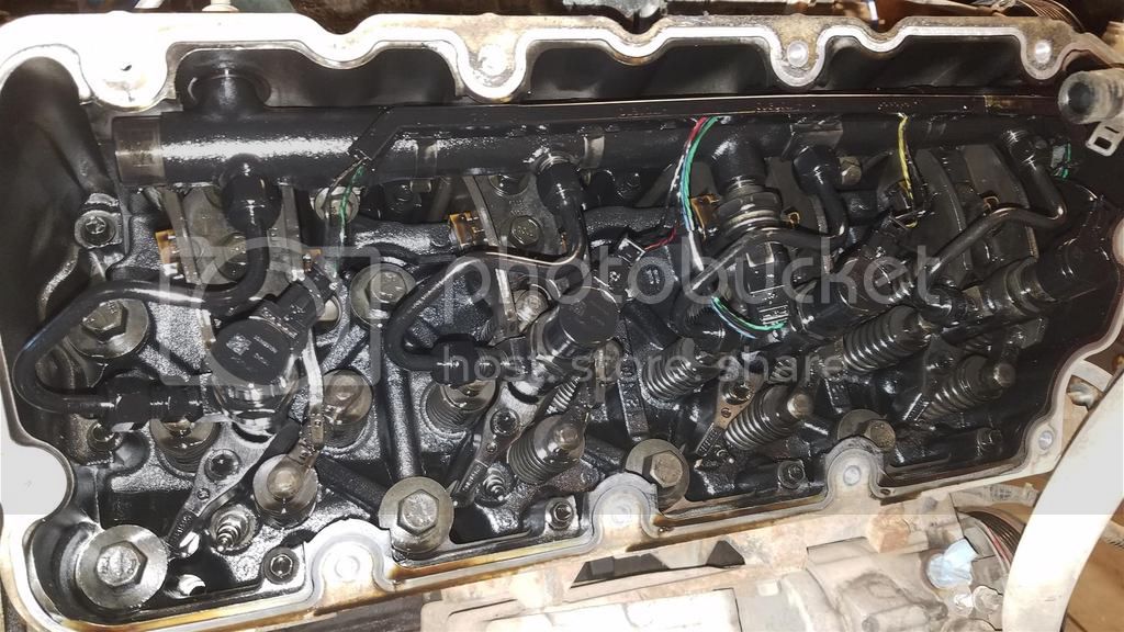

Just a view under the valve cover. All is pretty clean for 220k. No sludge or grime and no visible wear on any rockers, valves or anything that I can see.

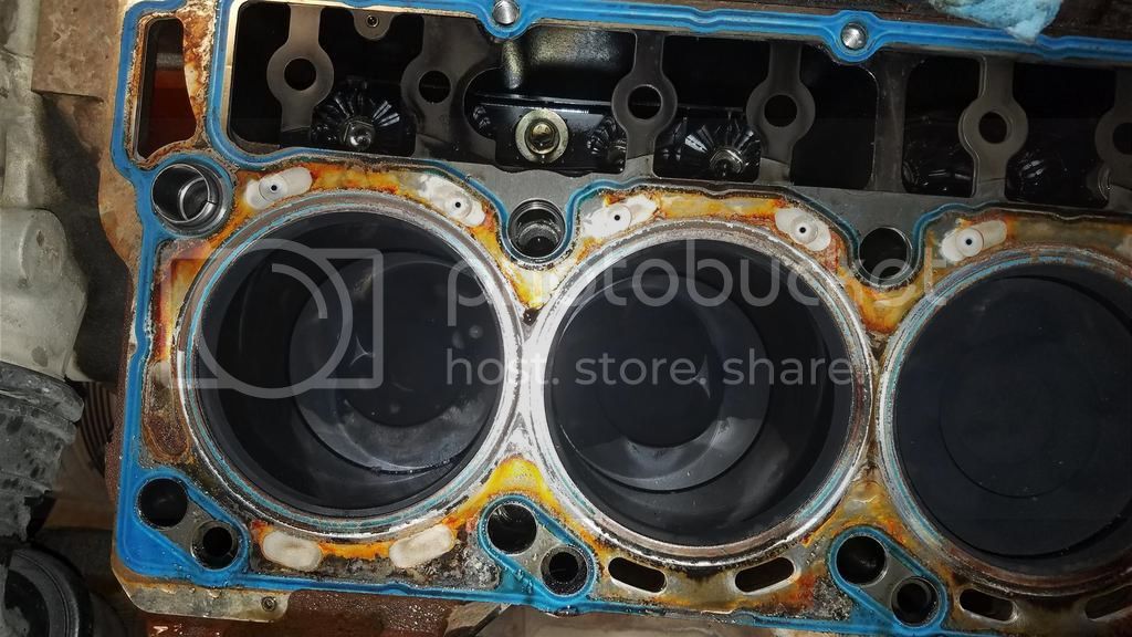

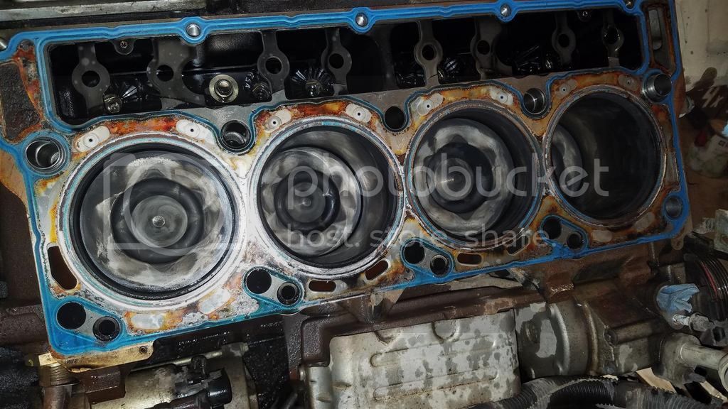

Bottom of the head on the passenger side. It's visible at the exhaust side of the center cylinders (upper section in pic). No visible damage, cracks, or other issues. We'll see if the machine shop finds any issues, but they say they have never seen a 6.4 head that wasn't cracked.
Small portion starting to leak on the front cylinder on the drivers side, otherwise the center two are the same as the passenger side.
Passenger side pistons are pretty clean and good injector patterns everywhere.

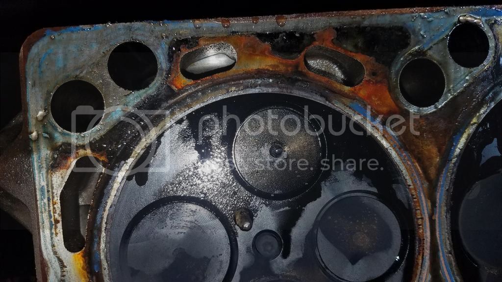

This is the spot that was leaking on the block surface. Should be simple to clean it up. Just a small carbon lip at the top of each cylinder wall, everything else looks great. I haven't fully inspected it yet though, since it was late when I got the heads stripped and ready for machining.

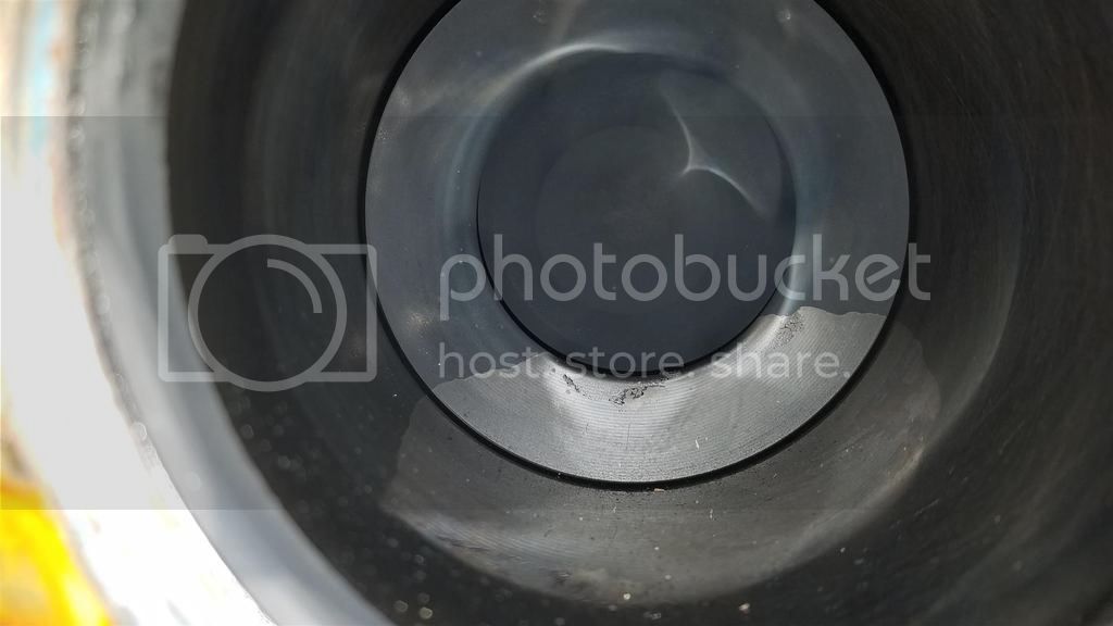

This kinda puzzled me. Driver side, second piston from the front, why is the bottom of the piston so clean and no carbon is stuck to it at all. Also, the coating on the surface of the piston looks to be flaking off? I'm not sure what to think of that.
Otherwise, same visible signs of the gasket leaking on the center two cylinders.
