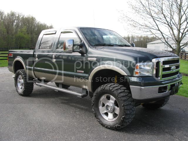

Here was the 2006 when I first got her

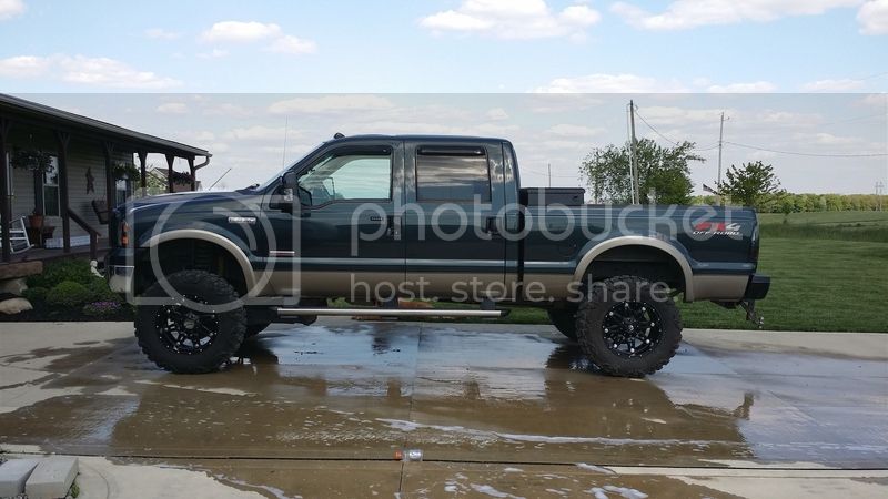

And this is what she morphed into right before I traded it in (note, ended up ptm rear bumper, replaced running boards with black ones and ptm front bumper but didn't get a picture of that beforehand :()
That don't even show all the mods done under the hood and truck...

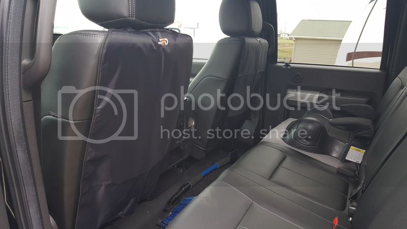

Second mod was to add kick protectors to the back of the front seats. I have 2 boys, and they love to put their muddy boots on the back of the seats for some reason...
Got them off Amazon...cheap...

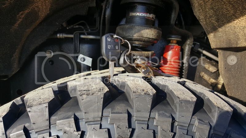

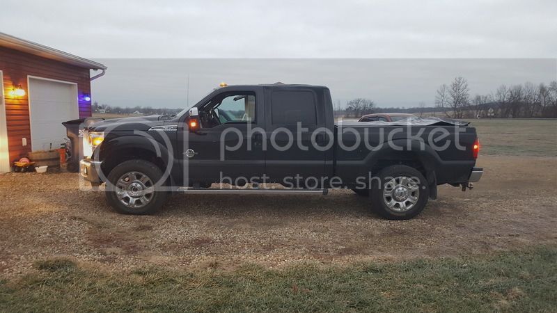

Installed a 3.5" Readylift SST kit.
Before:
Front End
Tire Pressure - 80psi
41-3/8" ground to fender edge
Rear End
Tire Pressure - 62psi
43-3/8" ground to fender edge
After:
Front End
44-7/8" ground to fender edge
Rear End
44-5/8" ground to fender edge
Replaced the rear 4" blocks with 5" block that came with kit.
3.5" spacer lifted the front.
Kept the stock Rancho shocks for now.

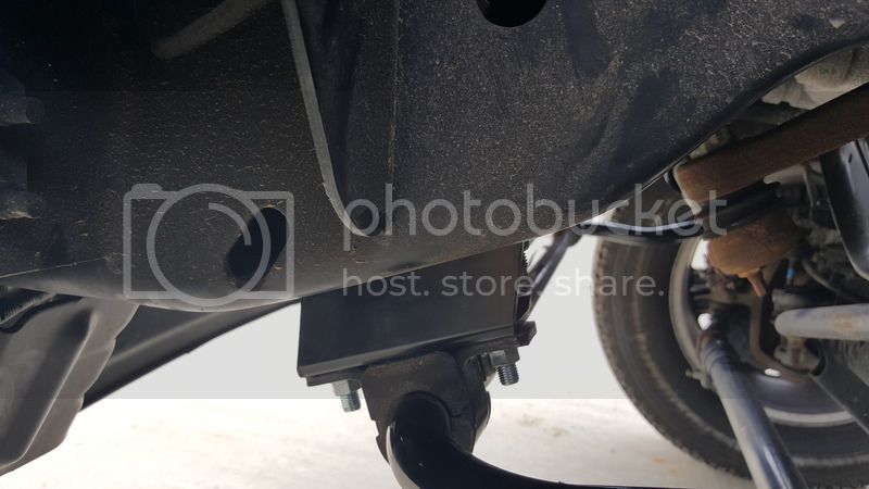

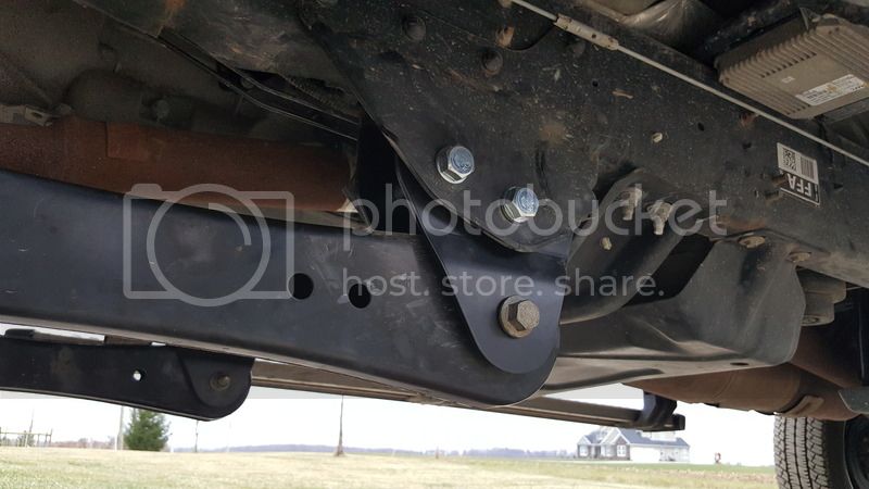

Sway Bar drop brackets
Track Bar Re-position Bracket and Bump Stop drop bracket

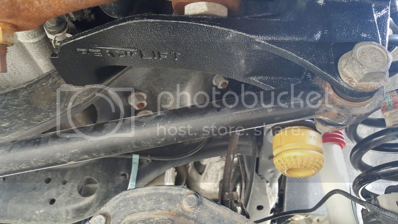

Radius arm drop bracket.
Not happy with not being able to put the plastic ABS clip into the radius arm. Would think they would supply in the kit an extension clip or something. Will have to fab up something myself I suppose.
Install time...5 hours

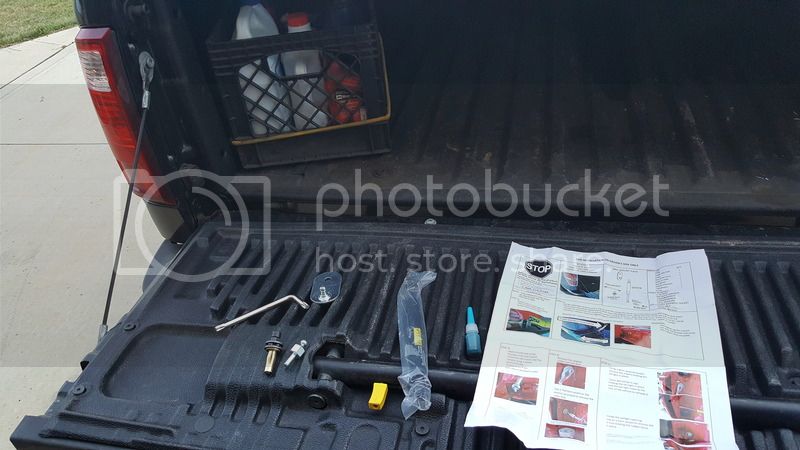

Monday 12/5/2016 Update:
Something small arrived on my porch yesterday, so before it got too dark, decided to install it.
I was afraid to just let go of the tailgate the first 3 or 4 times I tried it out. But...I think I'll get use to it.

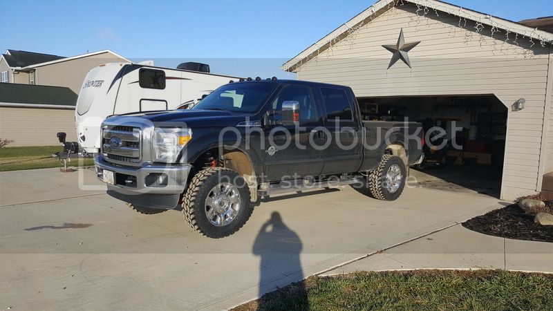

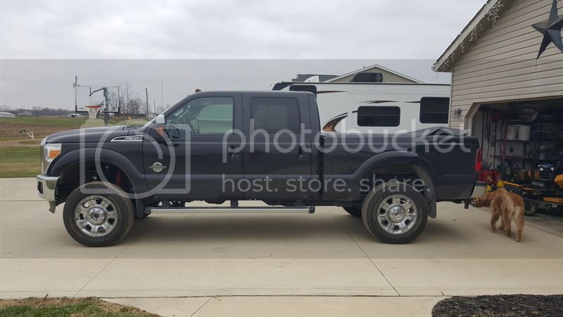

Update:
Shoes were put on today.
Before:
Got some slight rubbing on arm at full lock on both sides. Will need to deal with the ABS wire asap before it gets pinched/ripped.
They make some noise on the road, but nothing like the Nitto Grapplers I had on my 6.0L. These are manageable in terms of noise for sure, I can hear me think!
