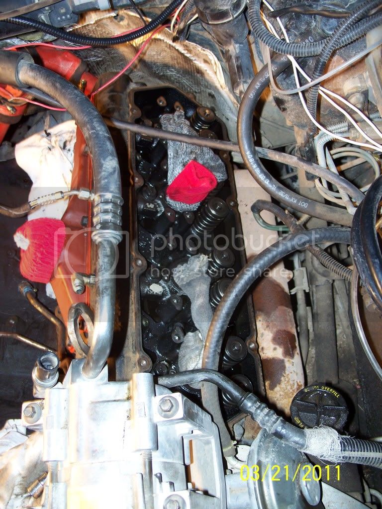

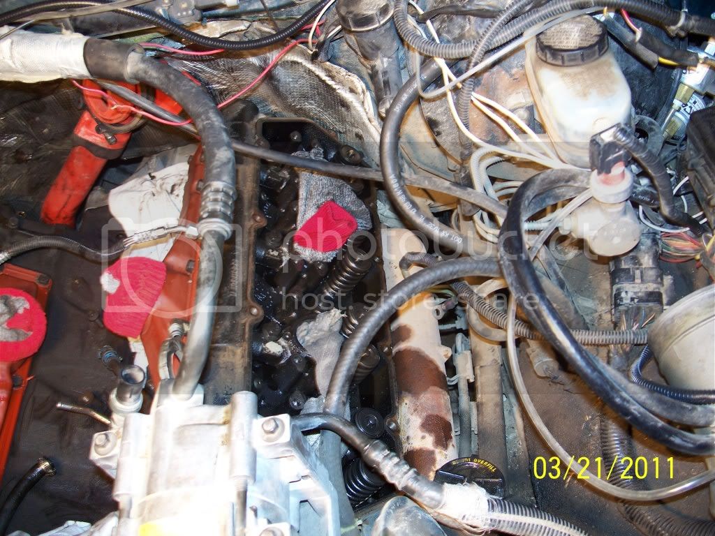

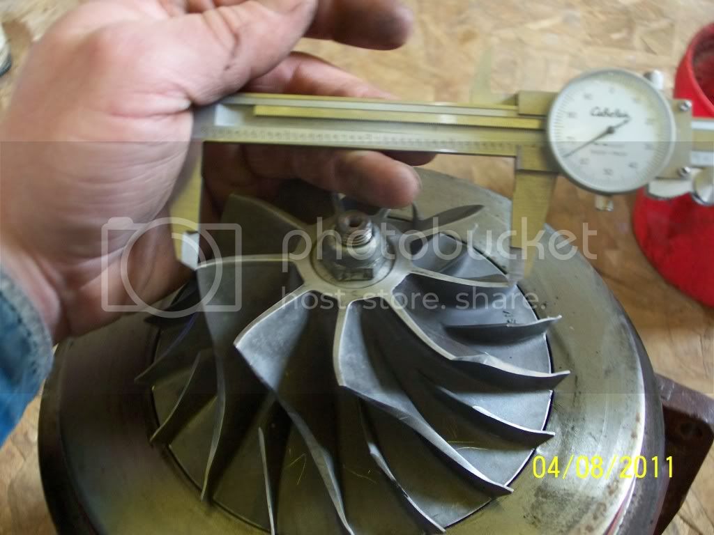

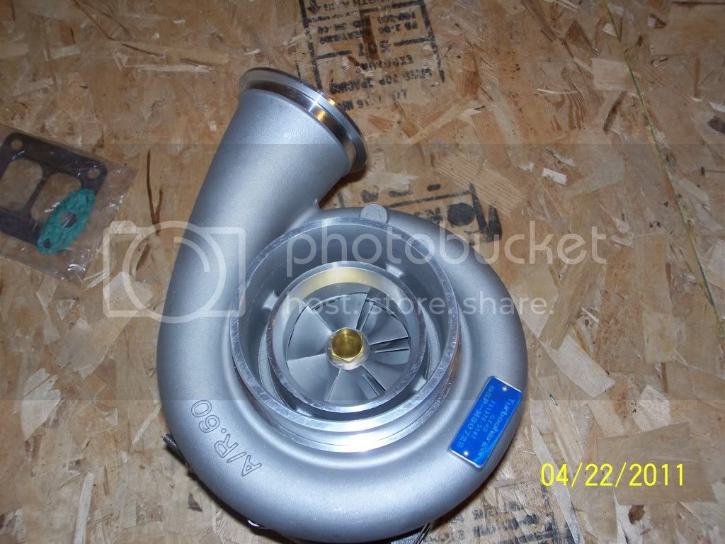

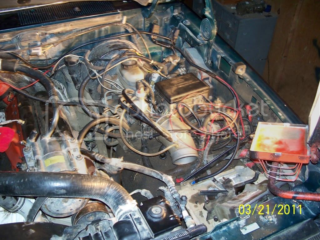

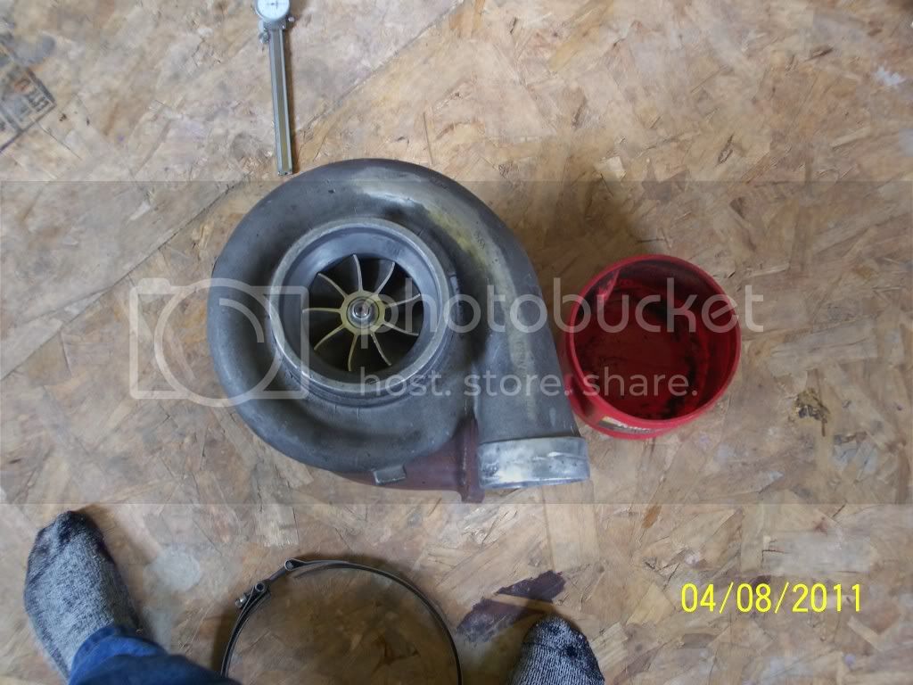

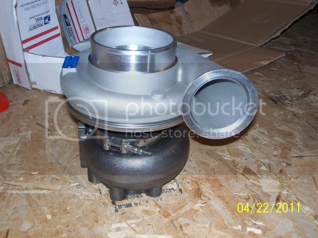

Here are some pictures for yall to look at of the thing a have and of the things i have done.

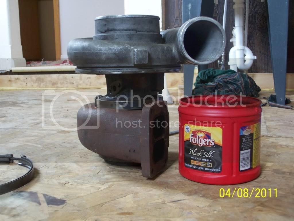

GT42

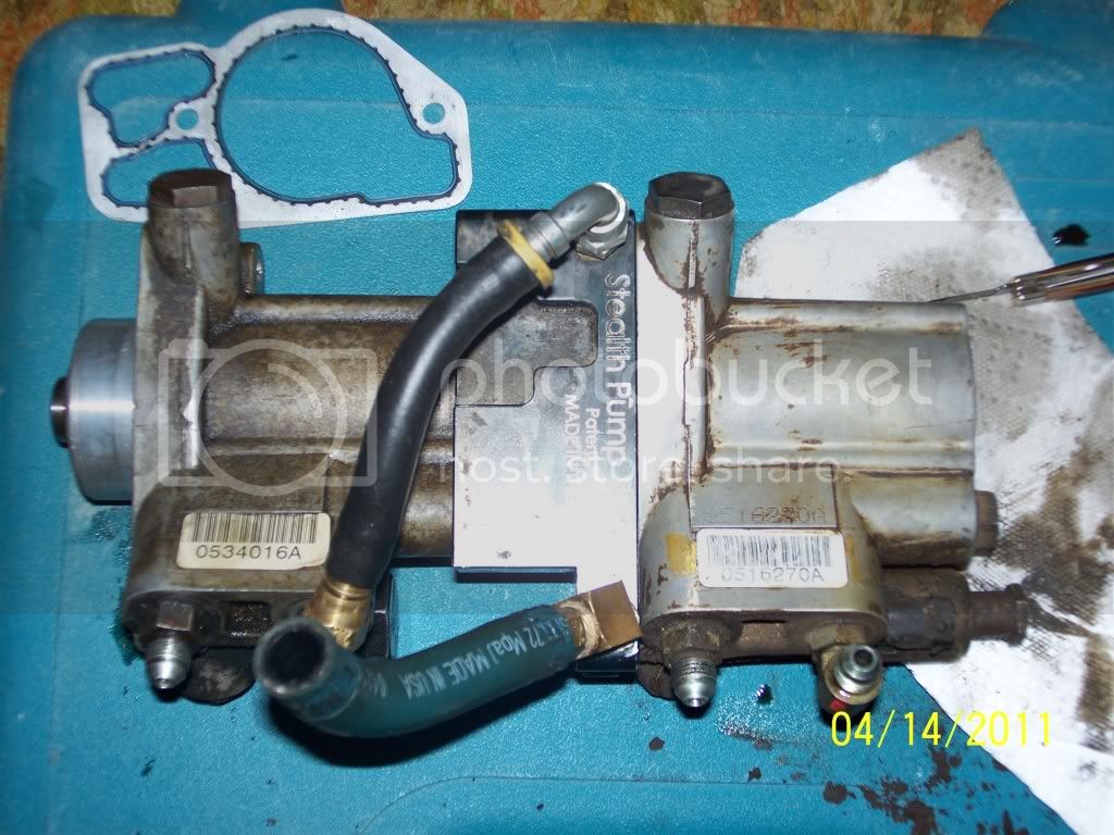

Stealth twins and SD Plenums
new IPR

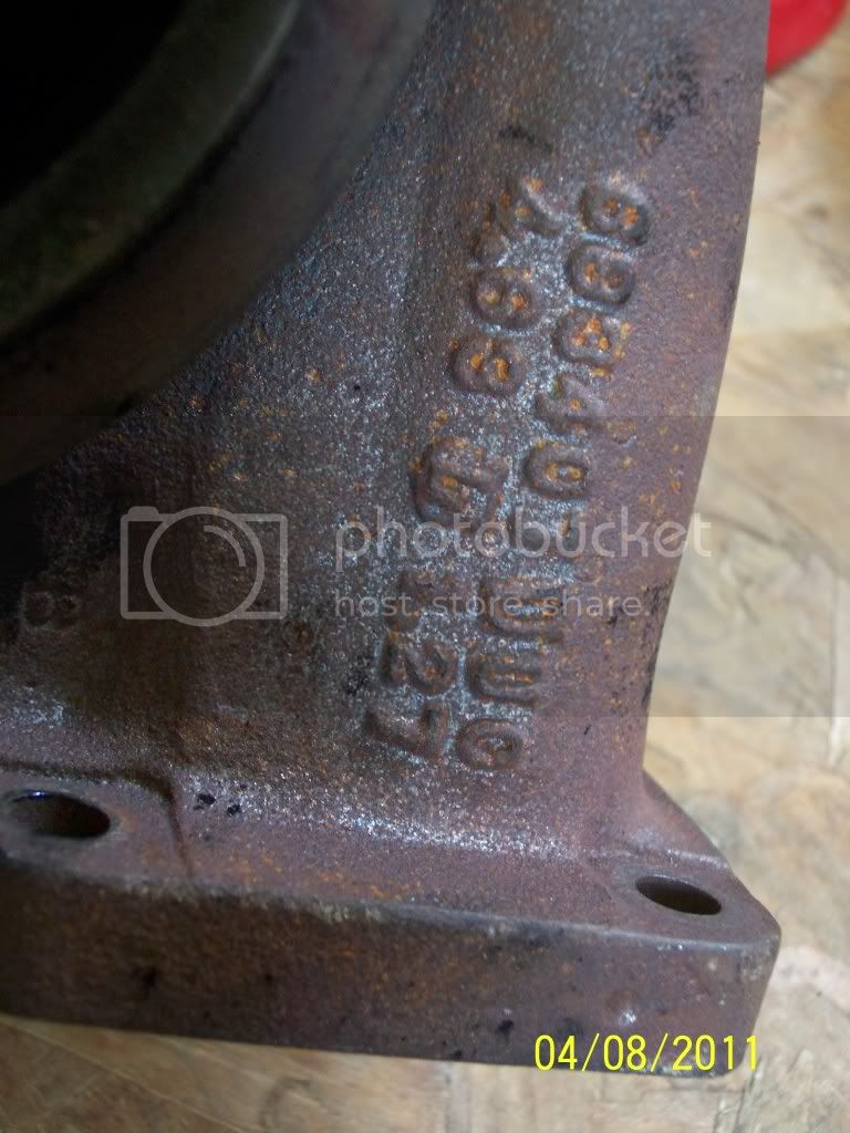

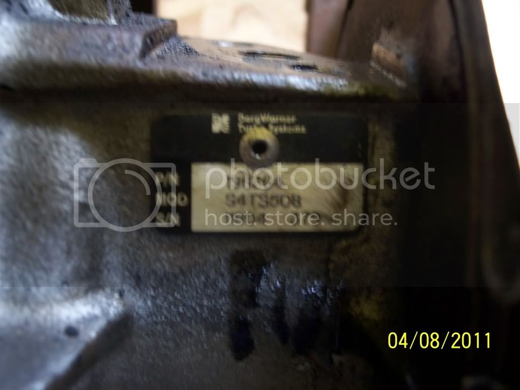

S4T turbo
ARP Head studs
Old injectors
More to come

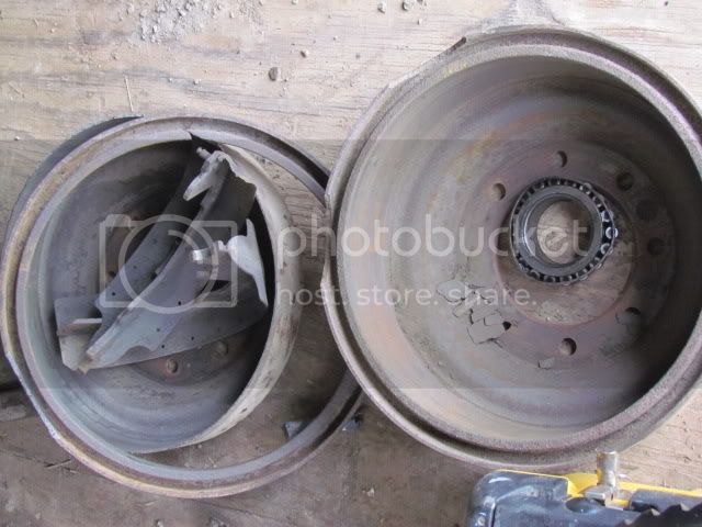

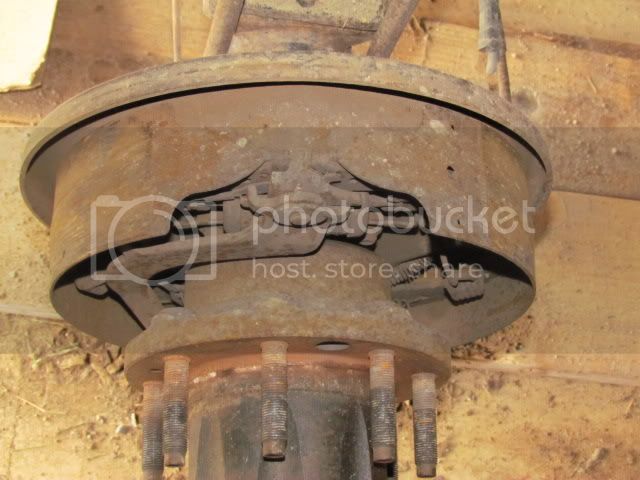

Besides i have the bed off right now and the rear axel tore apart.. I am doing lockers front and back and changeing the gearing out to 3.55s, and changeing all the seals and bearings in the front and back axel. and I am doing the brakes front and back to.. one of the back drums was in two pieces and both back brakes had no pad left on the brake shoe most of the metel on the brake shoes are gone to!!

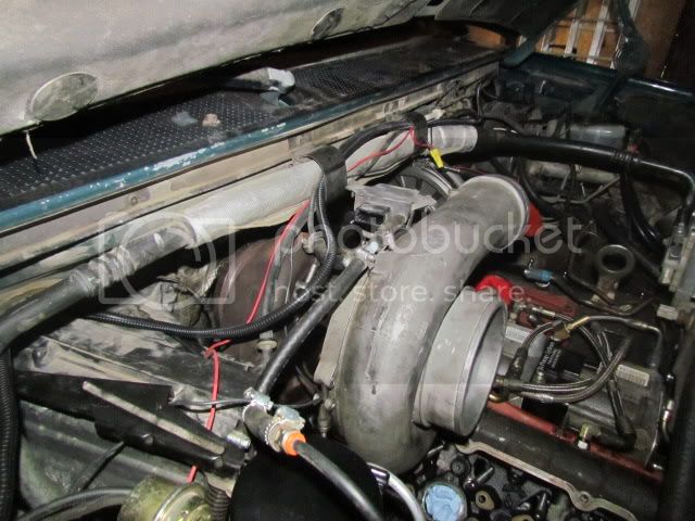

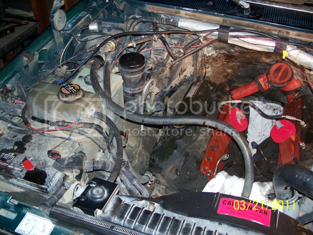

here is what i am up to..

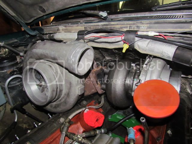

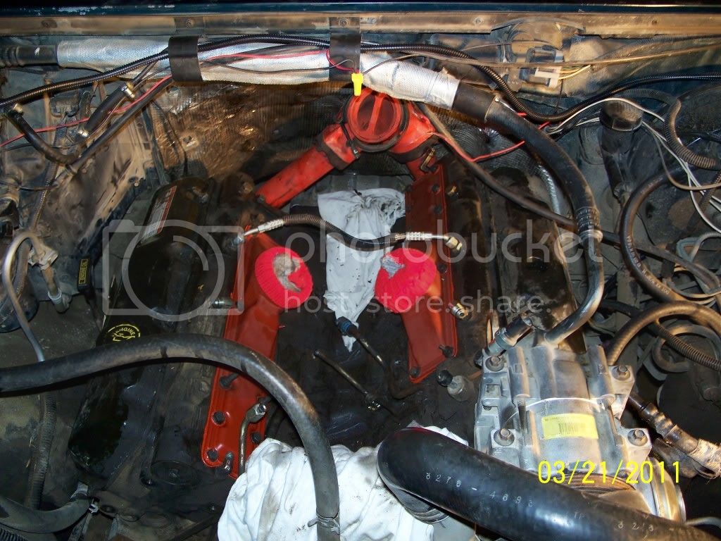

this is about were the turbo will sit, just about one inch higher.
I still need to finish the mount for the second turbo it is almost done though!!
My brakes are shot

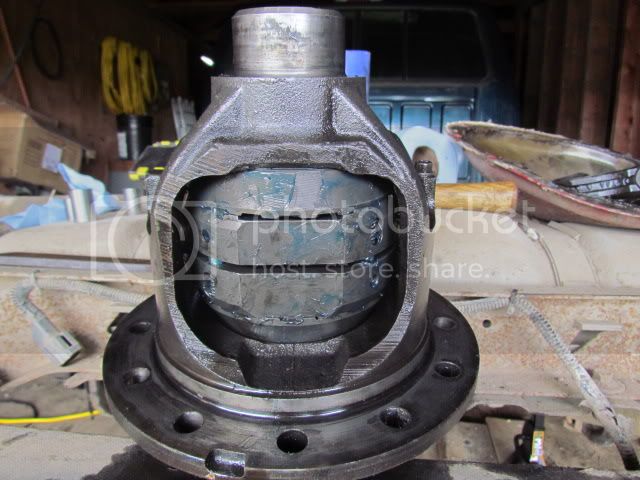

The LS differantial and ring gear..
The new locker instaled in the Ring gear housing.
I will be doing the same thing to the front axle. new brakes and a locker.. new bearings and seals..
