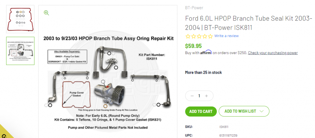

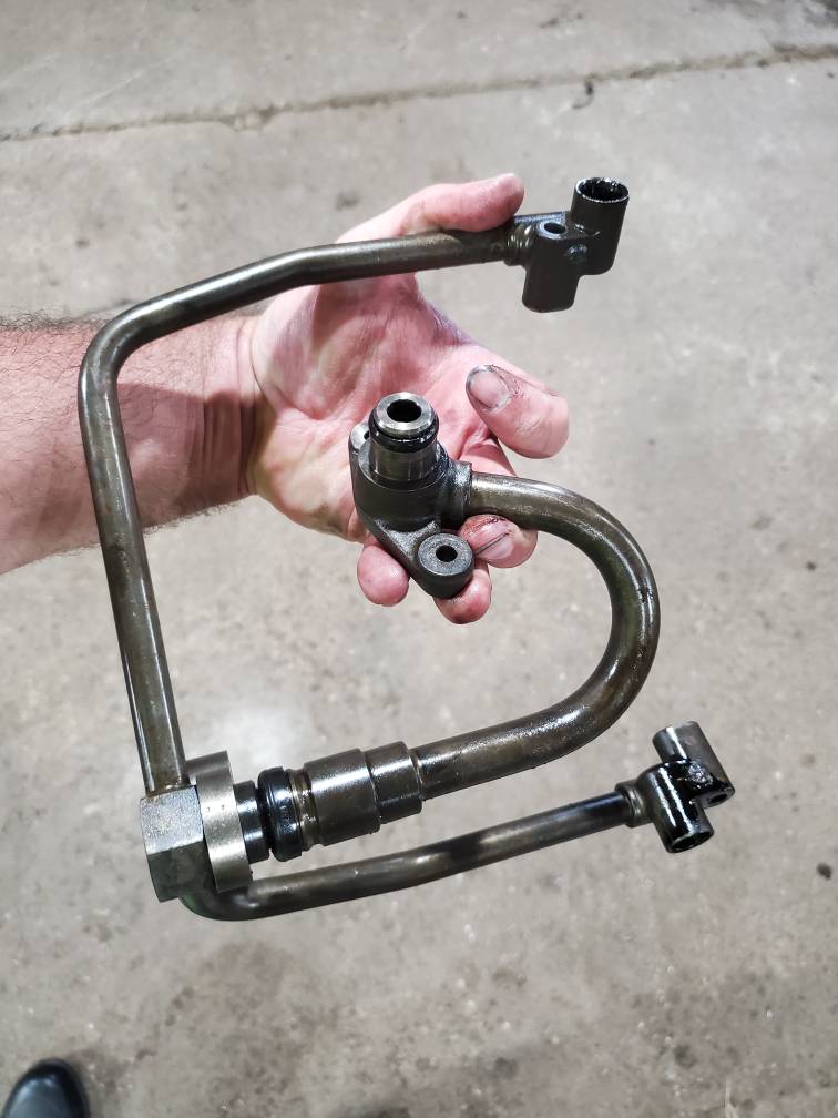

Is there any o-rings on these branch tubes that can he replaced(other than the mounting o-rings)? Or is this just a clean and reinstall piece? Thanks.

I replace the entire j tube when I do a pump. There are o rings in there and I have never been able to source them
Ok, I figured there was some type of seal in there that could fail. Do you have a part number or link to a new one? I'll do some digging to see if I can find it as well.
I found them. No need to look for me. Thanks.

Were you getting a new J-tube or looking for individual J-tube o-ring part numbers?
The updated design J-tube part number is 3C3Z-9T288-AA (comes with the internal viton o-ring, teflon backer ring, and metal retaining ring.).
@DEEZUZ gave good advice - change the J-tube with any HPOP work.
I like these threads to contain the part numbers posted so people doing searches can find the answer (not having to re-create the work).
If you have found individual o-ring part numbers it would be great for you to post them, with their description.
For '03's that don't have the updated HPOP cover, it is a good thing to have: It is part #3C3Z-9G805-AA

Bismic, thanks for the part numbers. In my searches I haven't found just a o-ring kit. All I'm finding is the j-tube with o-rings as deezez said.
Quite the cost difference between aftermarket and oem. But I think I'll stick to oem.

J tubes have all o rings installed. They even give you a bonus outlet d ring
