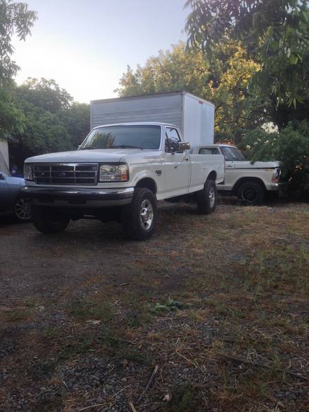

On your 97? Any pics? What rear blocks, if any? I'm curious of ride height compared to mine. I spent quite a bit of time out in Chico this last summer and fall.
Yes on my 97. I have stock f250 rear blocks but i have rear springs from an 03. I'm not sure which code leaves they are. Front is about 2.5 inches lower than the back and the front measures around 22.5-23" from center of axle to fender. I'll try to get some pics for you.

285/70-17's with 4400's Front springs and stock 2in block and rear springs from an 03 f350. Sorry about the truly horrible pictures.
