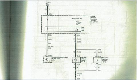

The fog light circuit got a lot of changes during the years, and it's not the same as laid out in the 2003 service diagrams as it is on my 2003 truck. I played with this circuit on both my '01 and '03 trucks so I could have the fog lights on with highs.
One of the things confounding you may be that Ford utilizes an embedded relay for the fog light control over some years, embedded into the CJB that is not replaceable, it is soldered in. Without having the specific diagram for your production date would be hard to do.

The ground is the G100 (black wire). Firewall drivers side IIRC.
Power is supplied through the CJB relay connector C270h (TN/OG wire).
You can pull the fog lamp connectors C152 and C162 and turn the fog lamp switch on ..... see if there is voltage between the power wire (TN/OG) and the battery negative terminal.

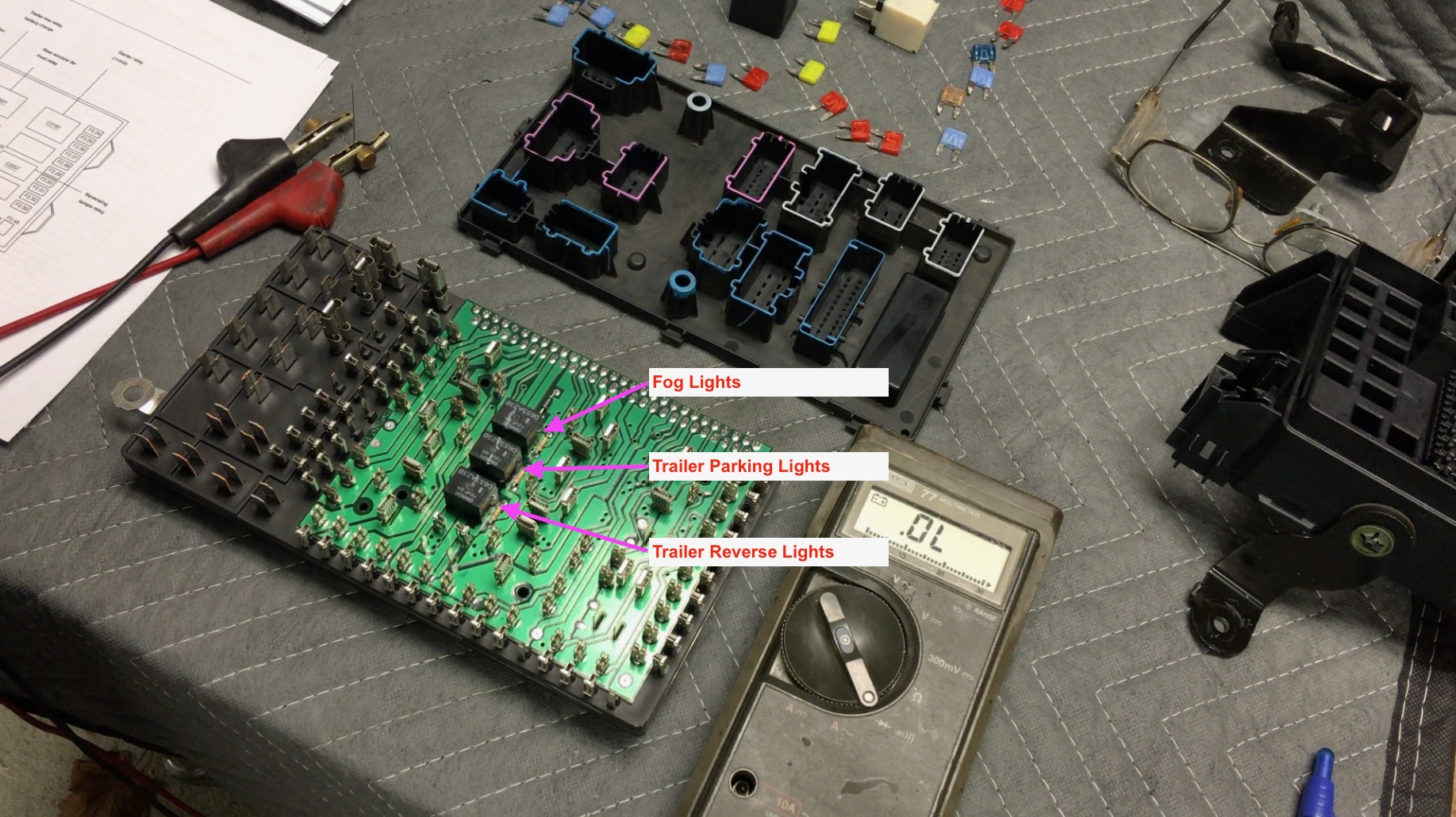

That relay, along with a few others, is built into the CJB or Central Junction Box (fuse panel under the dash on driver's side):
Fog Lamp Relay
Fuel Pump Relay
Horn Relay
Trailer Tow Parking Lamp Relay
Heated Mirror Relay
It is considered a non-serviceable item and, if bad, Ford will recommend replacing the entire CJB.
bismic
Jul 3, 2011
342
9
The best thing to do if you STRONGLY suspect the relay is to just cut the wires to/from that particular relay and add one to the wiring external to the CJB. If I have some time, I will try to look up the connector number and wire color.

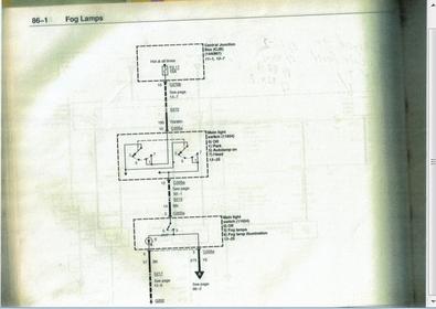

Mark gave you how to test the switch. This is the location

Sorry it so long to post these
