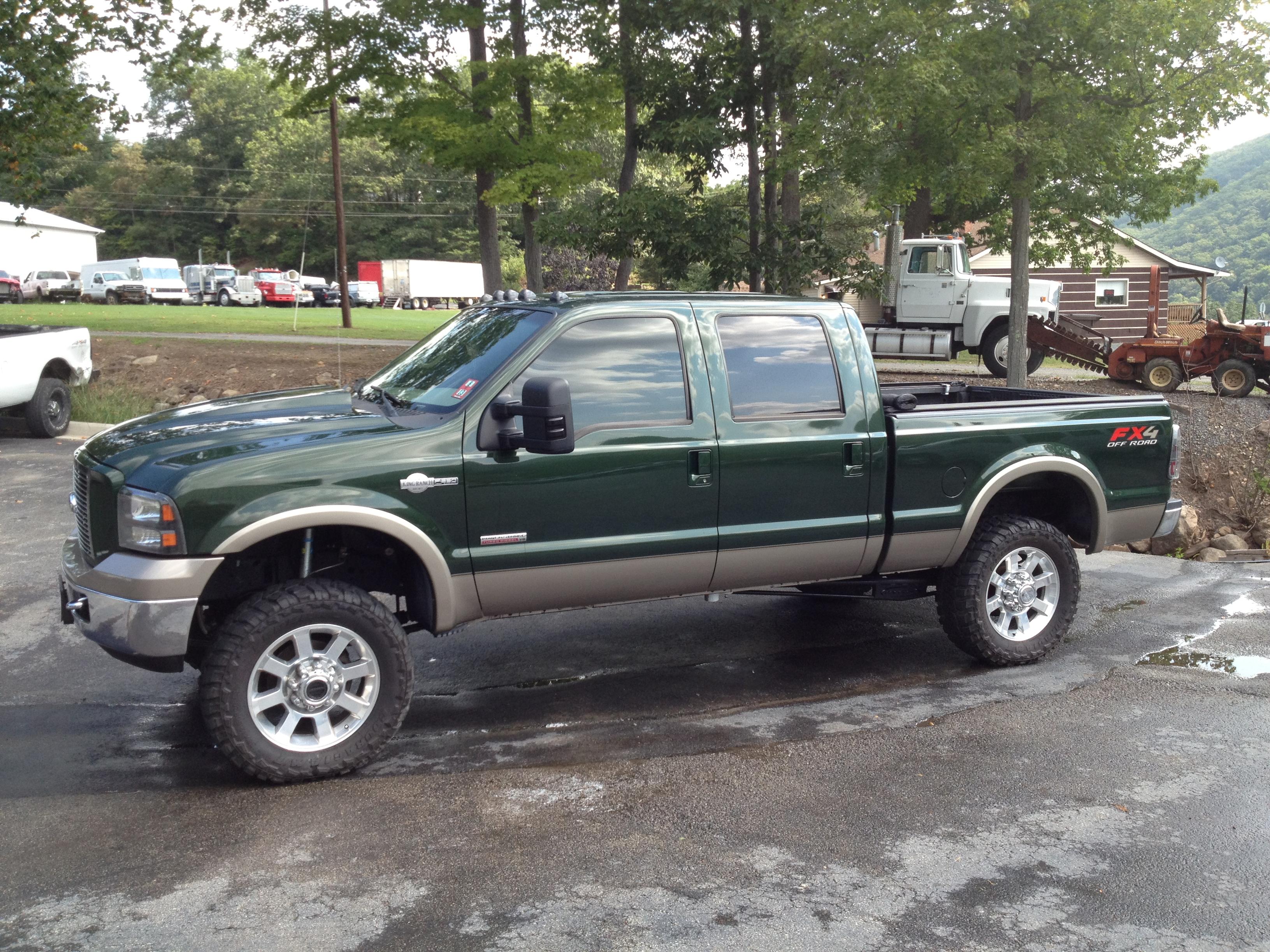

I'm pretty sure you will need wheel spacers or the tires will rub on the leaf springs. I new a guy that did it and it rubbed but did look good. I'm sure somebody on here has pics.

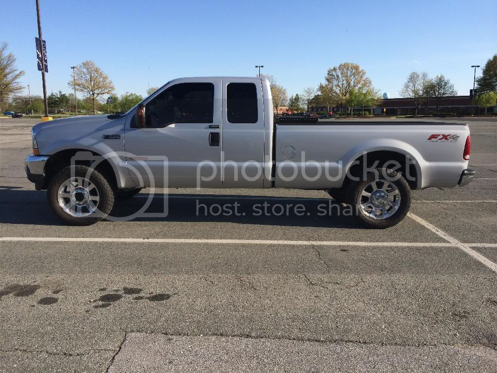

Thank you sir. Pretty pleased with the look. Was worried it would look weird mixing and matching different years but with the 05-07 front end it will look nice I hope.

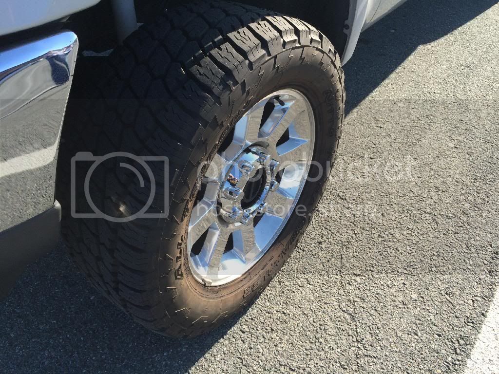

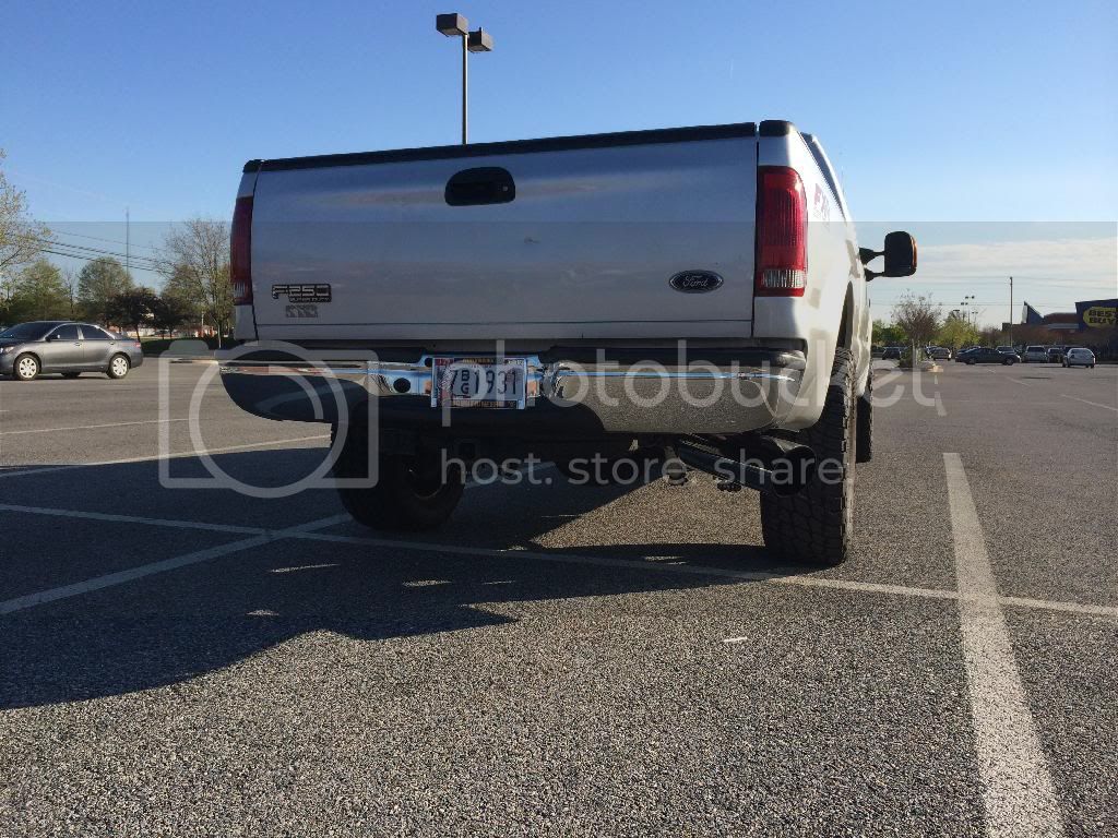

Thank you. I will tell you I can not get this thing to ride smooth. I'm chalking it up with possibly being the tires being ran opposite than they were cause the shop didn't pay no mind to where each tire was but also worried the spacers may be causing it. For you that run them are you using hub centric and not just lug centric?
That looks awesome. What size tires? I may get some spacers to get mine out of the wheel well some even and I have a 08. Maybe I just need a wider tire.
Your supposed to be running hubcentric with the newer factory wheels when you do this. Had many conversations and looking into this when I had a set in my basement waiting to go on. Lug centric messes it up because the wheels are setup for hubcentric.
