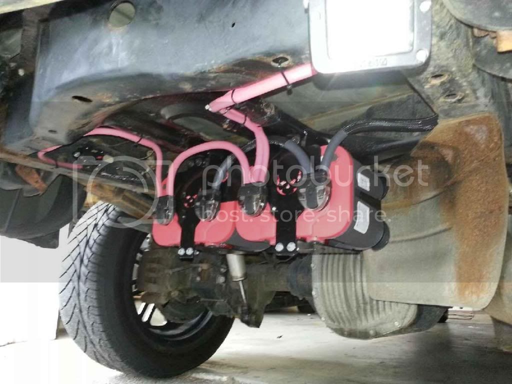

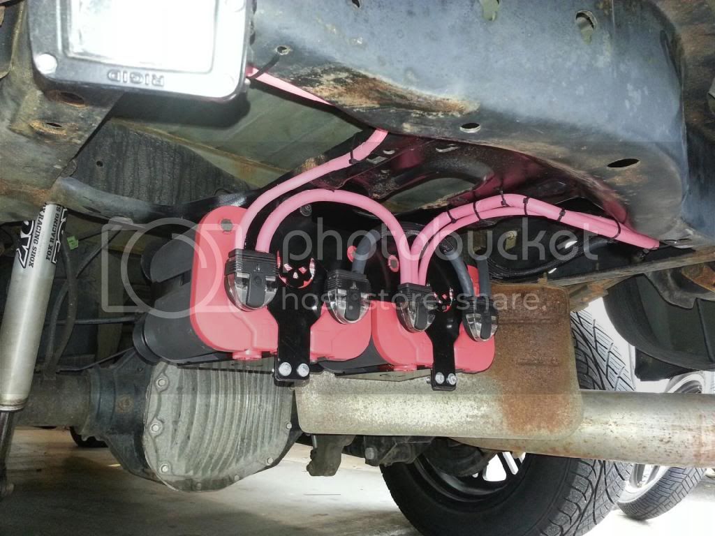

Got my truck back from getting the battery's relocated, turned out way better then I was expecting. Next up are the brakes and 4 links.

Kind
1,498
Those red tops will tuck up inside the frame as well instead of hanging down and in the open.

Good luck with your optimas. Mine yellow tops only lasted 6 months before I had to jump the truck off Everytime I started it. Went back to acid filled batteries and have had much better luck. Optimas aren't made by the same company anymore from what my battery guy told me.

My reds lasted me 5 years.

the air filter will be getting changed out in july when i get home, probably something like what Eric's running on his truck.
They hang lower than I would have liked but the truck will never be offroad so it doesn't matter.
I allready had the optimas and mount when you told me your experience in another thread.

ive never been around rust like that, sure sucks.
Batteries came out good i really like that weight is where it needs to be

Stew , man really looks sharp , so what's the plan for filling the space where the other battery was ? Another TURBO LOL !! You have an animal thats forsure very nice

I have a few plans for the future, for now I have a moroso tank that is made to fit in where battery's do that I am going to use for a windshield washer reservoir so I can fit a new filter set up.
