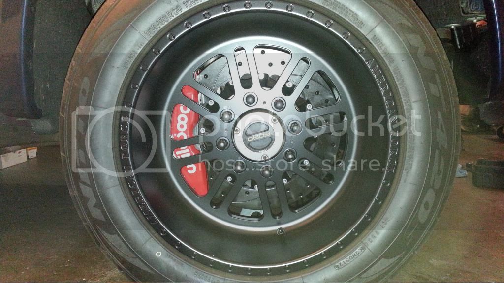

16 inch Wilwood brakes install
ingrahams
Nov 14, 2011
630
New Hampshire/Africa
It's close but they fit without modifying anything

Mine clear my 20's. Not sure why your having a problem.
The reason you have the clearance you do is that you have a TCE/Wiwood kit (the original) and not the newer factory kits being mentioned by the OP.
The TCE kits use a different hat and caliper. Both offer improved wheel clearance- the hat being deeper offset and the caliper body width being just under 1" shallower. All that combined (along with drilled/slotted rotors not available on the Wilwood factory kit) pushes the entire system closer to the engine: maximum wheel clearance.
There are, like all purchases, pros and cons to both. As we see here.
