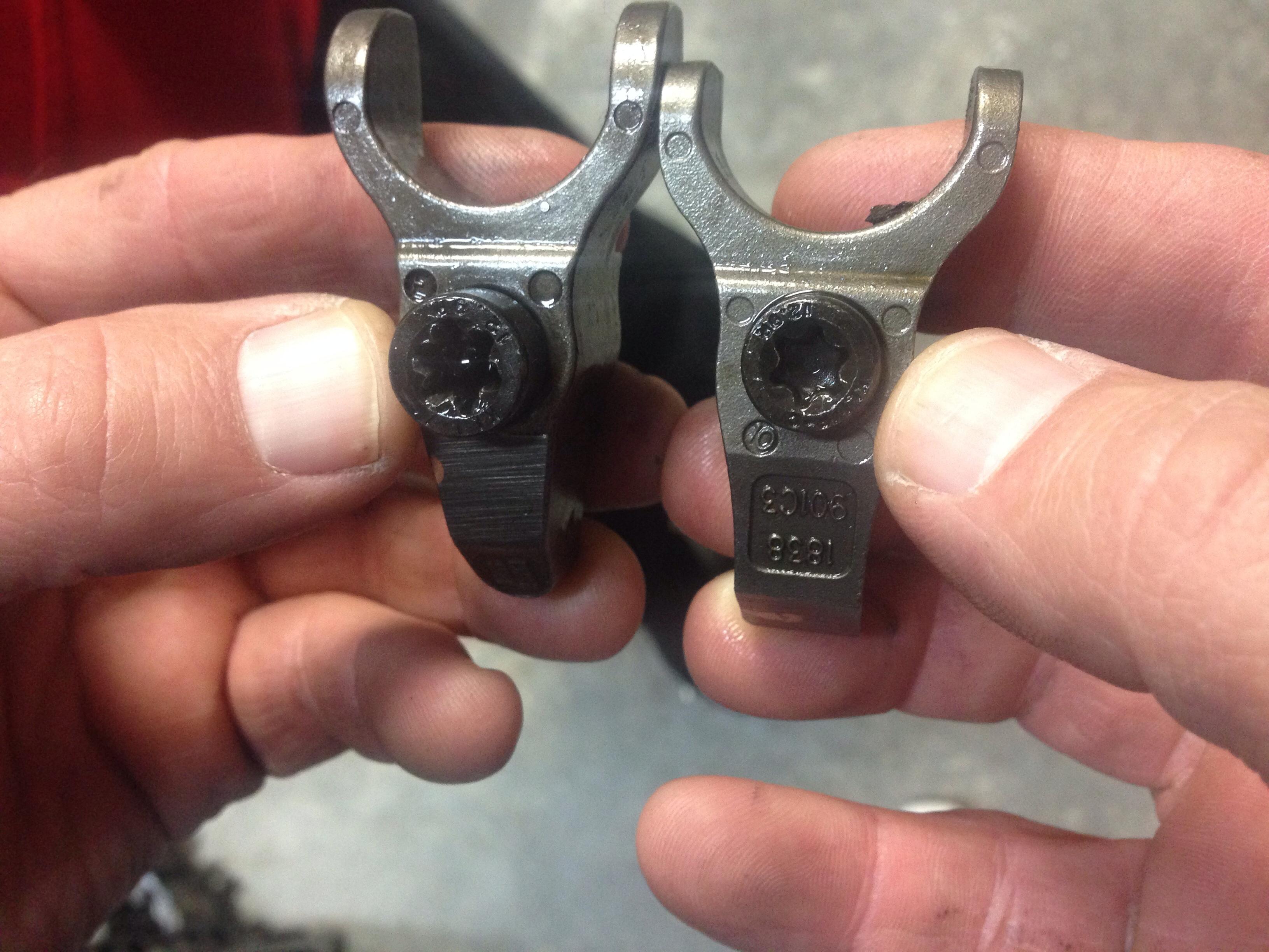

I've heard such conflicting information on this, Tay, could you possibly get some pictures maybe of each side by side to finally put this to bed?

Gonna be pulling it apart shortly.. I will take a pic and post it when I get a few minutes and let everyone know what happens after reassembly

Tore the truck down tonight and swapped the injector hold downs.. I'm amazed at how different they are.. Got it all back together and running great no issues here's a pic 07 hold down is left 03-06 on right.. Glad I got it taken care of image.jpg

Tore the truck down tonight and swapped the injector hold downs.. I'm amazed at how different they are.. Got it all back together and running great no issues here's a pic 07 hold down is left 03-06 on right.. Glad I got it taken care ofView attachment 25540
Can you get a side shot? Laying side by side to see the total height of each. That may be where the problem is. I'm betting one is taller
