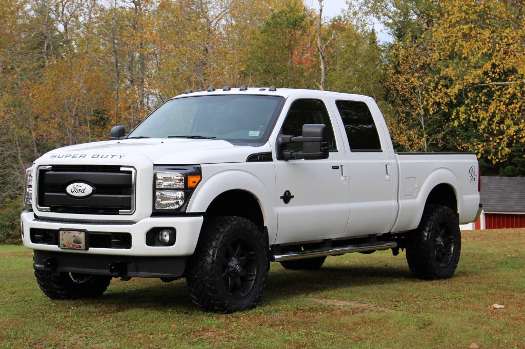

My optimum setup would be these lights with retro'd projectors

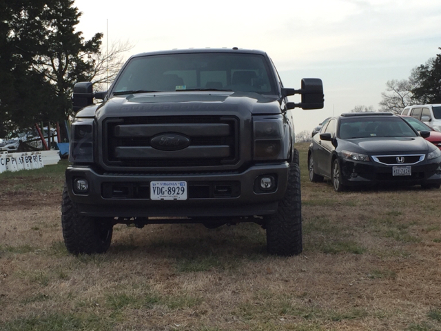

Yeh not sure what headlight option is best for a white truck. Projectors with hids put out quality light though. Here's pic of mine . Sorry isn't white

That still looks awesome. What size rims you got? Sorry to derail somewhat but im looking at getting novakanes in the spring. My stepbrother has forces 22x12 but i want a little more of a conservative look.

Sorry for blowing you up but did you paint and retro the lights yourself or did you have them done somewhere?

No problem. Wheels are 22x10.5 and I did them myself. I recommend Jeremy at retro shop if you rather have someone do them for you. Best pics I have showing how much they stick out. One is with oem flares

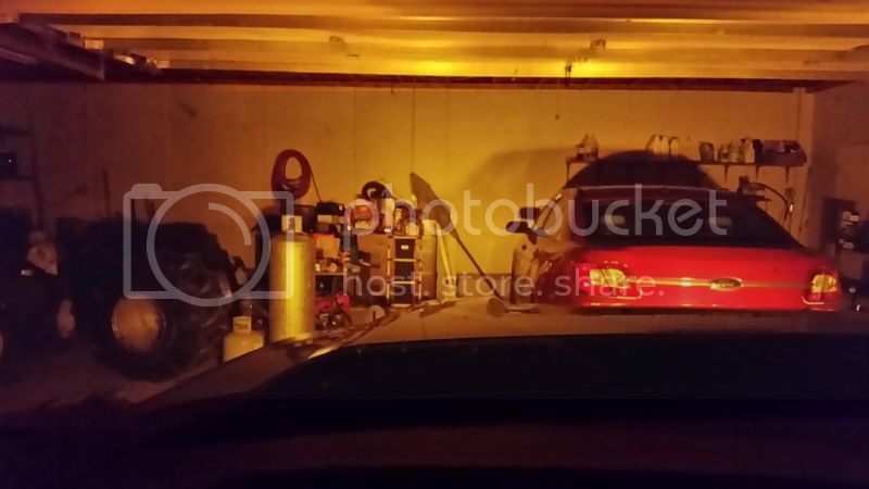

My parking lights/turn signals are V3 Tritons from VLEDS. They may be bright enough to use in those black buckets. I have the amber/amber switchbacks in the front and regular reds in the rear. They're very nice in that the bulb can be adjusted to a different depth to work better with the reflector in the housing. They're expensive, and need an extra relay for the switchbacks to work on these trucks. Everything is plug and play with Weatherpak connections, but with the controller, relay, and resistor, there are a lot of wires to clean up after installing.
This is parking lights only. That's a 3 car garage.
