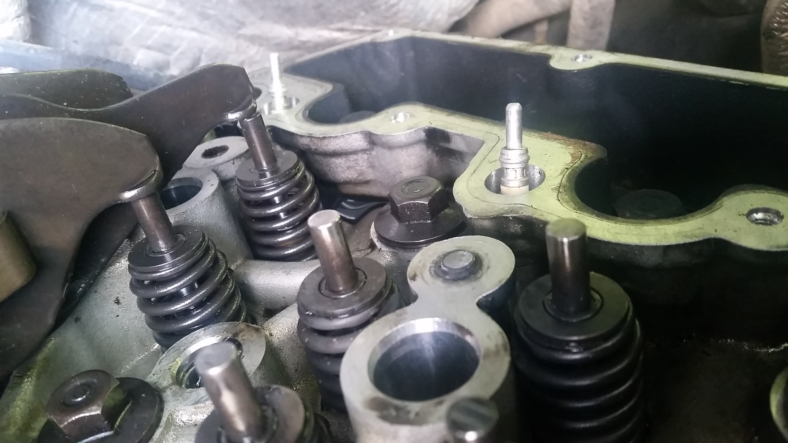

So, I've been pretty busy here lately but have managed to get maybe 2 hours of work in on this thing a week. Just enough time to get all my tools out, do a little bit, then pack it all up. Pump is changed, passenger side is done, drivers side is being a pain. One of the injector hold down bolts decided to break off. I soaked it every day for almost 2 weeks with kroil and hoped that a little heat and some vice grips would take it out but i was wrong. Any suggestions on getting it out without removing the head to drill it?

gotchadollar
Jan 1, 2016
299
Weld a nut to the bolt. Slid it all the way down, make sure to get a weld all the way around the post. Pick a nut that has a little gap on it to make sure you get good penetration. Let the nut cool to touch before trying to get it out
JTS
Feb 10, 2015
36
That's what i was thinking. Is it better to use one that leaves a gap, or use one that threads onto it?
gotchadollar
Jan 1, 2016
299
I like to have ones with a gap, but if your threads aren’t jacked up I would try to thread one on first.
JTS
Feb 10, 2015
36
Well, that didnt work.
sootie
Oct 3, 2012
11,853
39
get out the drill...
I always drill a 5/16 hole or thereabouts and hammer a torx bit into it. They are typically stronger than an ez out.
If that doesnt work just keep drilling until you get to the threads. Then take a small pick and fold all the individual threads in. Make sure you dont go too large and hit the threads in the head. The key is to get the hole exactly in the center of the bolt. Retap the threads to the same size.
If that doesnt work pull the head.
JTS
Feb 10, 2015
36
I'm just going to pull the head. With the luck I've had lately i know if i try drilling it in the truck I'll end up drilling into the head. I don't have any type of fixture to hold the drill straight either, but i know a guy with a bridgeport in his garage and i know we can get it straight with that.
