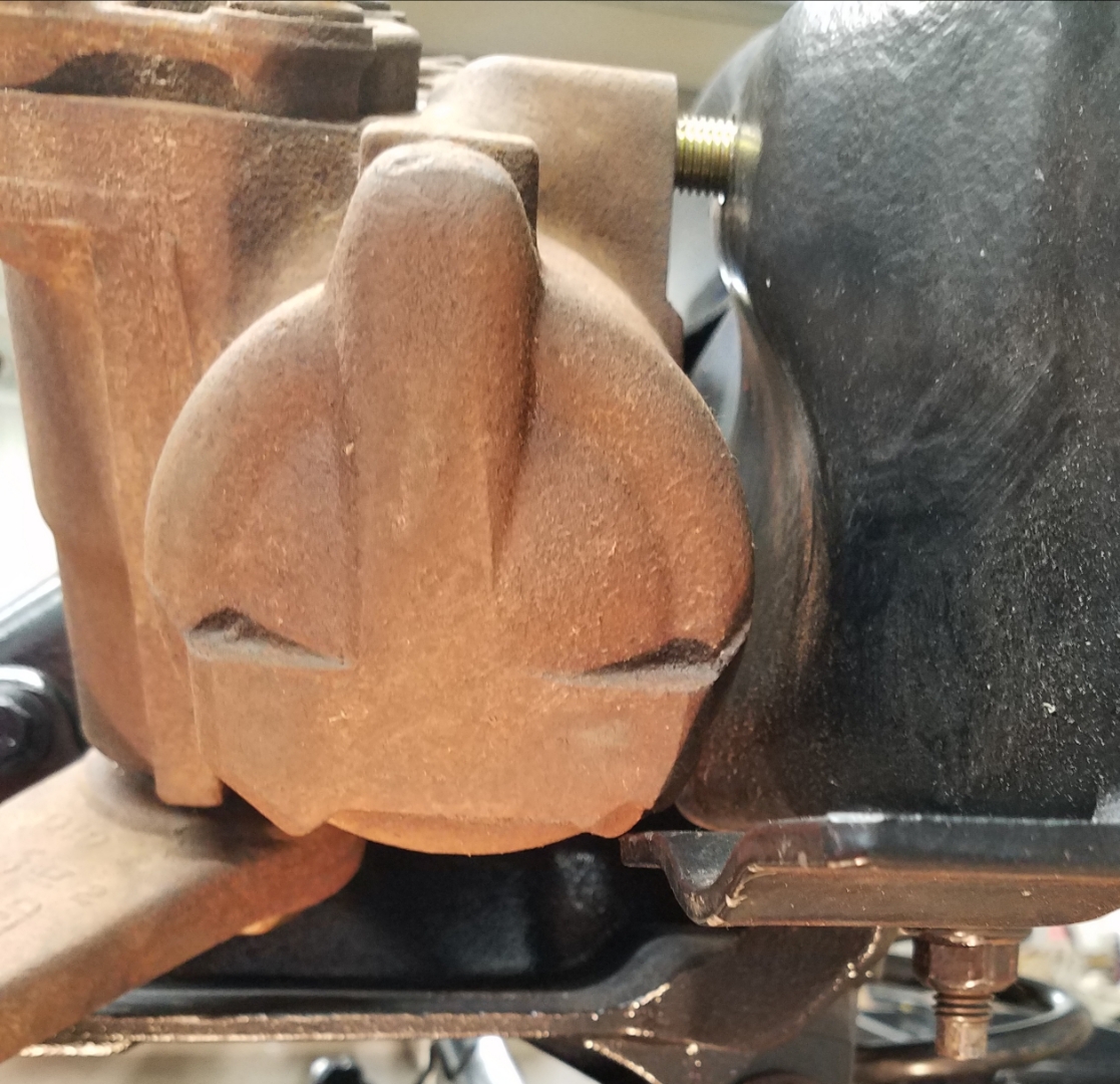

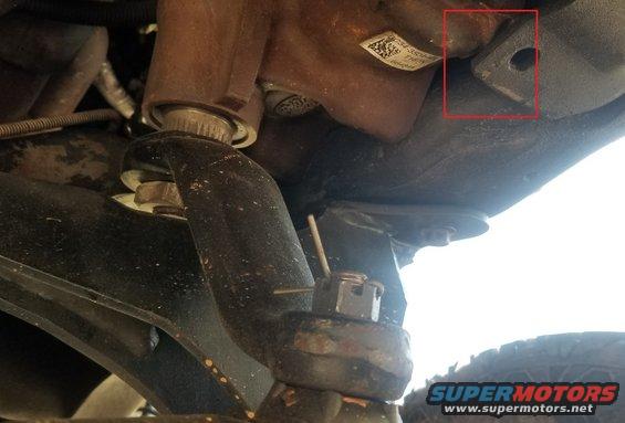

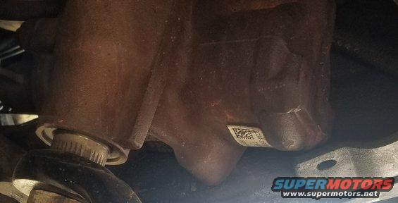

Ran in to an issue while installing a 2013 steering gear on a 2001 F250.
The lower part of the steering hits the upper away bar bracket. I think the solution is to change the mount to accept a 08 thru like '10 away bar.
Looking for some guidance.

That's different from where mine had an issue. I had to notch clearance for the pitman arm nut, but everything was fine going on the frame.

My mistake. For some reason I was thinking track bar mount. I removed mine but the sway bar should be mounted behind the axle and not an issue.
What front end setup are you running?
I'll go take a pic of mine.

Ok, after taking pics I think I understand.
Never thought about that bit being there.

The 2001 sway bar is behind the axle. When I did the coil spring conversion, the sway bar moves to the front of the axle. It has a 2007 coil spring now.
My mistake for not including the coil spring swap.

One of these days I'll do coils. With leafs I've only noticed the sway bar being gone when I get on a really tight off-ramp too quick.
Not sure how to help with your dilemma though. fab some drop to the mounting pad?

Well, I don't have that issue as I changed from leafs to coil...and a 2013 steering gear. The coil spring swap, with a 05-07 steering gear would be straight forward, but that beast if a steering gear in 2013, well, it creates an issue.
I'm thinking of fabbing up a drop mount, maybe 1/2" will get me what I need.

I figured it out, at least part of it.
When you drill the frame (2001 frame) to accept the 16mm bolts, the drill drifted down a small amount on the upper front hole. I'll get that straightened out and things should be fine.

oh i recall dealing with that. those reinforcements inside the frame skewed the bit over.
It was the upper hole on mine, I was getting confused as to why I hadn't gone through yet. I stopped, shined a light and had made a pretty good dimple next to the hole.
Glad you got it sorted.

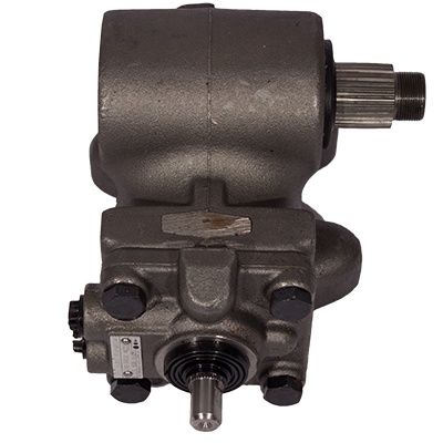

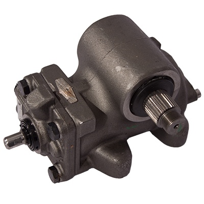

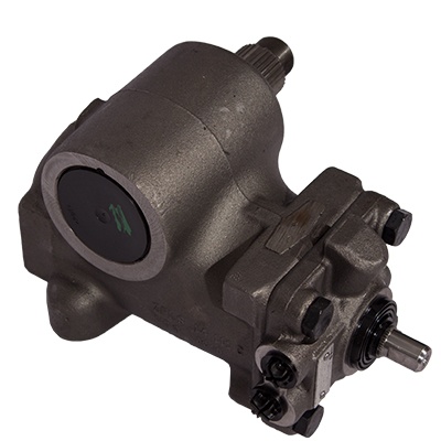

Searching for part number 8C3Z-3504-B (I used a 2015 6.7 F350 as my "check if it fits" truck model), all the Ford parts websites seem to indicate that it has been replaced by part number HC3Z-3504-E (for example, https://parts.lakelandford.com/p/Ford__/GEAR-ASSEMBLY---STEERING/54611294/8C3Z3504B.html ).
However, the physical pictures posted with HC3Z-3504-E look different than the photos of the 8C3Z-3504-B gear assy posted in this thread.
https://www.tascaparts.com/oem-parts/ford-gear-assembly-hc3z3504e
https://www.getoemparts.com/oem-parts/ford-gear-assembly-hc3z3504e
https://parts.lakelandford.com/p/ford__/Steering-Gear-Box/75130022/HC3Z3504E.html
It looks more "stubby" if that makes sense.
Has anyone used the HC3Z-3504-E on an earlier truck, or any reason it would not work? Am I better off looking for a new old stock of the 8C3Z-3504-B ?? Thanks for any feedback!!!!

I didn’t cross reference the part numbers but the picture you have is of a F-450-550 box.
