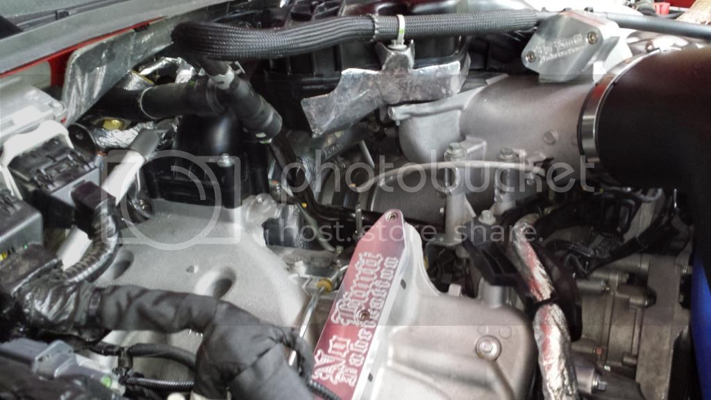

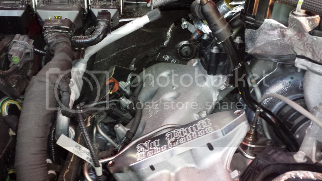

And a side shot once complete with no egr assembly.

Notice what I did with the leftover bracket in the rear that was held by the stud and a wire clipped to that. I reused a factory bolt and used the same nut to fasten it to the bracket. This left plenty of stud to reclip my wires to. No dangling wires. Egr wires and vacuum line are tied to the left.
