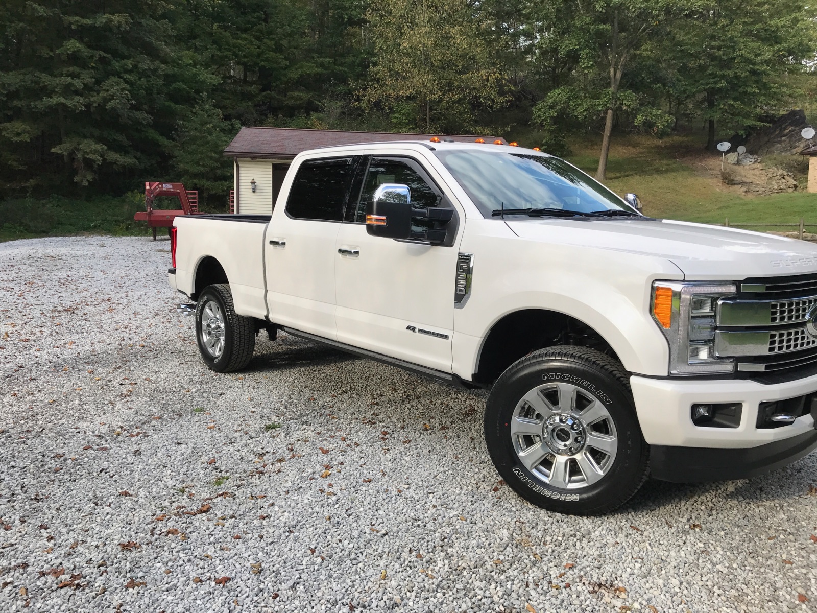

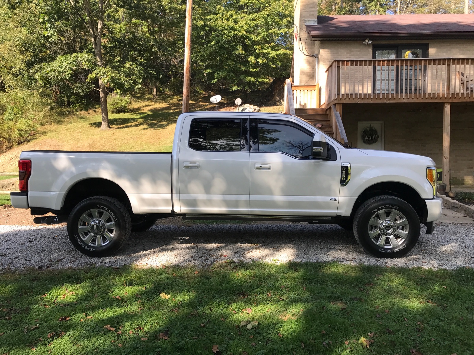

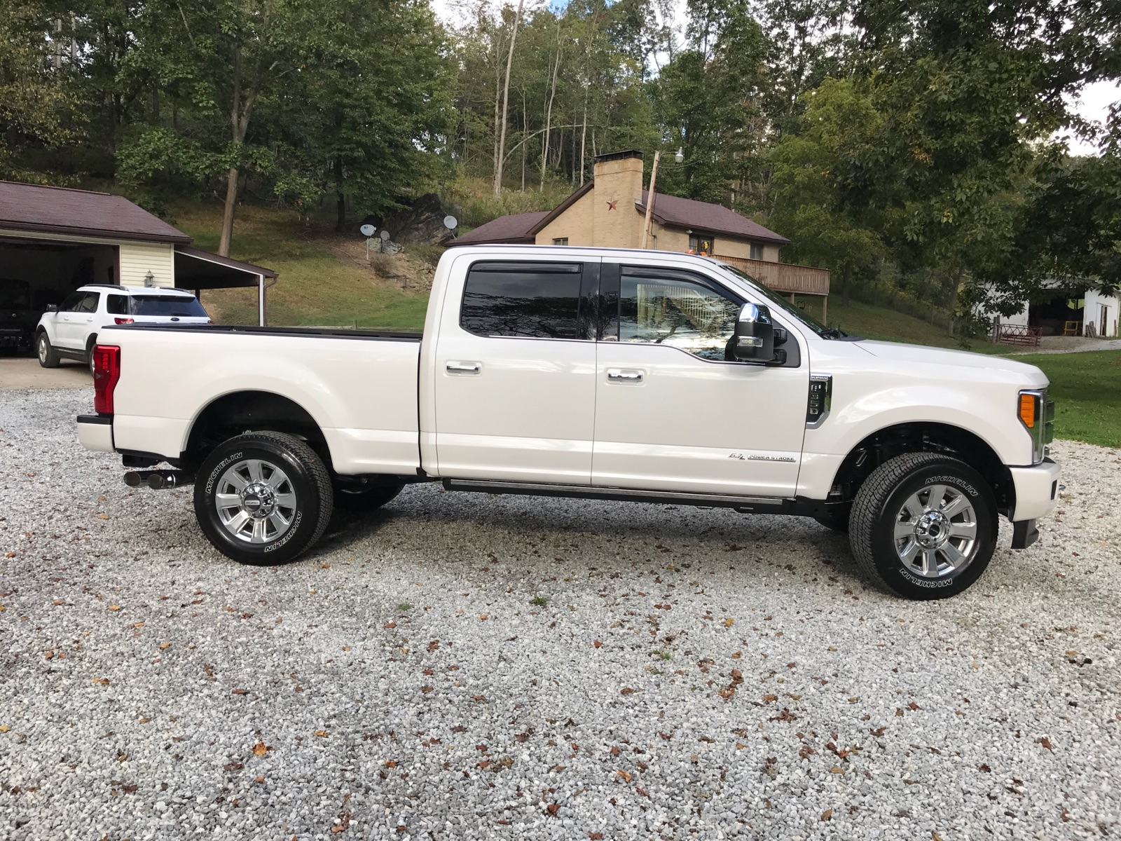

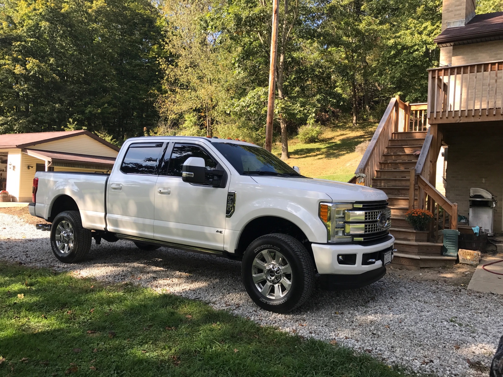

Well it finally came in. Heres some pics of it before I tinted the windows and winshield, change out the door handles and mirror caps to ptm , and took off the 4x4 sticker and powerstroke badge. Now I need to just buy my tires and leveling kit so I can put on the American force wheels.
mfoltz
Dec 20, 2013
216
Here they arr
