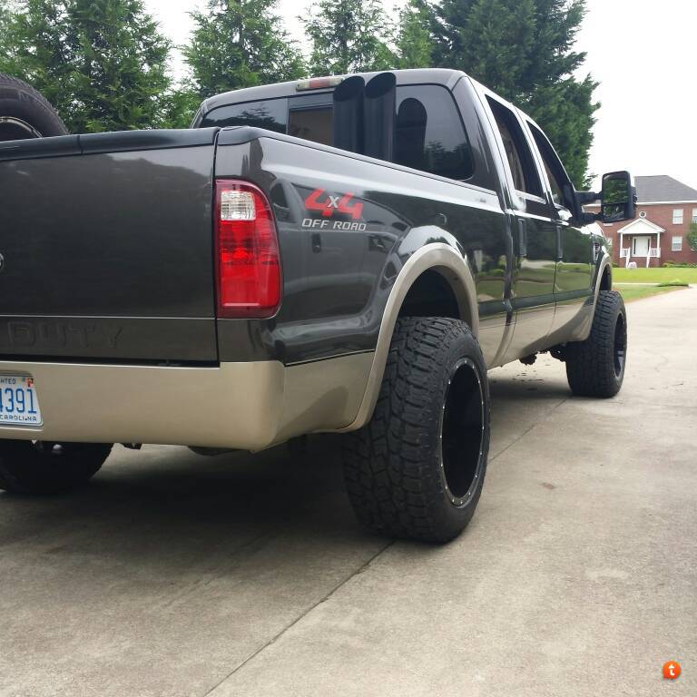

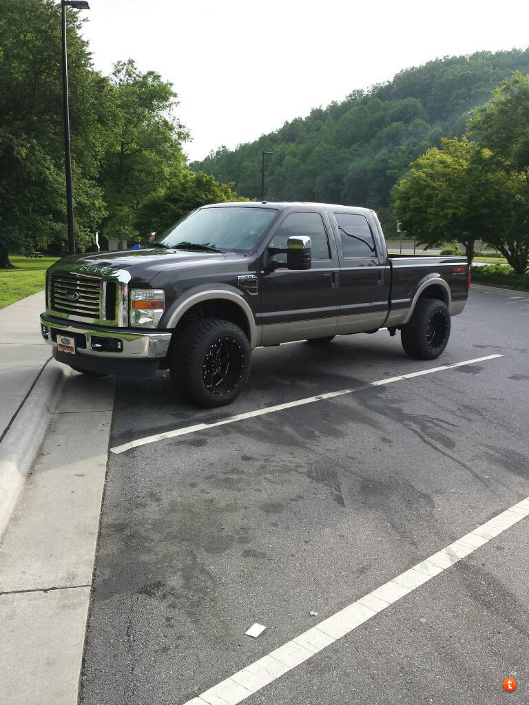

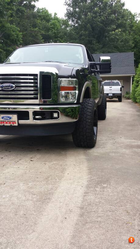

I finally got my stuff on so I figured I'd post up since I actually have what the title of the thread is lol
Completely stock suspension up front with 1" blocks in the rear so it sits level. 305/55 Toyo AT2 with Gear Alloy 20x12 -44. It didn't actually rub but we did a little trimming and pulled the fender liner back just to be on the safe side so it wouldn't hit when I went over a bump or something cause they were pretty close. Here she is....

Do you have any pictures from the front looking down the side to see how much they stick out.

Do you know what's on the blue truck for comparison? By the way your pictures help a ton thanks again.
His are the exact same wheel size as mine but the tire is a smaller Nitto 420, 305/50r20.
On edit, me and Cory couldn't believe the difference in our setups for the only difference being my tires. These 305/55 AT2's look a lot bigger in person than the 420's. I had to do some trimming at stock height to completely clear but he didn't have to trim anything and he is lowered on 4800# springs of that tells you anything

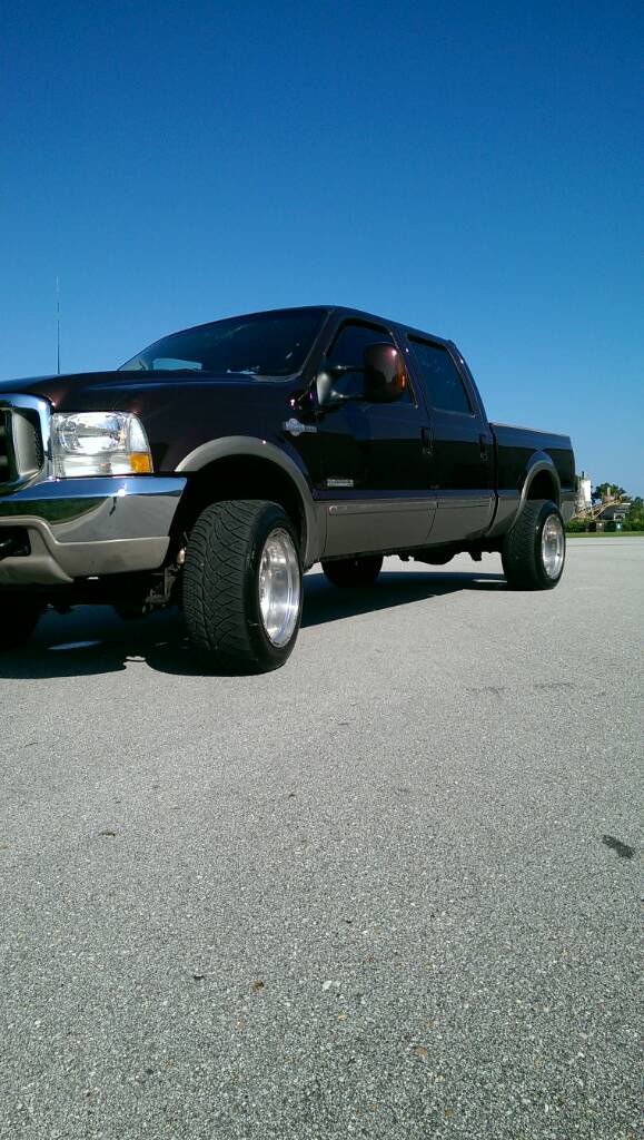

Here is another for comparison
Me and jacob were talking about it, i really wish the 420 came in 305/55. Huge difference between the two sizes
I really couldn't believe how much of a difference there was. There's no way you'll be able to do 4800# springs randall. Btw, that's my blue truck for the gentleman that was asking.
