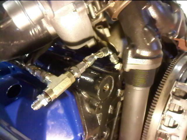

My F350 has a Vegistroke-style DIY conversion with over 140k miles since conversion. Current configuration uses a Frybrid heated pick-up, alum TIH, FASS HPFP, coolant-heated filter, more TIH, a 16plate FPHE on firewall and I have an aux coolant pump in the VO loop to maintain good coolant flow. I see 180*+ VO before the heads. The system is deadheaded and VO is fed into the 'test ports' in the heads. There is a 12v solenoid valve that allows fast purging of the VO from the heads. I used PTFE-lined SS braided fuel lines with JIC ends on the engine.
Here's some of the plumbing on the new engine:

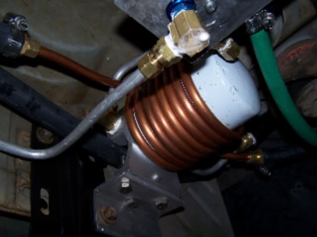

I built the Excursion for my (ex)wife and wanted it to be simple and BULLETPROOF. I bought a Vegistroke V3 module from Frybrid, mostly because CG was willing to build an under-body VO tank and I was working in Seattle at the time. So, Frybrid heated pick-up in a 38gal tank, TIH, V3 module (coolant heated, FASS, air bleed, pre-pump filter, primary VO filter, temp and press switches, purge solenoid, VO check valve, etc), more TIH a 16plate FPHE on firewall and aux coolant pump. There is NO RUBBER FUEL HOSE anywhere in this system, its either alum tubing or PTFE-lined SS braided hose (on engine). Also sees 180*+ VO before the heads! The truck has over 90k miles on the high-cholesterol diet now.

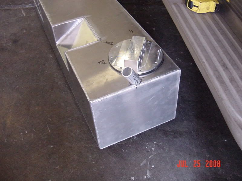

VO tank during construction:

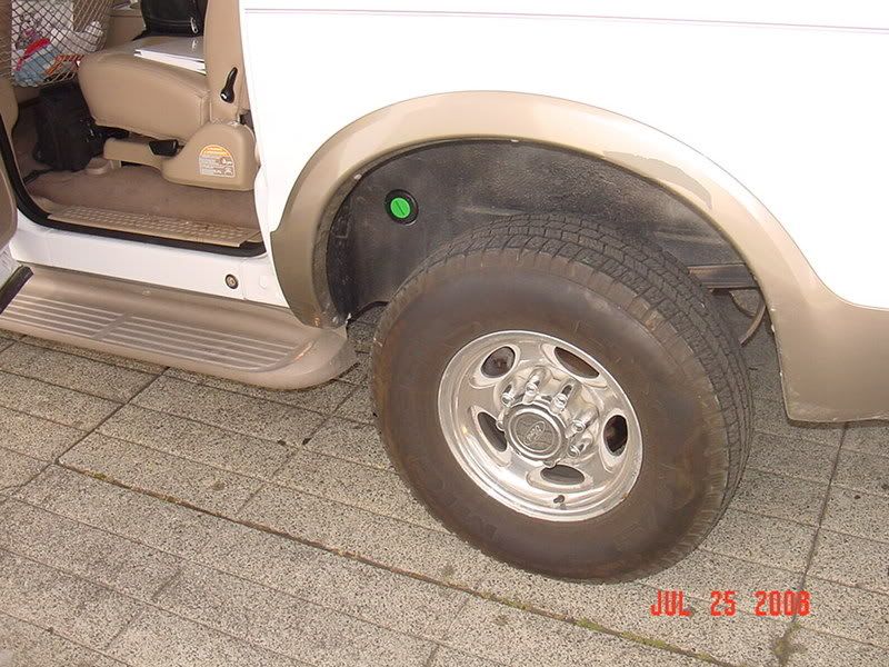

'Stealthy' VO tank filler:
FPHE:

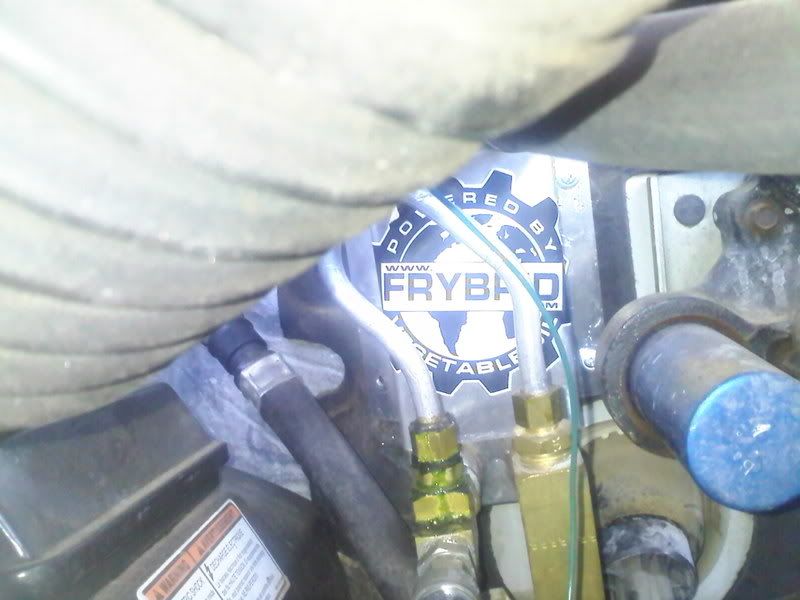

V3 during mock-up:
The only mods to the factory fuel systems are the addition of check valves at the heads and the ability to turn off the OE fuel pump.

Another pic of VO tank before it was installed:
Here are the only modifications to the OE fuel system: (added CV at head)

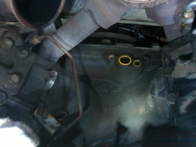

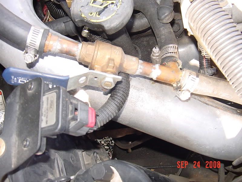

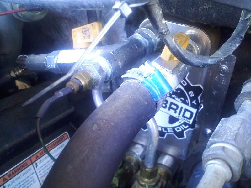

I swapped turbos on the side of the interstate a few weeks ago (with an old stocker) and then installed a van turbo at camp. Needless to say, it was ultra cool that there was NO PART of the VO conversion in the way of this task. For that matter, I've changed injectors on a couple Vegistroked trucks and NOTHING in the way of even that invasive task!!

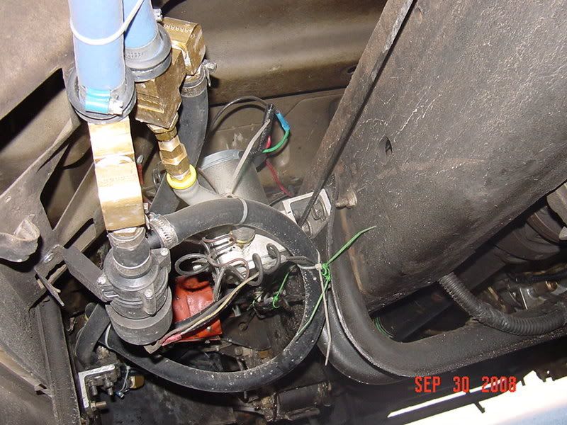

You can see here how I terminated the TIH at the FPHE and bent the fuel line around to go directly into the FPHE - minimizing fittings/connections mitigates potential leaks! I also have valves to turn off coolant supply to VO loop and to isolate the entire VO fuel system from the engine. (you know, in case I run over a Kia and rip a hole in something :p. I also turn off heat if I'm not using VO - don't wanna COOK the stuff in HE's, etc!)

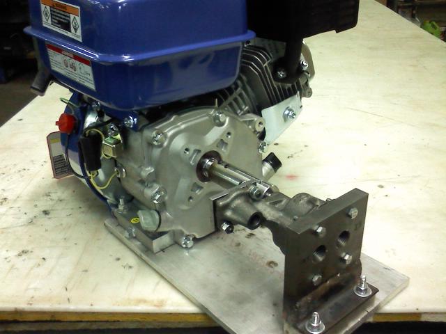

FYI I make a plate kit to convert and mount an SBC pump for use as a collection pump. Here's a picture with a "way to big" 6.5hp Honda clone engine. M55HV Melling pump, 10-12gpm at idle pushing WMO. PM or email if you'd like one.
