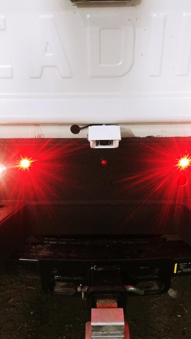

The wiring is there from where I unplugged the original camera. My 2012 I took the camera out of the latch and mounted below the tailgate of the utility. Just don't want to remove camera from my 17 tailgate. This is the camera that came on my 17 550 bucket truck. Might have to call them to see where they got this one from. backup camera.jpg

The wiring is there from where I unplugged the original camera. My 2012 I took the camera out of the latch and mounted below the tailgate of the utility. Just don't want to remove camera from my 17 tailgate. This is the camera that came on my 17 550 bucket truck. Might have to call them to see where they got this one from.View attachment 49381

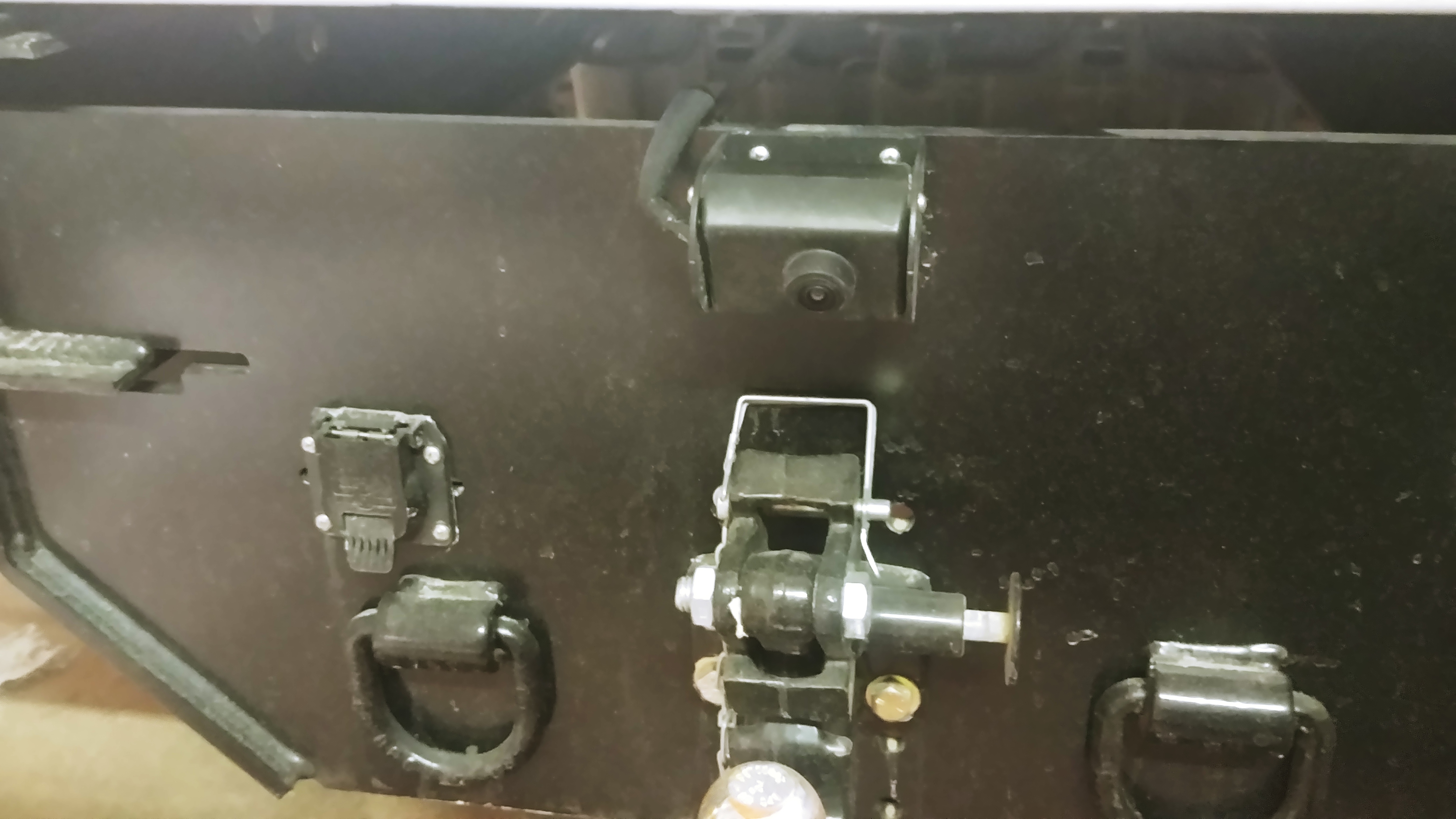

Found a camera thanks for the help though. Rostra makes one that plugged right into oem harness.thumbnail.jpg
