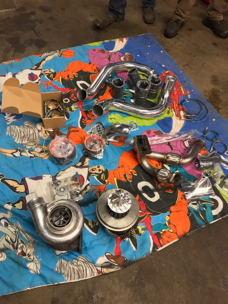

Alright sweet! I'm excited warren said about a week I should have my injectors done. I just polish my compressor housing and my new intercooler pipes, boots, clamps, and intake elbows are on the way. I'm hoping for 900. I'll probably spray it a little bit once I gate it.

nice ! that looks wicked. whose intake elbow is that? yeah you will be around what you want for sure. and there will be enough fuel left over for some giggle gas.

Bought em off some guy on the 6.0 fb page. Local shop made em. Couldn't go wrong for $250. 10 ply boots too. We'll see how they are when they show up.

Getting really close for everyone that's wondering ahaha.
How much for the sweet space jam blanket? Haha
If those are the sinister made cac tubes check the cold side to intake horn placement. I had a set that were so far off it had to be cut, rotate, couple back together.
