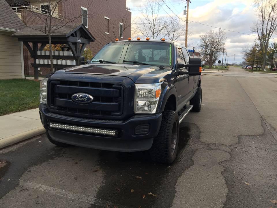

Lead Foot Diesel Performance had a couple 7.3 powerstrokes in their shop where the customer changed to the 6.7 front clip
strokin6L
2,979
Springville NY
Here's some 7.3's with the 6.7 conversion and one with a 6.4 conversion(blue one)
Nice conversions. I also thought about doing this swamp to my new 6.0 but thinking I might just do the cheap route and convert my '03 to the 07 Harley facia...like I've done in the past.
G'luck to Original poster in your fiance's build. Newer truck for a cheaper price. I like where your heads at.
