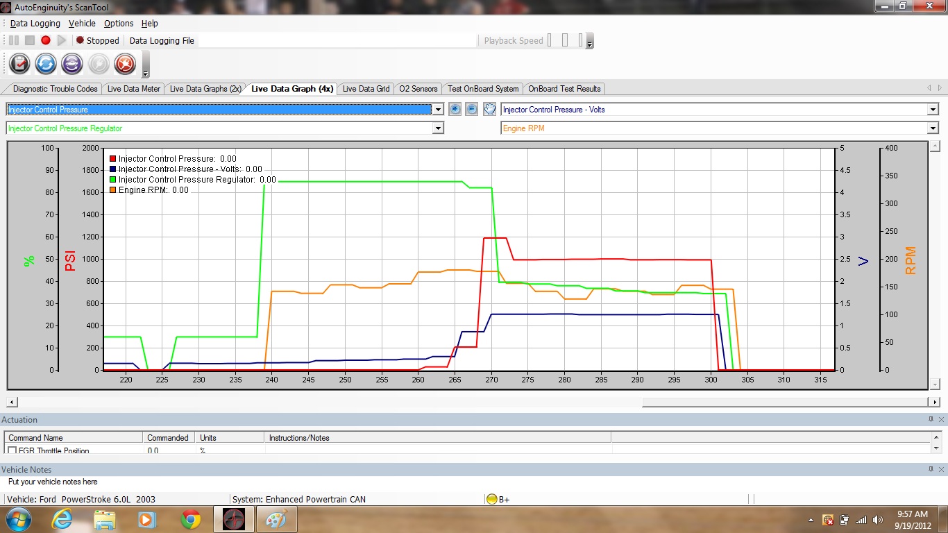

trucks not going to run off ether alone. the cranking speed slows down because the ether almost vapor locks the motor, thats why its hard on the lower end and headgaskets. need to look at injector pulse width cranking, doubt its commanding any. obviously icp isnt the issue. cranking rpms are high enough as well for ecm to command pulse width. check ficm sync and go from there.

Sounds exactly like mine a few months ago... http://powerstrokearmy.com/forums/showthread.php?t=19949
Same issue, no smoke, ICP was at 1500, everything seemed just perfect, but no smoke and no fire.... ended up my turbo was sticking ever so slightly and wouldn't let the truck start, even with ether the second time. This truck has a new turbo though right? I'd check for air blockage somewhere else perhaps... simple, yet made me scratch my head too.
