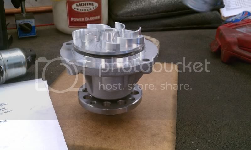

tell you what the stamped steel impeller vs the composite or BPD billet impeller
looks less efficient IMHO
and BPD went with a billet housing because the variance in castings they were getting was unacceptable by there standards and they wouldn't sell rebuilt pumps using
the varied quality and dimensions

I'm not sure how much more "efficient" it really needs to be... my coolant and oil temps stay in check, what more can I ask for? With BPD it seems you pay for over the top reliability, which is great. I just couldn't swing the $ at the time. Too rich for my blood.
I don't think they ever sold a stamped steel impeller version ?
Correct, another case of my fingers moving faster than my brain. When I said metal impeller, I should have just said billet impeller. They always had that nice billet impeller on there, but it wasn't always a complete billet UNIT. I never knew the reason they got rid of the cast housings with the billet impellers, but you just clarified that for me!
Zmann
Aug 5, 2011
4,464
the BPD mimics the OEM impeller design the stamped steel is only capable of the standard typical design due to the metal available to punch / press form the unit from a singe sheet
my concern was that the stamped steel was less capable of moving coolant vs even the oem design
but if your deltas went unchanged I guess it's a non issue
Considering how often the plastic OEM design disintegrates and parts of it crack and come apart, and also spins on the shaft on occasion... it can't be any worse, that's for sure.
