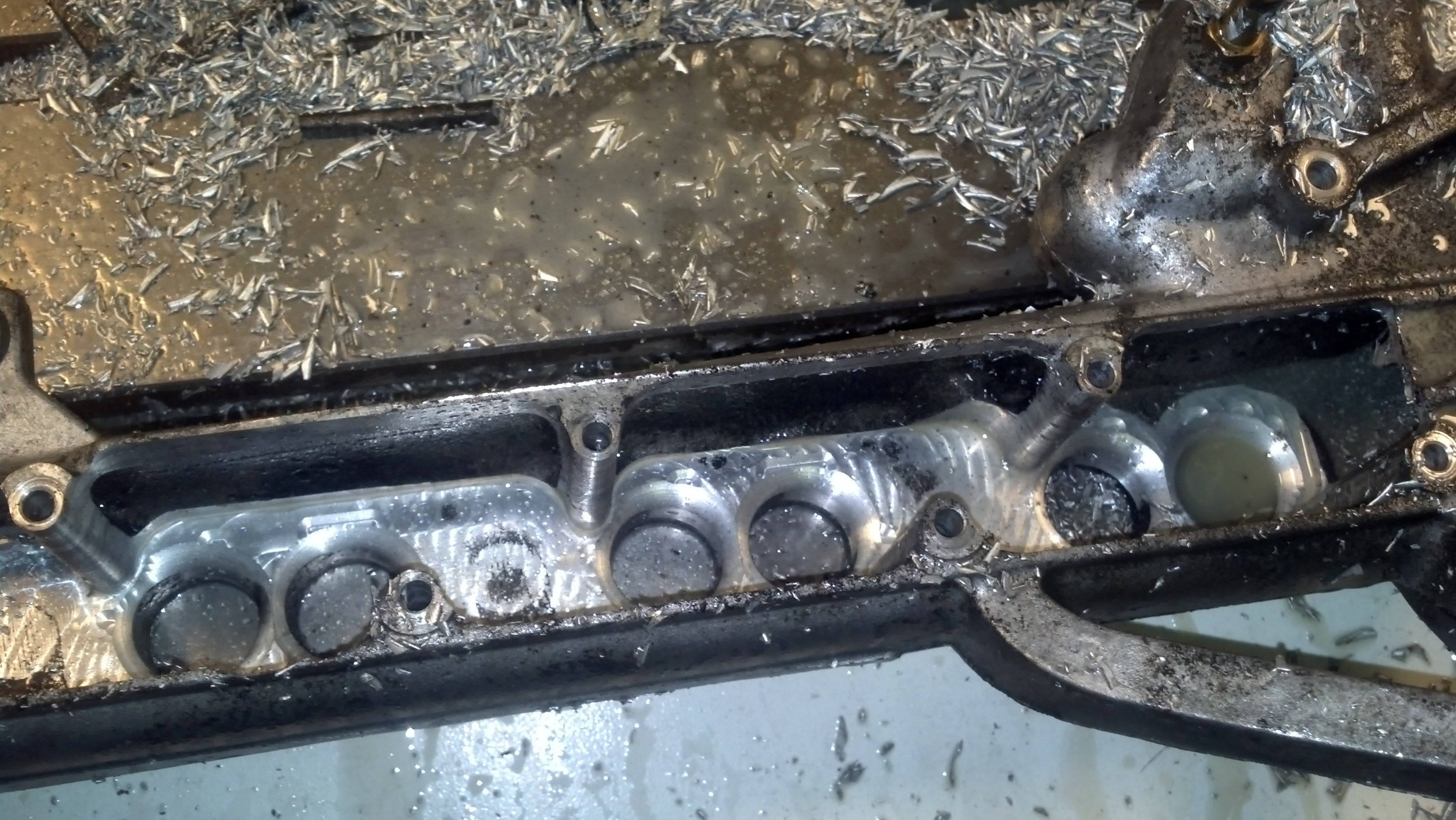

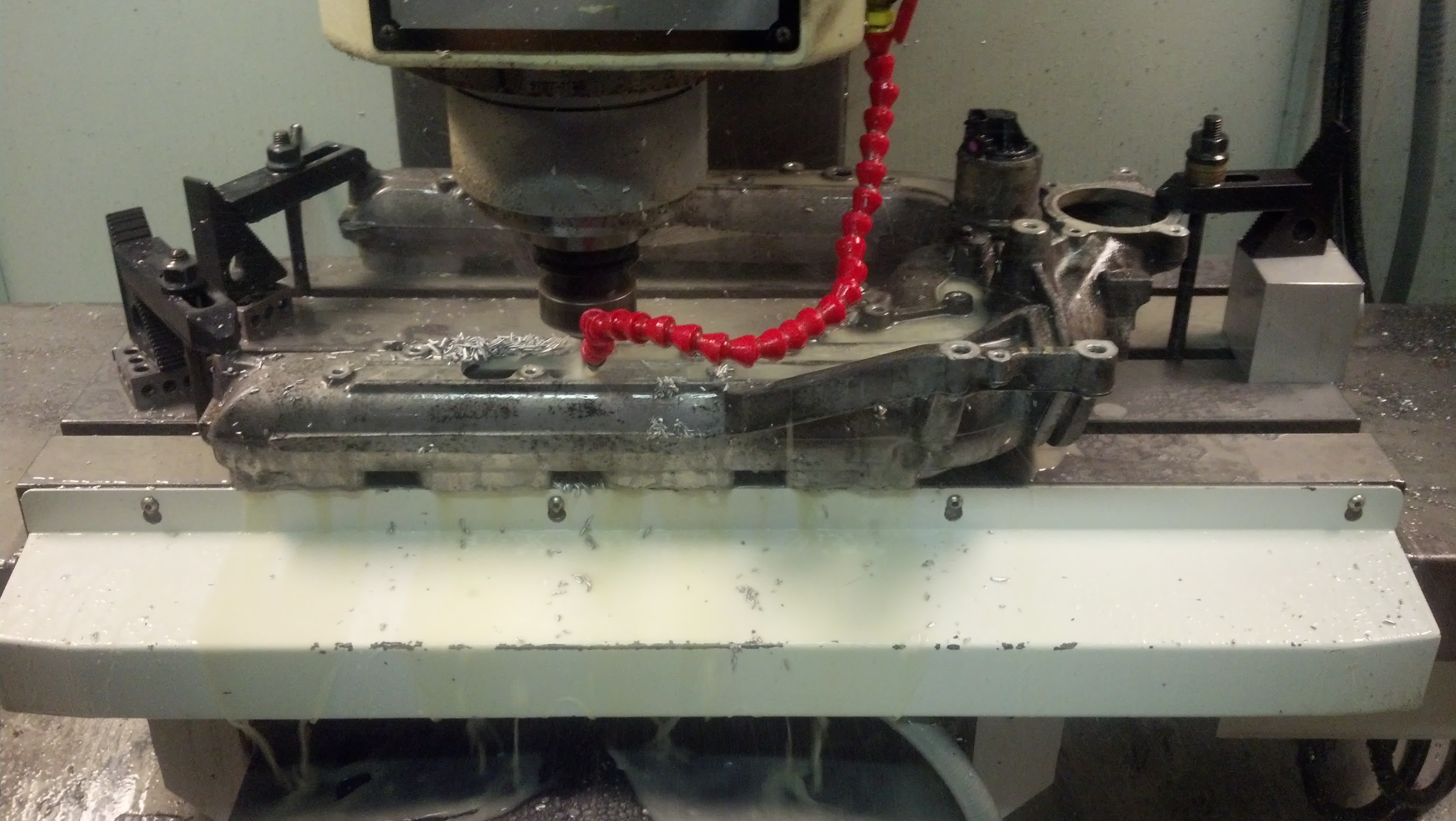

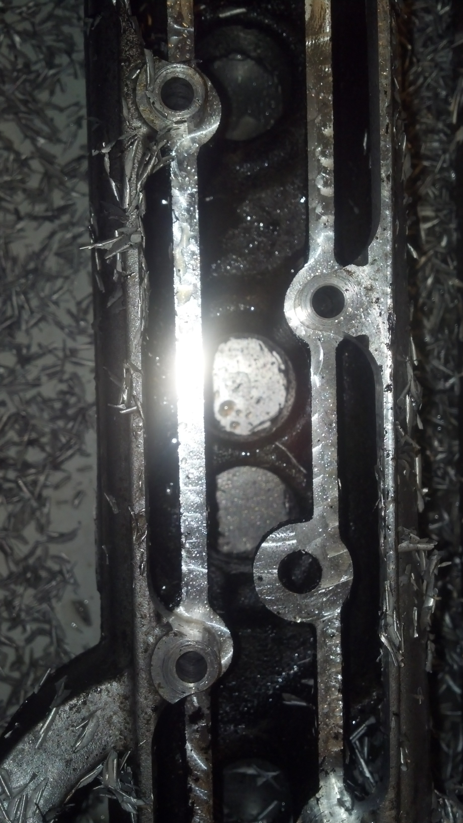

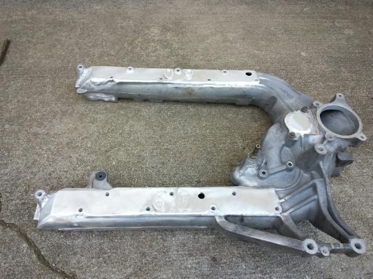

Here it is. I'm going to cut one more with some changes in it, but this one turned out pretty good for the first try. I strapped it down to the mill and cut the top off. Then went in a removed a $#!t tone of material. I machined the walls but I dont have a pic of that. I port matched the heads and bored out the inlet by .125. I did alot of hand polishing and ran a ball hone down through the inlet to each runner. after all that it got fully welded and is currently at the powder coater.
