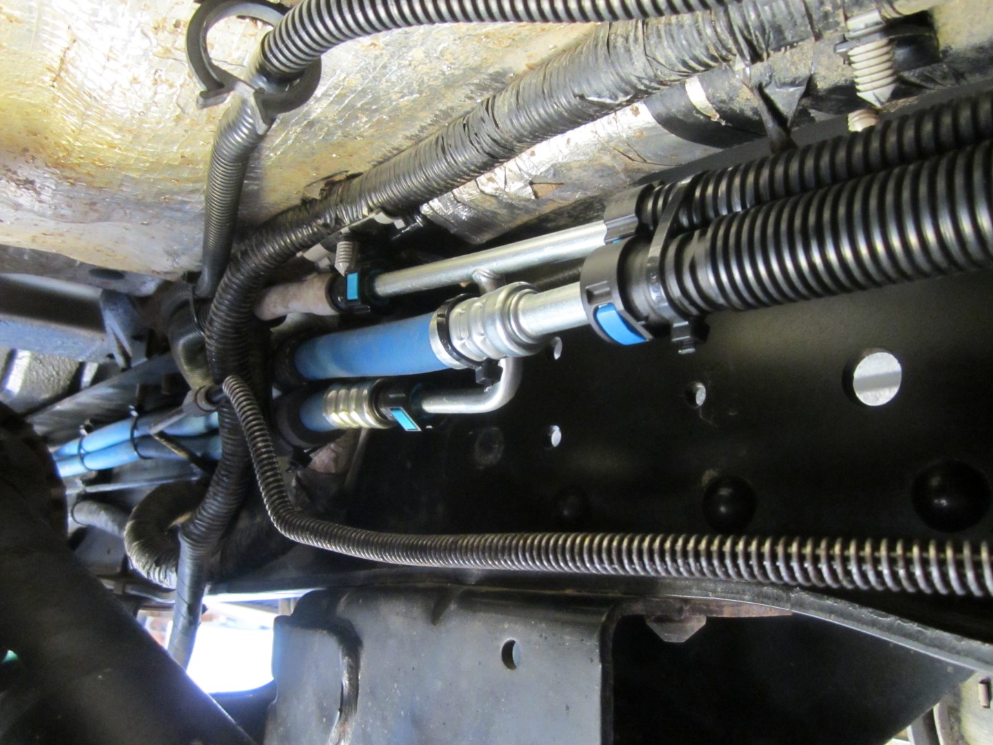

This is what they give you to return from the airdog. They must not understand how the HFCM actually works, since they have you pull the factory feed off if it, leave it open, and return through the pump. Makes a nice mess.
White_monster
3,177
The great white north
That's new that they return through the factory pump, smart move pureflow. Need to tie the return from the engine and the return from the Airdog into the same line. Love when companies fix something that isn't broken.
