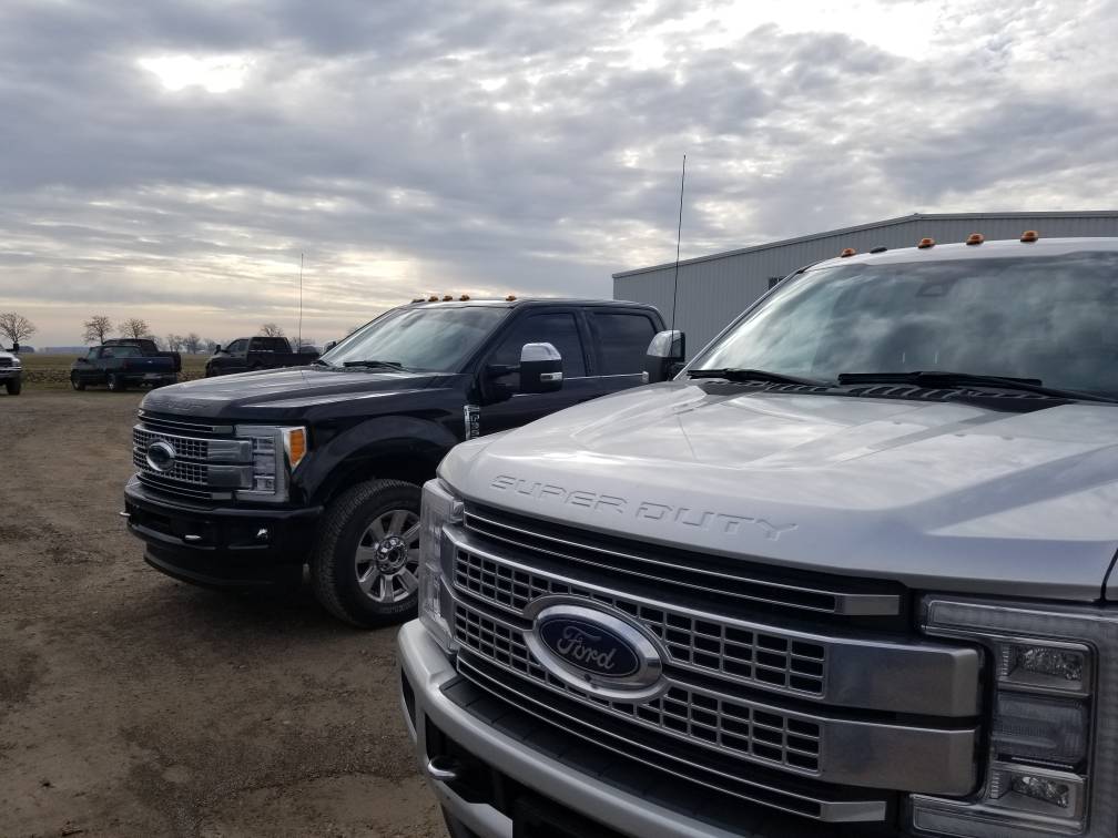

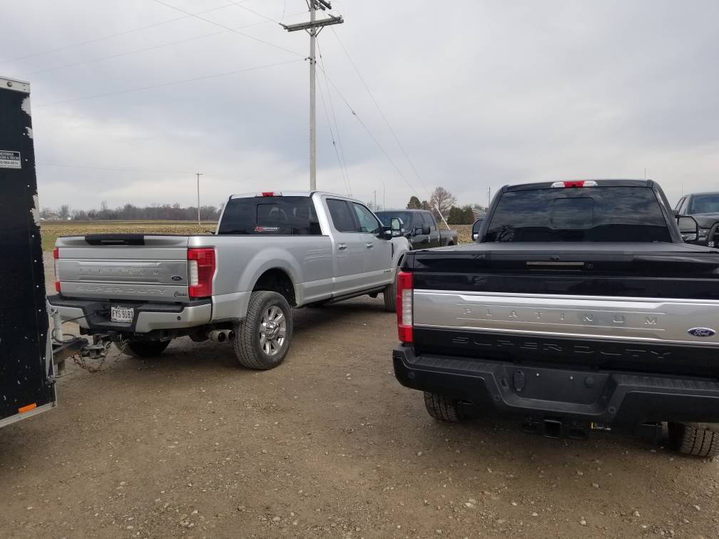

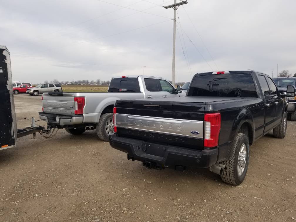

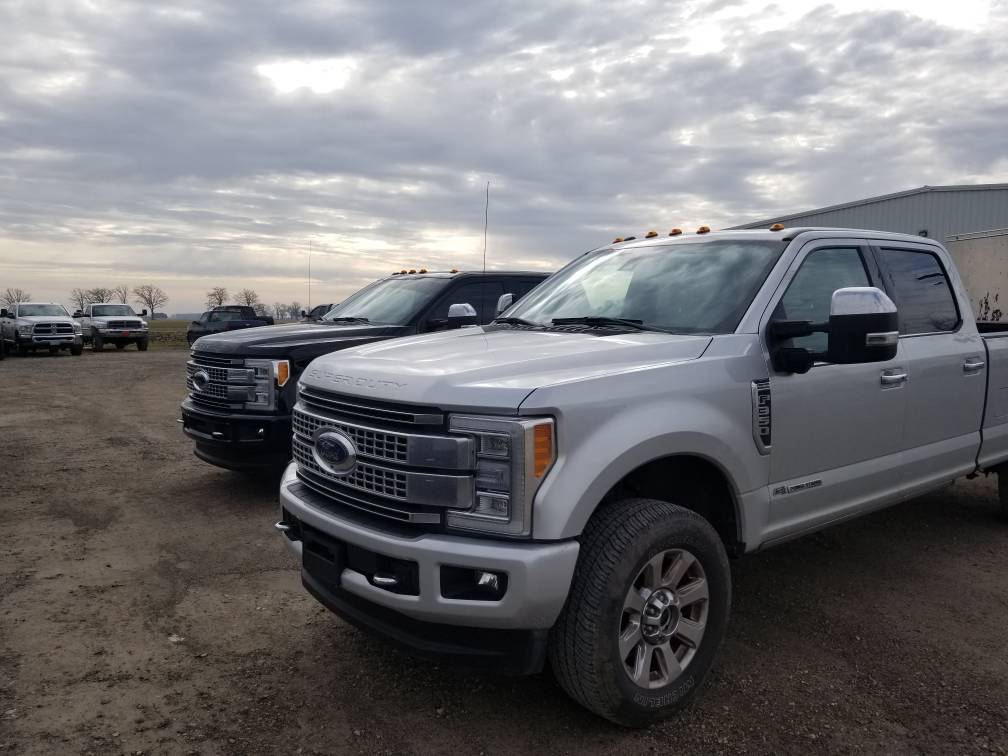

Well decided on 4800# front coils. Think I made the right choice. So far it's about an 1.25" drop. I figured it will settle another 1/4" probably. Rides way better. Gained some rear rake again which makes me happy. Had to trim front bump stops down as well. Took 1.25" out for now.
Got some shots of it next to this stock height silver 17 Platinum truck. It's actually Drew from D&Js truck.
Do you know what the height of the truck is at now at its highest point?
Highest hard point would be the cab lights and I ckear 7'-0" garage openings by a few inches. So I would say top of those is 69-70" while on stock size tires

Really that low??? I was worried I’d have to go down to 4400 springs and remove rear block completely. Ideally I need to be at 80” max.
Thanks for the info! Very clean truck btw :ford:
Hold on. I think i f*ucked up my math really bad. I replied to your comment when I was half asleep last night.

Just went out and measured, between 77-78" to the top of my cab lights. It's hard to get an exact measurement but it's somewhere in there. When I go to 33x12.50 tires I'll lose some height there as well.

That’s awesome! Thanks man!
