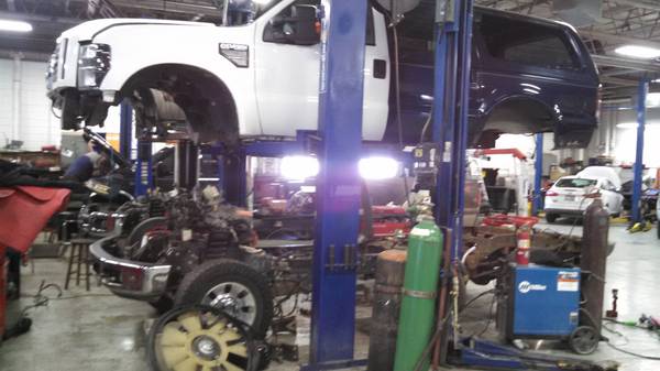

Got a few things done over the last few days.

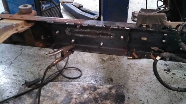

Finished the frame graft.

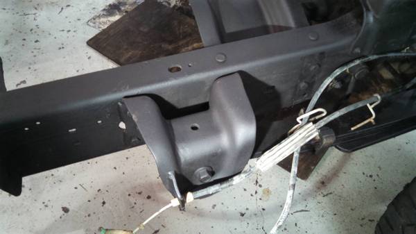

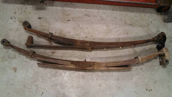

Swapped out the excursion rear springs for the '08 F-250 springs, and moved the spring mounts forward on the frame.
Got the trans and t-case in as well as the up pipes, stock injectors, turbos, etc. It looks like I'll be able to do brakes, fuel system, and frame wiring before the cab has to come back down as well here in the next week or so.

what was the reasoning behind putting the F250 rears springs in? i am considering doing that to one of ours also...is it a must to move the hangers?
on another note-you say stock turbos? i thought this was getting the built motor and turbo setup from the red truck or did i miss something.,..
Wayne
2,540
8
Twin Falls, Idaho
The big stock appearing turbos was the original plan, and it's still in the future. Right now I'm in the process of closing on buying a house, so I've been trying to be really budget minded, and keep this project debit free. So far, so good, but that's part of the reason it's going so slow. Oh, well, it's not like I need the vehicle. As far as the rear springs go, they're 8" longer, so smoother ride. It also helps for an ideal location on the e-brake cable mount since the '08 rear axle cables go through the spring hanger mount. It'super easy though on moving the hanger since 2 of the front mount bolt holes in the frame become 2 of the rear mounts on the bracket.
