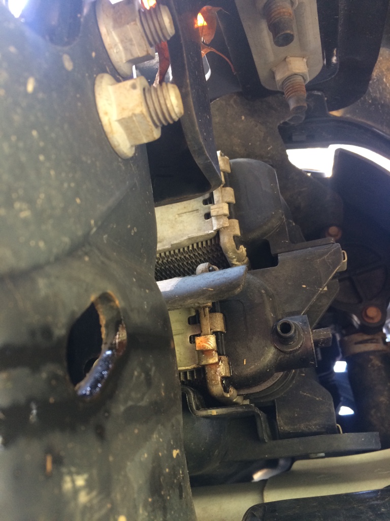

Noticed my radiator leaking slightly this morning from driver side. Pic below.
How hard is it to replace or is it worth having the dealer do it?
If I do it, should I stay oem and order from sunrise ford or do aftermarket? Thank you

I believe if you look at the mishimoto website it gives you step by step instructions on how to replace it. I would say it all depends on what performance upgrades you have and the price of both stock vs oem. If mine were to start leaking I'd replace with a aftermarket one. But if it's still under warranty then I'd let ford replace it.

Mishimoto has a really good video on install. Just watched it about 15 min long.
The mishimoto radiator is about 1100$ shipped whereas replacement oem from sunrise ford is about 800$. I dropped the truck off at ford this am to look at it. Hopefully covered under warranty. If they say no then maybe I'll just do it myself.

You should be good then. Dealer told me $1700 if I didn't have it. I politely said no thanks I'll go aftermarket at that point.

Dealer just called. Covered under warranty. He said would have been $1800-$2k without warranty.
