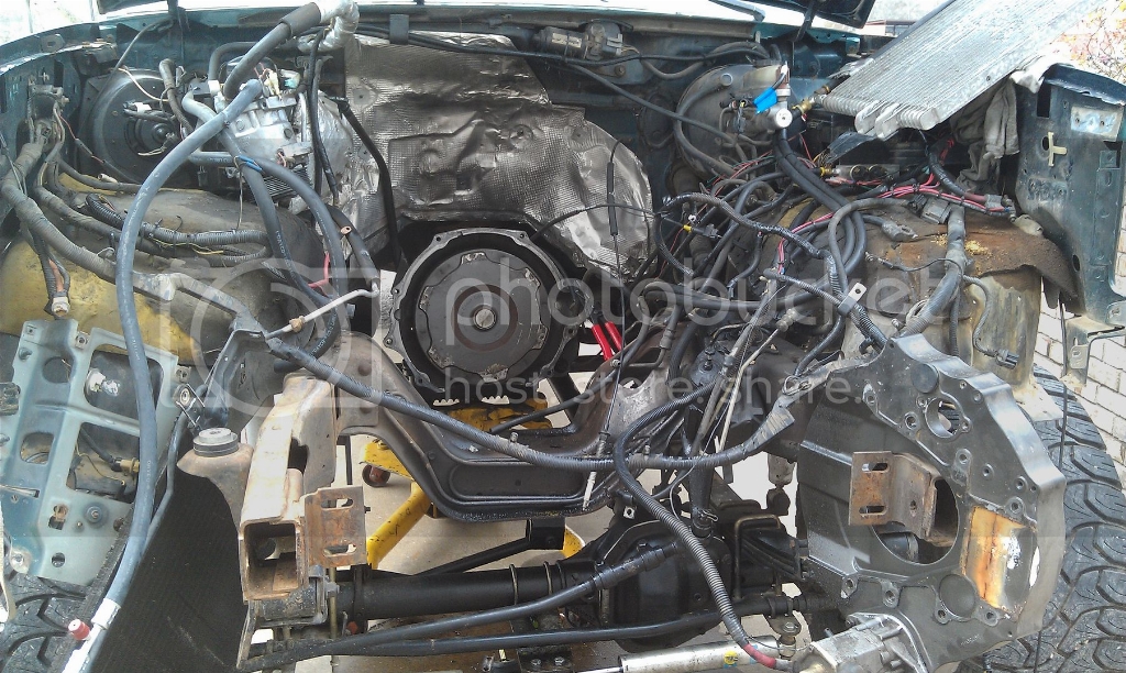

Nice conversion! What don't you like about the engine mounts you bought? What did you do for ac and power steering? I ask because I'm looking into putting a 12v/47rh in an obs single cab and I want the conversion to go without any major headaches.

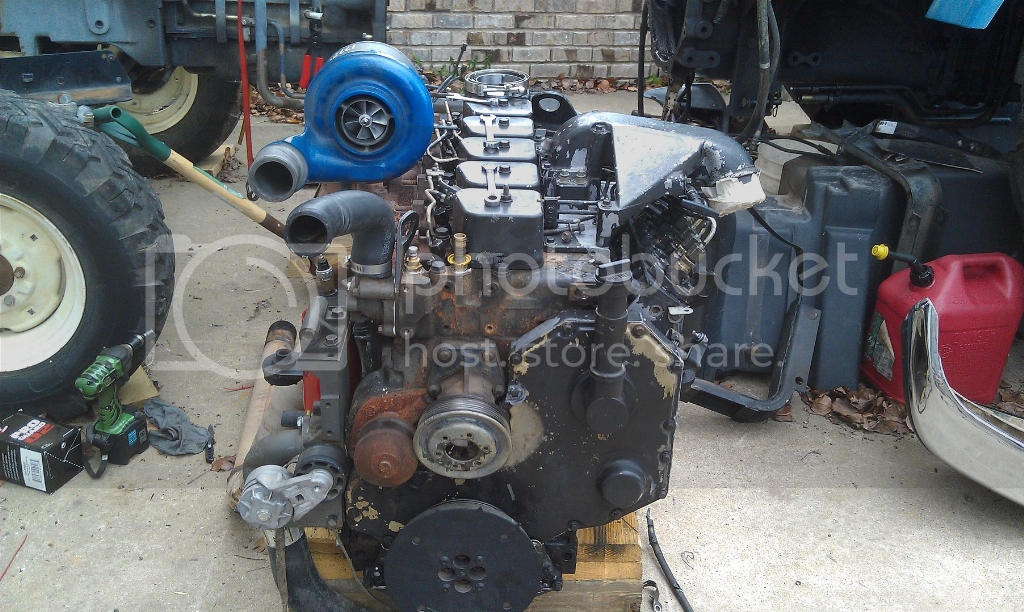

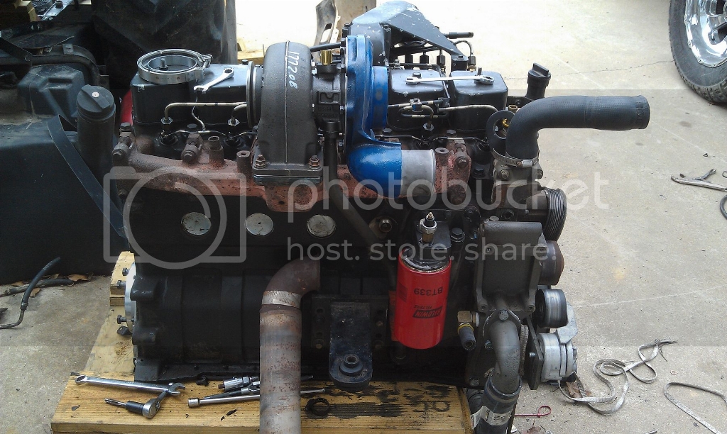

got a p-pump motor swapped in
The don't seem to very strong.I have one more motor swap left after the lastest pics you see of the p-pump motor its just a temporary.The A/C is a tractor setup I like the tractor setup better than the dodge BS.Single one wire 200amp Alt and clean as you see it.Lol Power steering i used the dodge pump and i got some cheesy Chit from ford cummins several years ago it just a compression fitting and splice the dodge to the for power steering lines together the only headache i had it the trans not working on the pressure switch setup i desgined but i still have some trans problems
However i have now had some evperience with the Suncoast stand alone unit in a 47/48RE and love it but not in the budget yet i have prior motor plans first.
