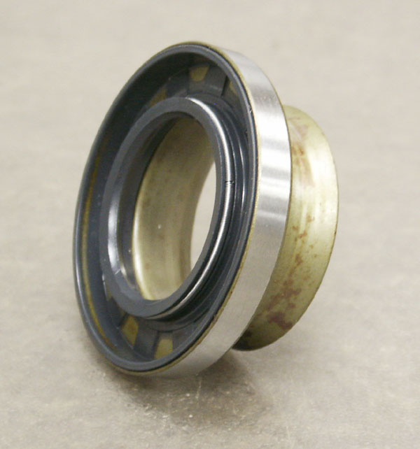

Zilla, if you haven't already, google 'obs ford inner axle seal' within a first few images are the new style seal and the old style. I believe all that should be in there is a one piece seal. That's all that was in mine when I changed them. I have read where the shafts will get enough wear in them that the old style seals will no longer seal out the oil. Perhaps that happened on yours? Hard to say.

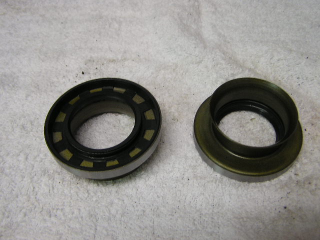

i'm pretty sure this is what is in there
zilla68
Jun 22, 2011
2,128
Moore Oklahoma
Oh, maybe. Can you get a pic of what you removed?
Sent from my SAMSUNG-SM-G890A using Tapatalk
you see the back side of the brass looking piece, the rubber seal, that pulled OFF of the brass looking piece (I think its just stamped metal colored gold)

popped the seals out, used an old floor jack handle I had and one of the snap on seal drivers, popped it right out, and that seal I pictured is the same seal that was in there.
